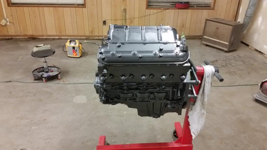

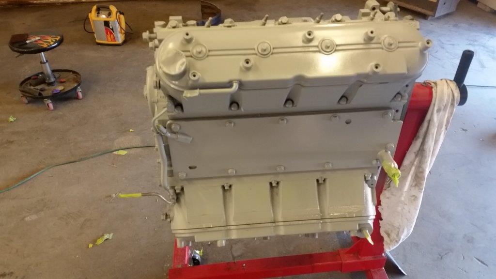

I finally received all the parts for the engine, installed the EPS cam, valve springs and push rods. I also finally picked out the colors, which allowed me to paint the engine.
On to the pics:

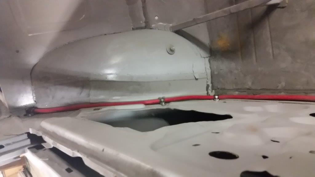

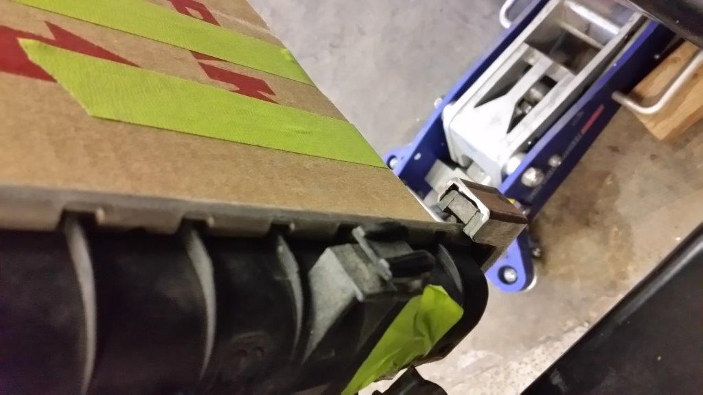

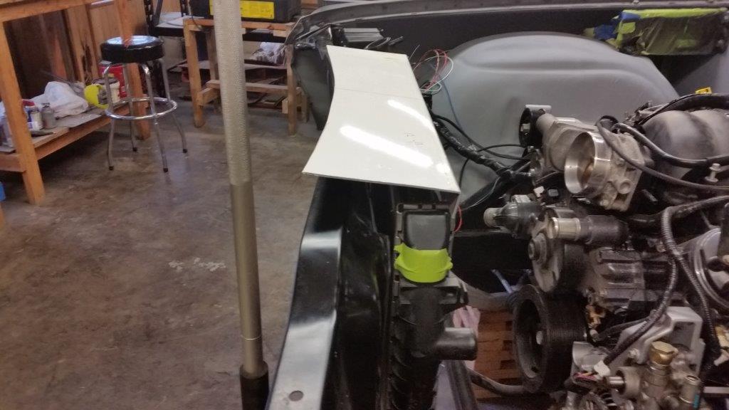

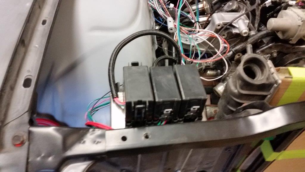

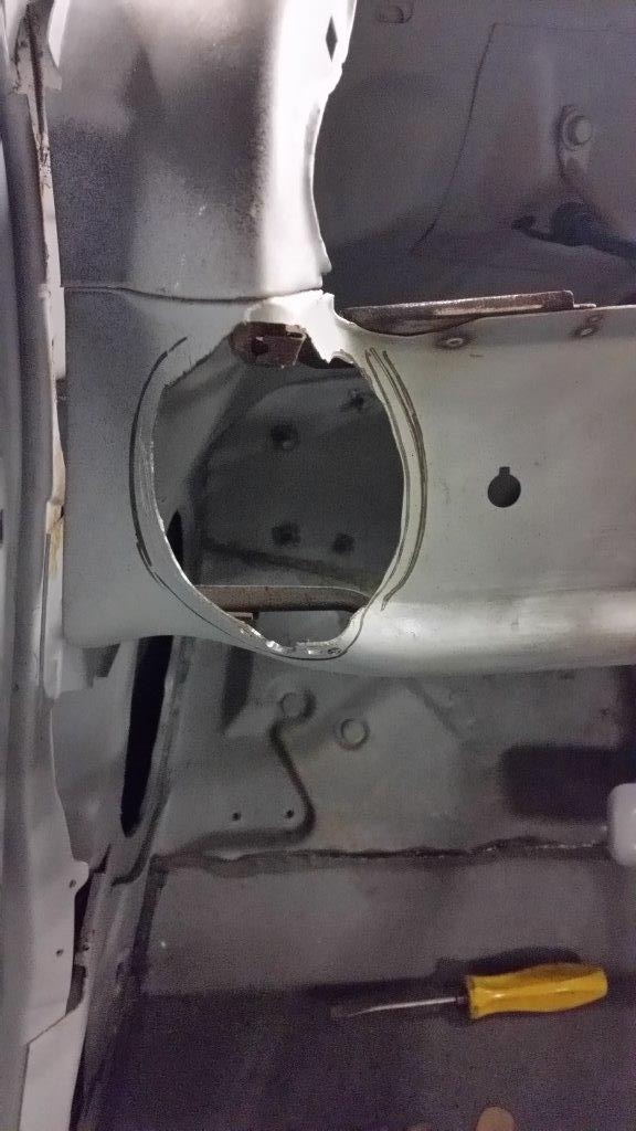

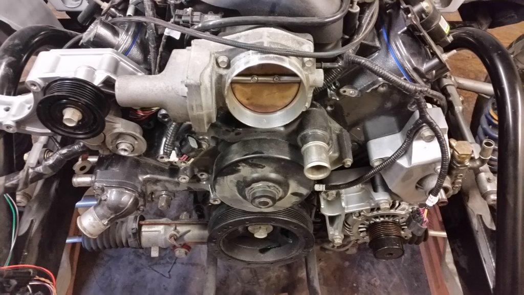

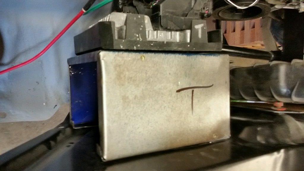

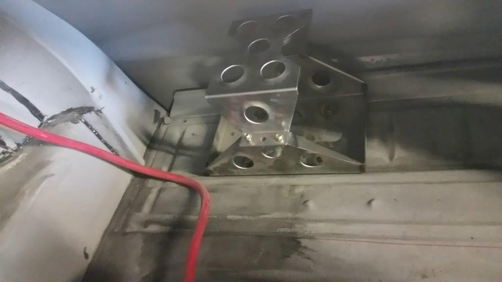

-Mocked up engine, made radiator mounts and a mount for the ECM. Because I used a re-worked stock harness my options were pretty limited on where to mount it.

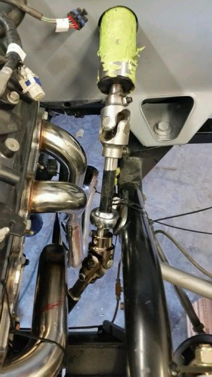

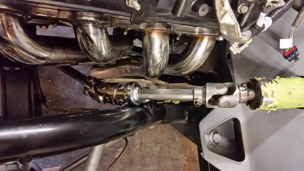

-Mocked up the steering shaft. Because of the angle, I had to use a third joint and a eye bearing to hold it. I really didn't want to grind of powder coating but, we were able to hit the hot metal with powder had it stick and finished the job with a heat gun.

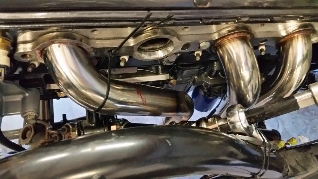

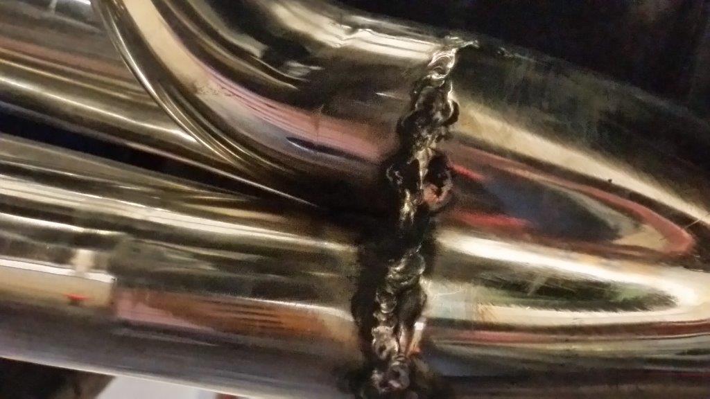

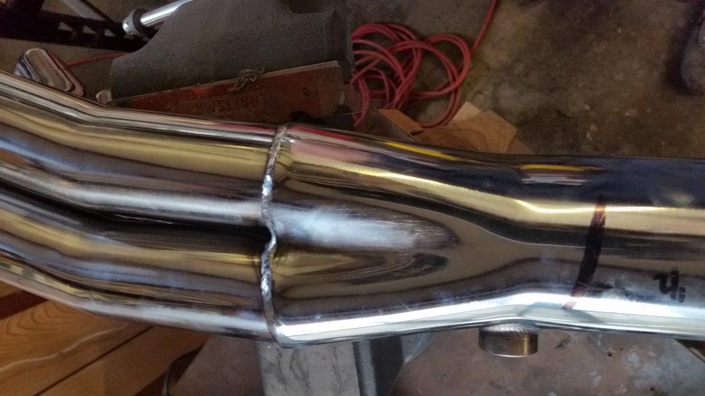

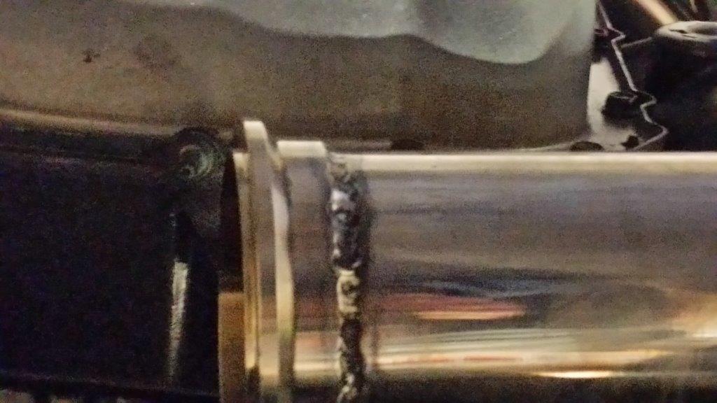

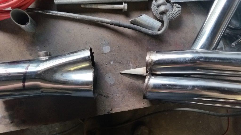

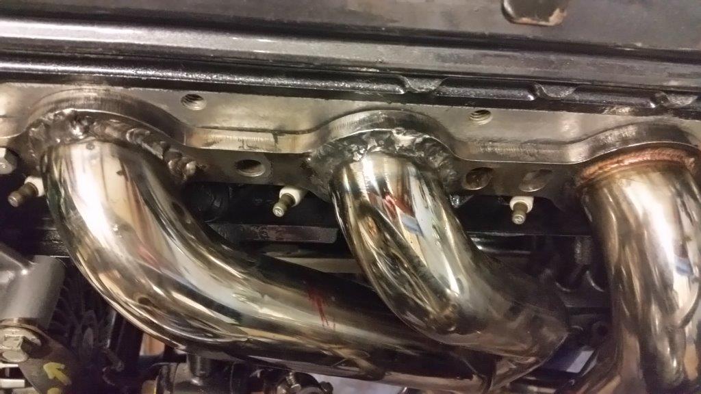

-Did major surgery on a set of speed engineering headers to get them to fit around the steering shaft. I've only TIG welded a few times but, pretty happy with the welds for the V bands on the outlets. The welds on the tubes are kind of ugly but, they will hold. Polishing them up gets rid of some of the ugliness.

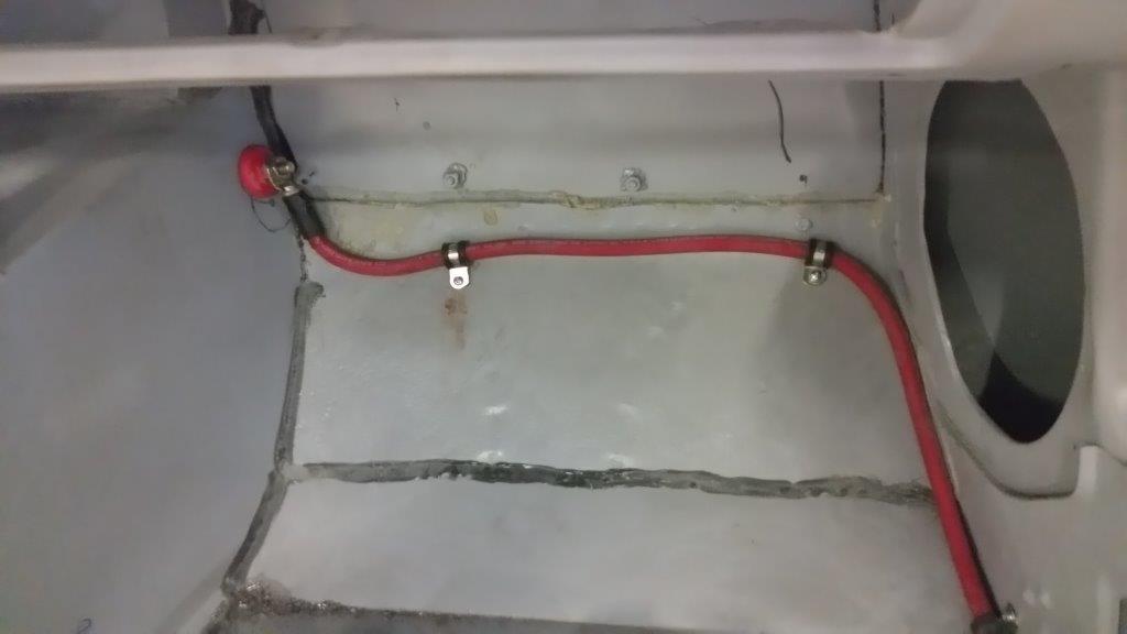

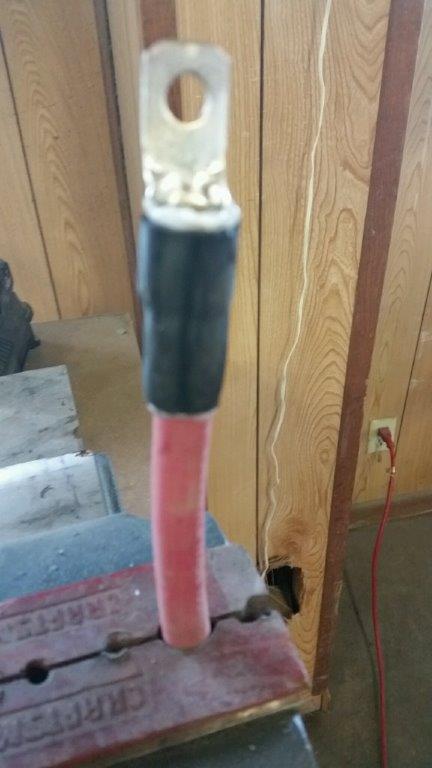

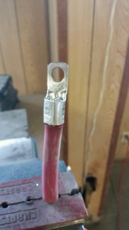

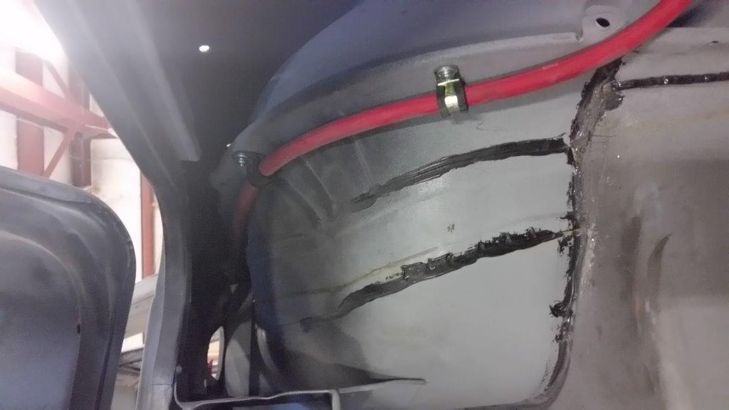

-Ran my starter power cable and installed the battery box. I used P clamps along it and before I go final I will use some braided wire loom to make sure it doesn't chafe anywhere. I plan on using a Mad electrical solenoid but, have to wait until my allowance builds up.

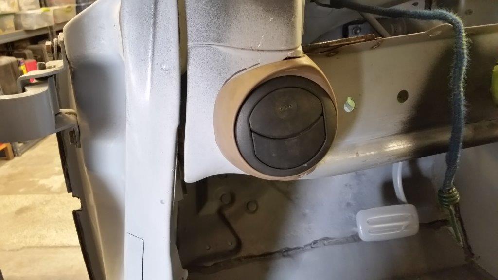

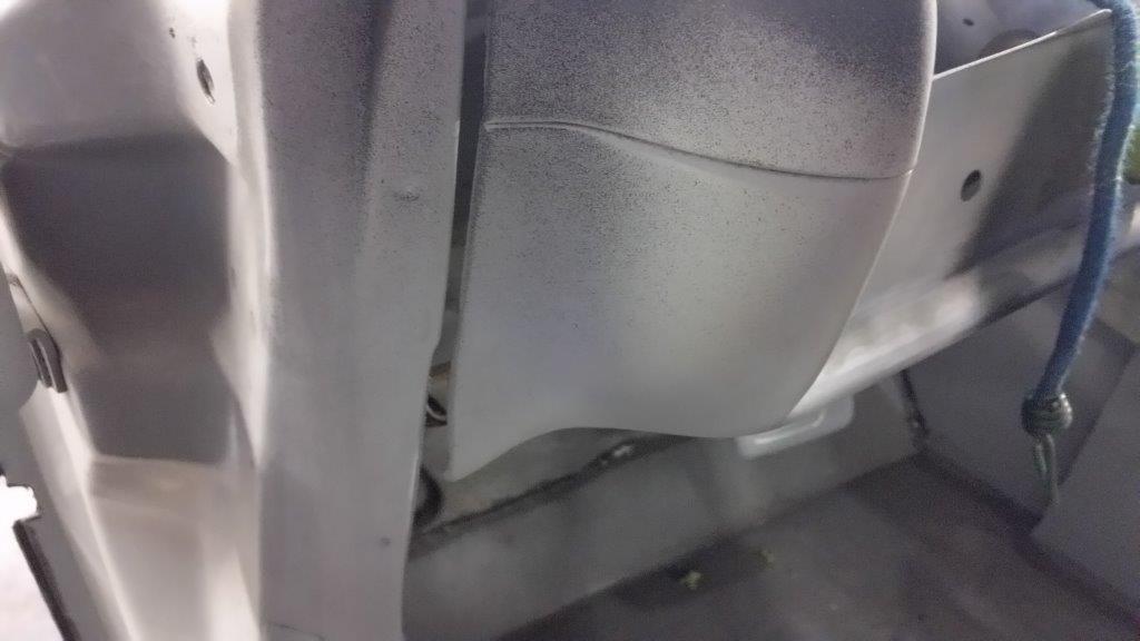

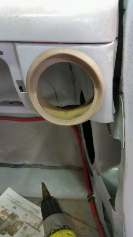

-Cut holes in the ends of the dash for the vents. I ended up using parts of a dash cut out from another car, glad I did as they are a really difficult template to get it to fit correctly.

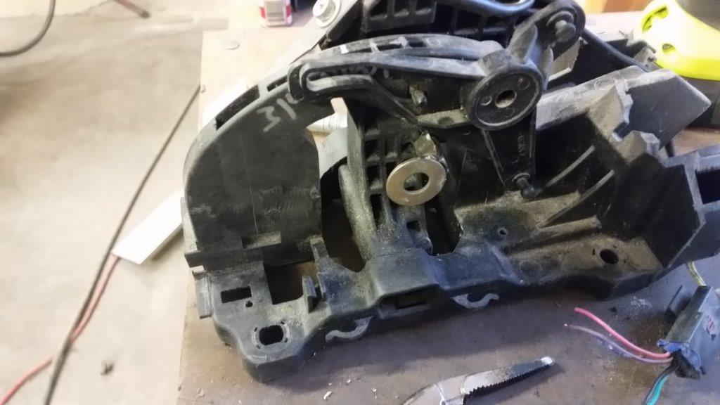

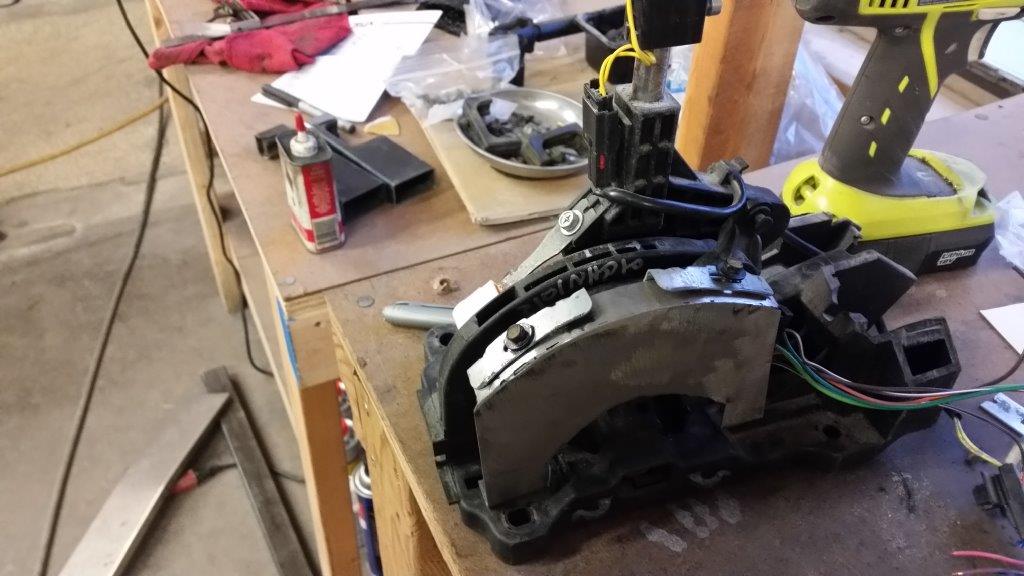

-Made a neutral safety/back up light switch for my Malibu shifter. I've been wracking my brain on how to do this because the 6L80E doesn't use a switch instead it goes thru the BCM. I ended up using a F body switch and modified the shifter to make it fit.
-Lastly, a few other odds and ends like finishing fitting the body mounts and a lot more sanding.
Glad I have some help from friends with this. Spatial things like figuring out how to re-work the headers makes my head hurt.

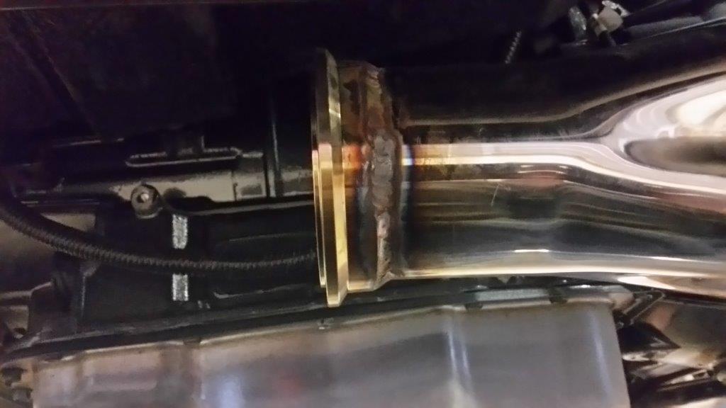

I've made a little progress since the last update. For this one, I finally received all of the parts to finish up the accessory drive, installed the top cover for the radiator, mounted the fans, mocked up the AC lines and have just about finished the exhaust. Just a little bit to finish up on the exhaust but, the big pieces are finished.
One of the challenges I had was finding an adapter to connect the LS pressure switch to the AC lines using an EZ clip fitting. They make pressure switch adapters but, most don't have the right threads. I purchased a weld on adapter and TIG welded it to a pressure port EZ clip fitting.
Next step should be paint unless anyone else has some other suggestions.
