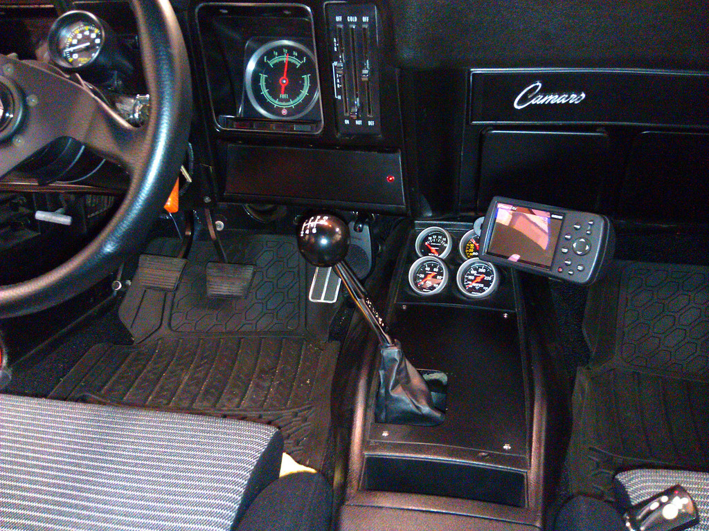

This is an old Comp. Plus shifter handle I plan to use. The bolts are just for mockup but I think it will work fine.
Here it is with a copy of the stock shifter plate and a wider opening for the 6-speed. It has the stock boot to seal the weather and will have a decorative boot to fill the hole.

Looks good. Do you have the specs on that stick? Approximate length and angle would be helpful. Or if you know the part # I could figure it out.
I have enjoyed following your build, you are doing some awesome work there.
Edit: From the looks its a 4106, 10" tall, 5.5" raked back, 1.3" angled inward. Sound about right?
