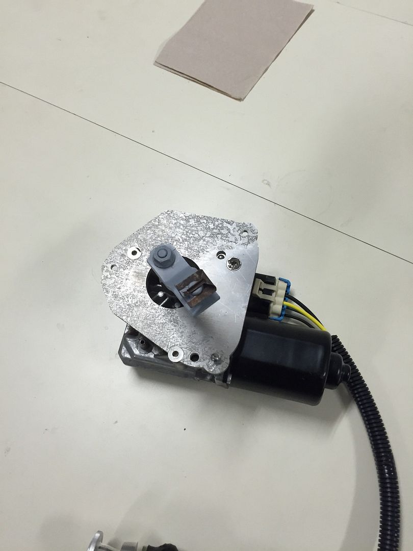

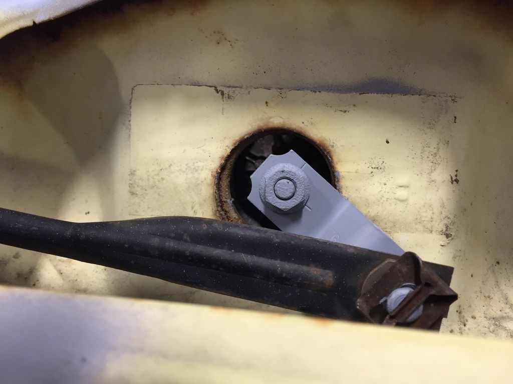

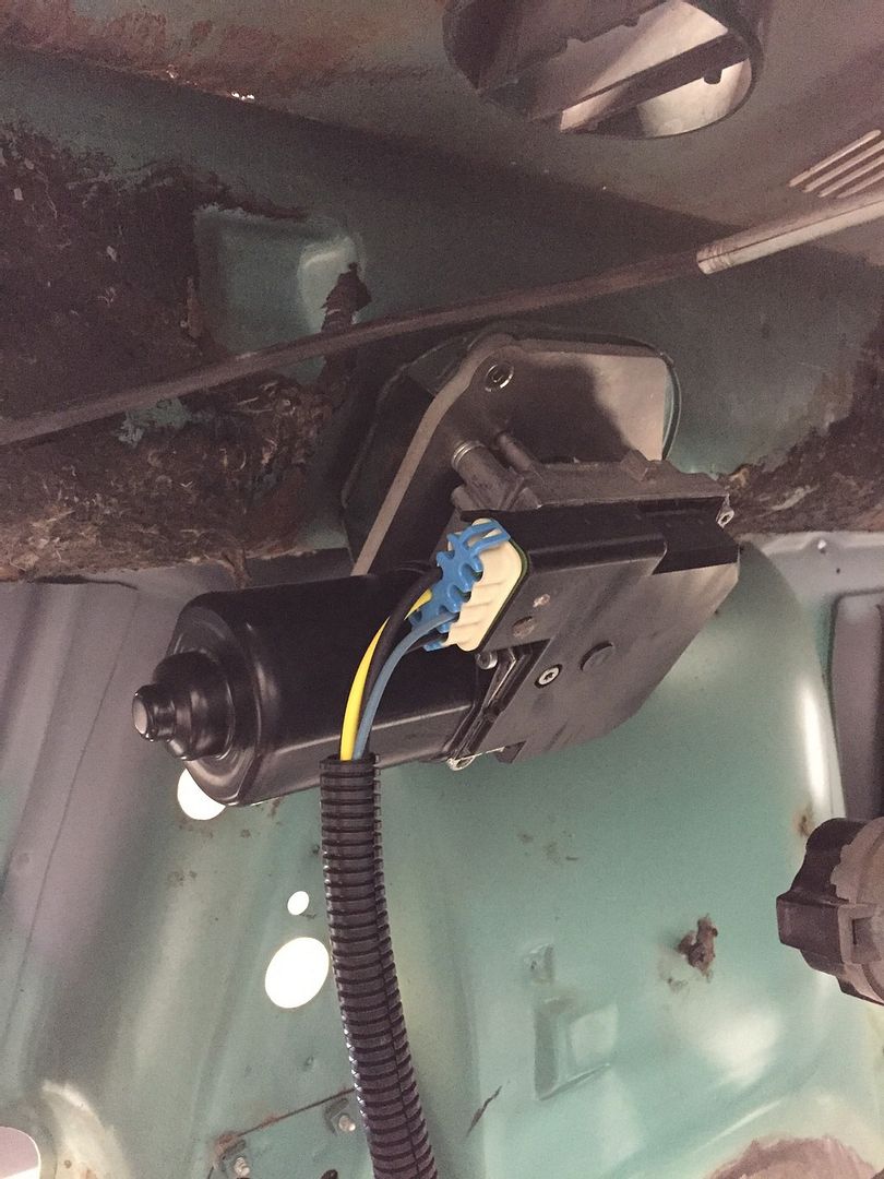

I guess there is more than one way to skin a Cat.
Nice job by the way looks great.
Here are a couple of shots of the install I did. No cowl mods just made a new wiper mounting plate. Also shaft extension in order to use the original 67 crank arm witch can be clocked.
Just have to make a seal plate to go around the shaft.
