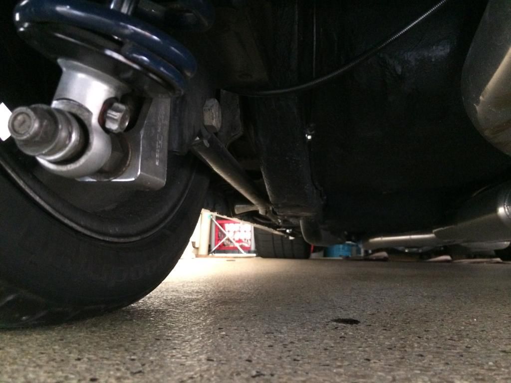

So Ridetech had me move the rear blocks up like you have pictured MtotheIKEo. Mine was like what Jay posted in his pic and that's also how the instructions show to install them. This definitely will gain move the body up by about an inch.
They have also bumped the front up to 650 lb springs. I've got a few other things going on so I won't be able to tell what kind of difference anything has made for a little while.
I also noticed a 2 of the bolts for the 4 link have loosened. The same two on each side as a matter of fact. They go through the thin sheet metal frame rail. It is not welded, but I may have to look into that if I can't figure another way to keep them tight.

Despite the crappy weather....I was able to put the car back down and take a very short ride...the car is sitting much better now. The revised rate of the front springs and moving the blocks up have raised the car a bit to where I think will be good for the driving I do. I can't tell what has changed in the ride quality just yet, but will hopefully get to after getting the stance finalized and an alignment.
