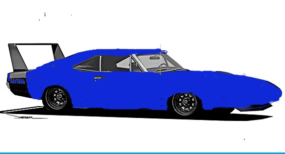

Do you have a rendering of what you want the outcome to look like?

Here is my rendering i colored and choices of wheels at this point

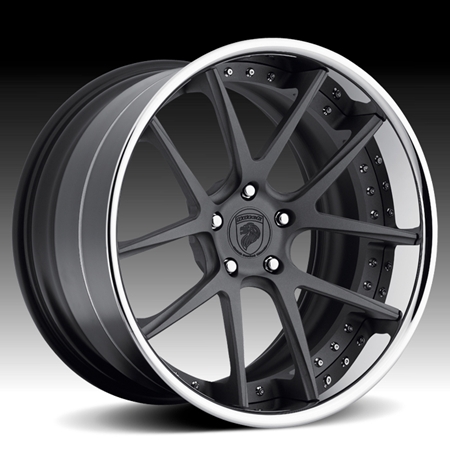

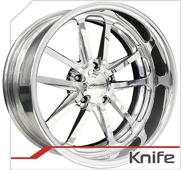

leaning towards Budnick Wheels or Neutek wheels

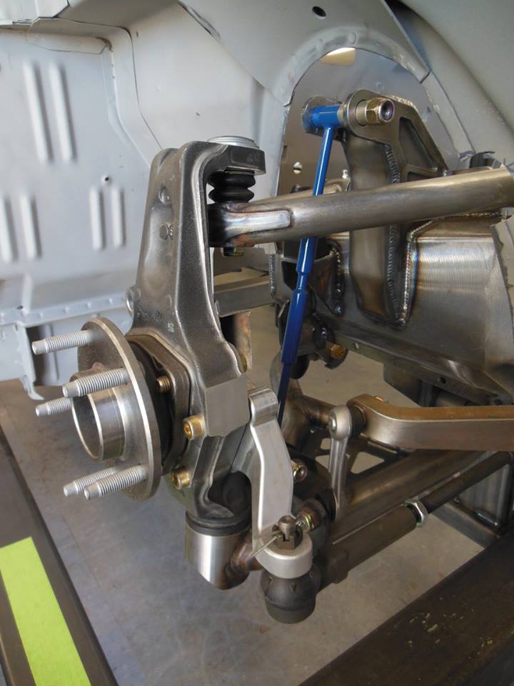

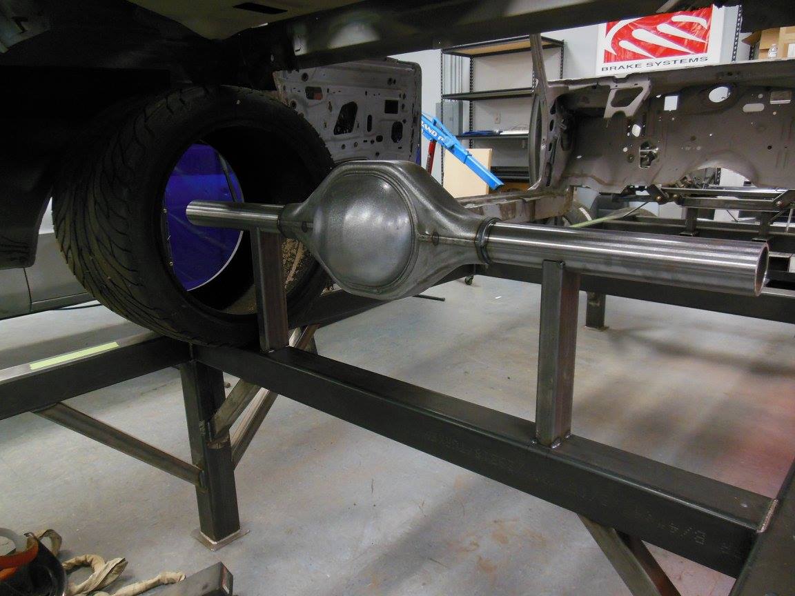

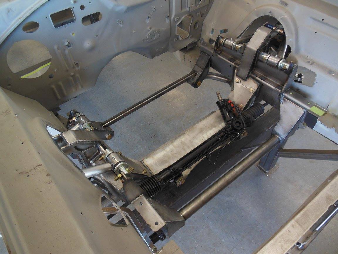

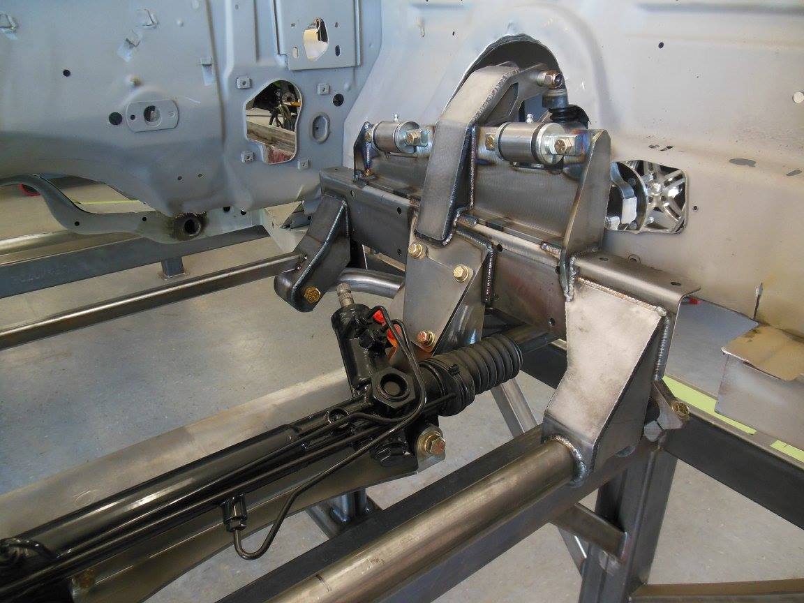

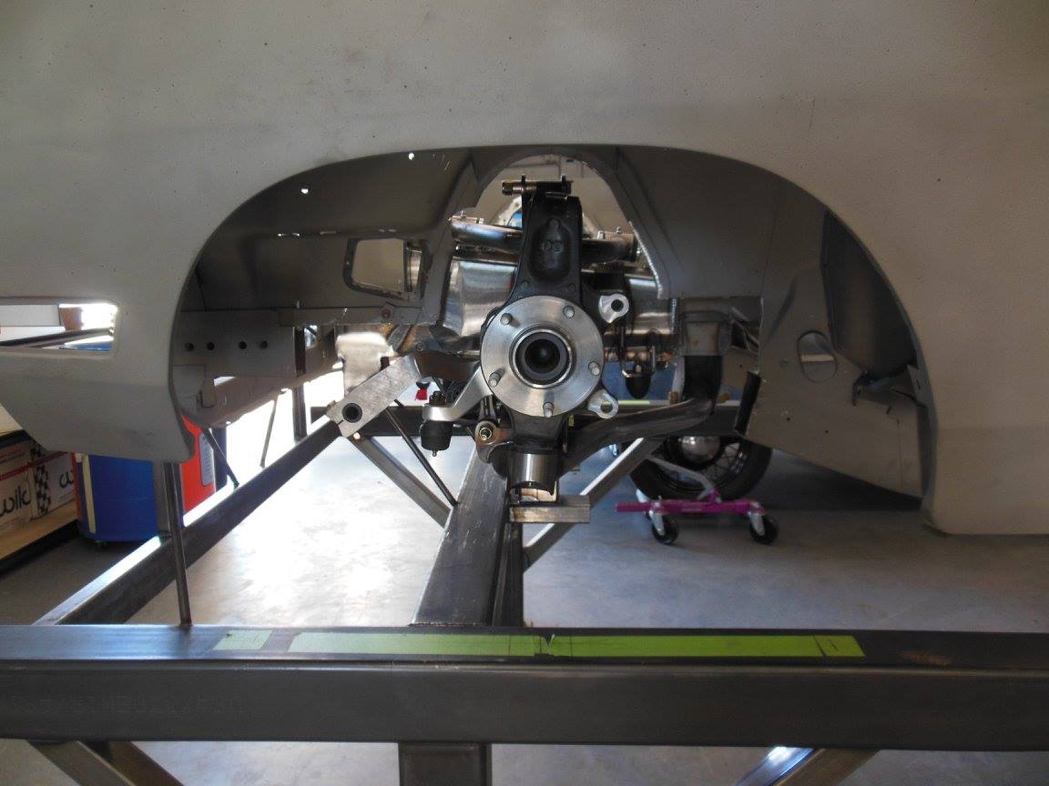

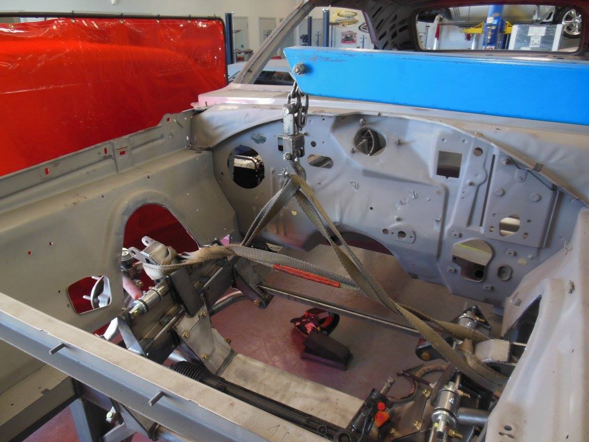

Next up is getting ride height set with setting the front suspension and rear end in place by welding them to the rack in the desired ride height Dan cut out every bit of sheet metal that would be in the way of the new frame.
Dan then Cuts off the spot welds on the passenger side quarter and takes the quarter off.

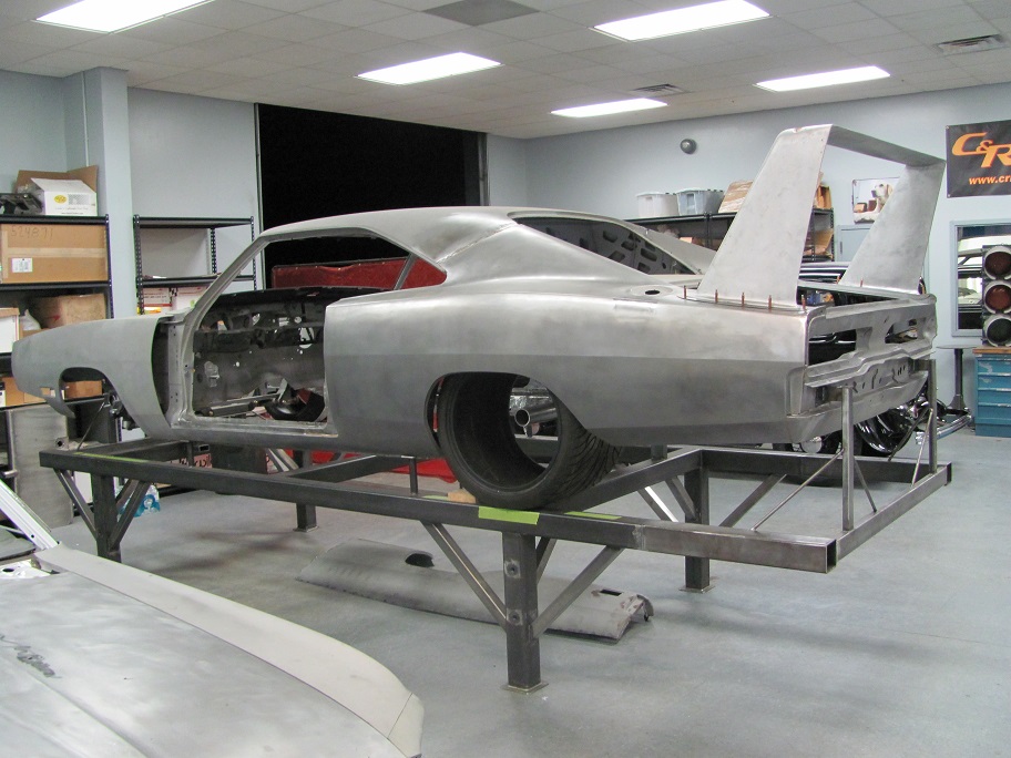

Default 69 Daytona by Holohans Hot Rod Shop
Looking like an Aero Warrior now
Look at those Meats
