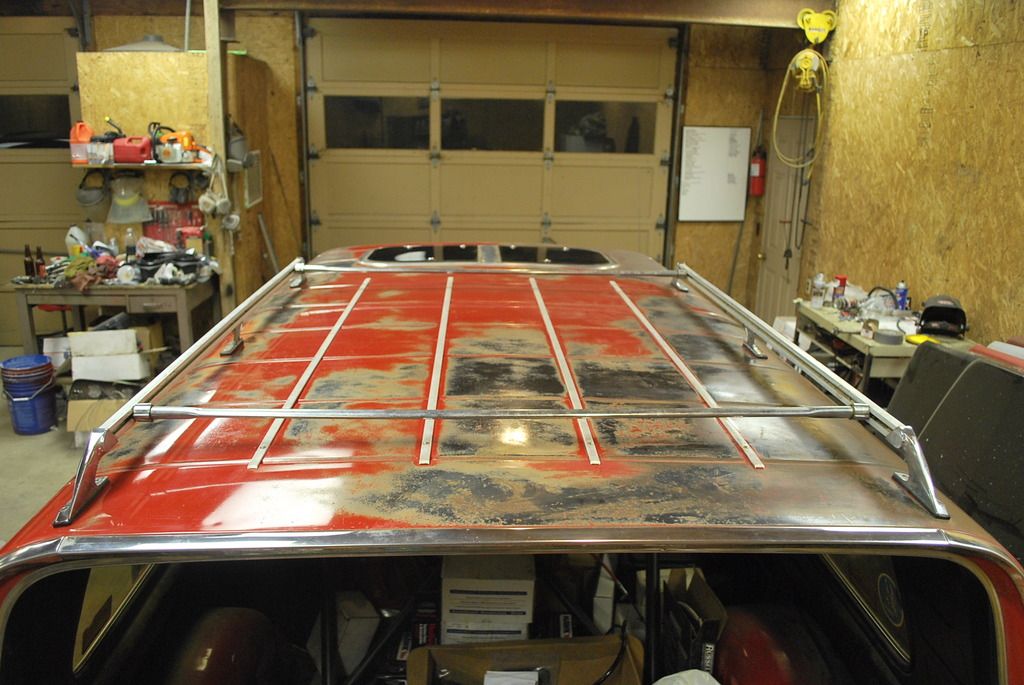

Pieced together a roof rack and rub strip set today and got those on. Polished up what's left of the paint on the roof. Patina for days.

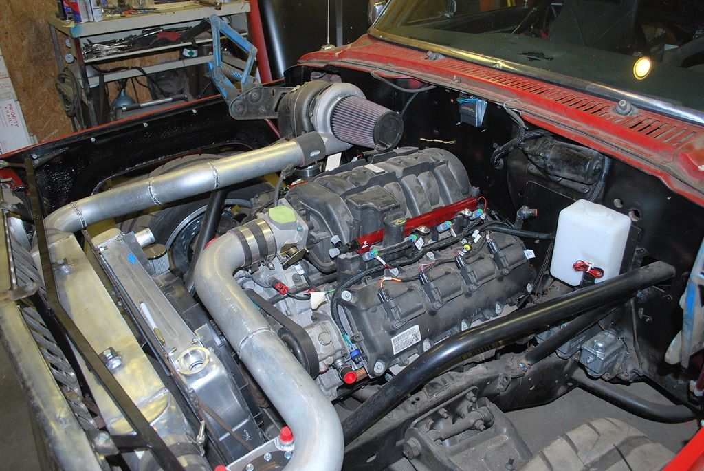

Got most of the underhood wiring done. Looks a ton better without bundles of wire everywhere. And I finally broke down and bought the Aeromotive fuel rails. The factory setup just seemed really janky deadheading into one rail and piggybacking the other off of it.

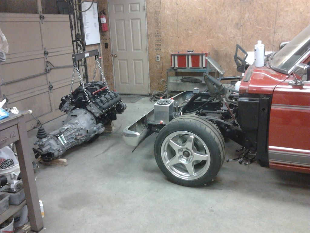

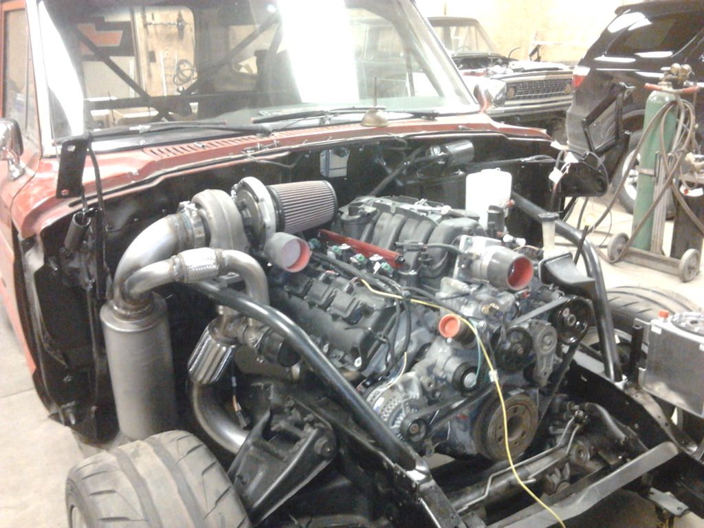

Pretty much everything I've been doing is small stuff lately so I haven't had the need to update. Pulled the engine/trans a lot of times to take care of all kinds of minor details. Cleaned up and painted a lot of stuff, etc. I got the wastegate piping finished so that's a plus. I also got the cage for the fuel cell welded up, you can see it in the first picture. I'll update with more pictures when it's finished. I'm going to make it work with the factory fuel fill.

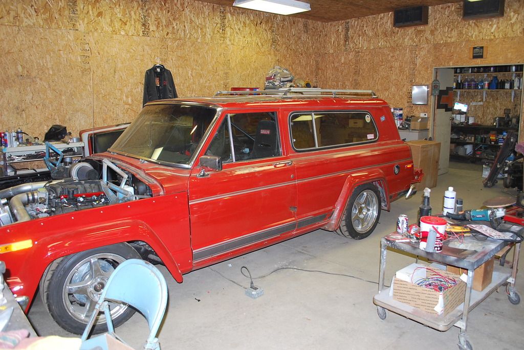

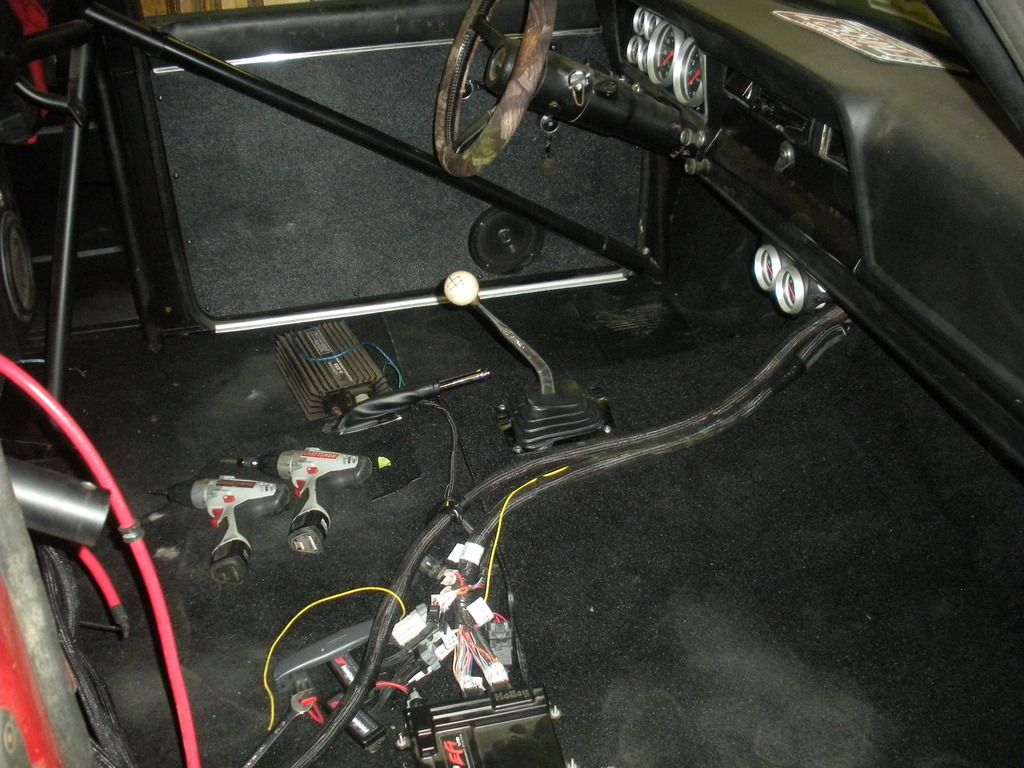

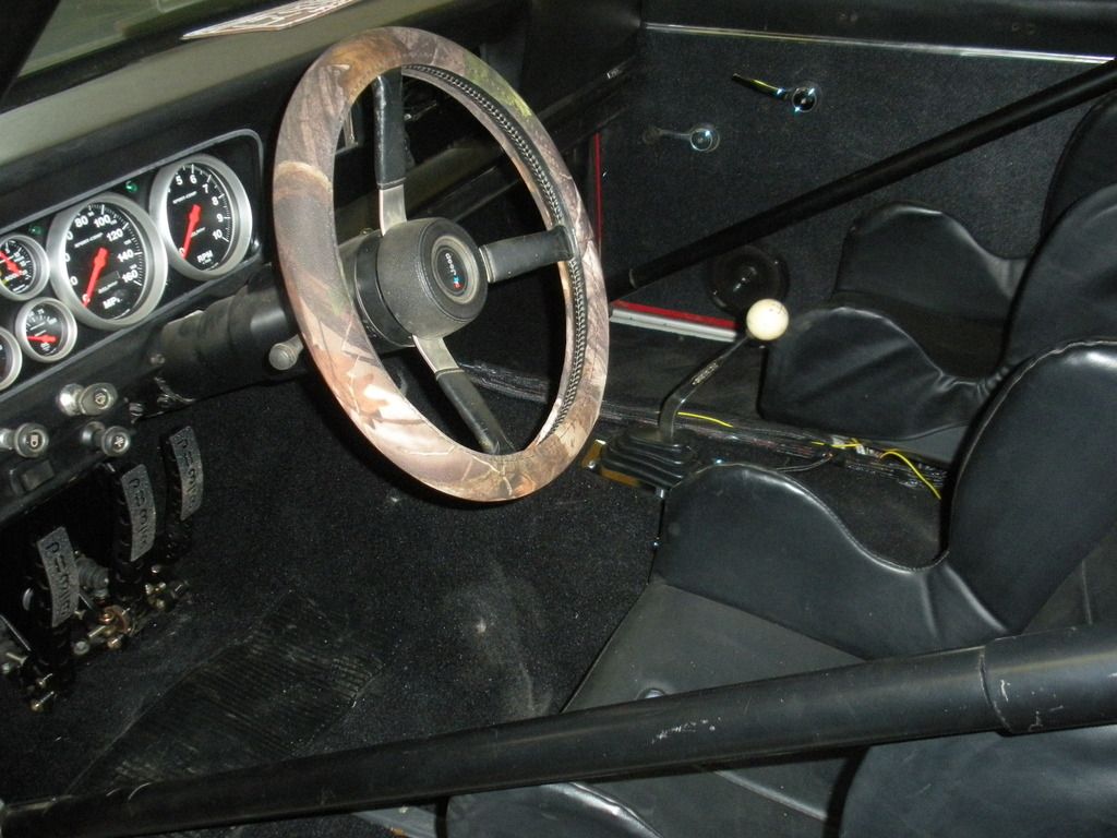

Been a bit of a struggle working one handed but I managed to get the carpet and interior in. Also touched up a few things under the hood. Getting somewhere for a change.

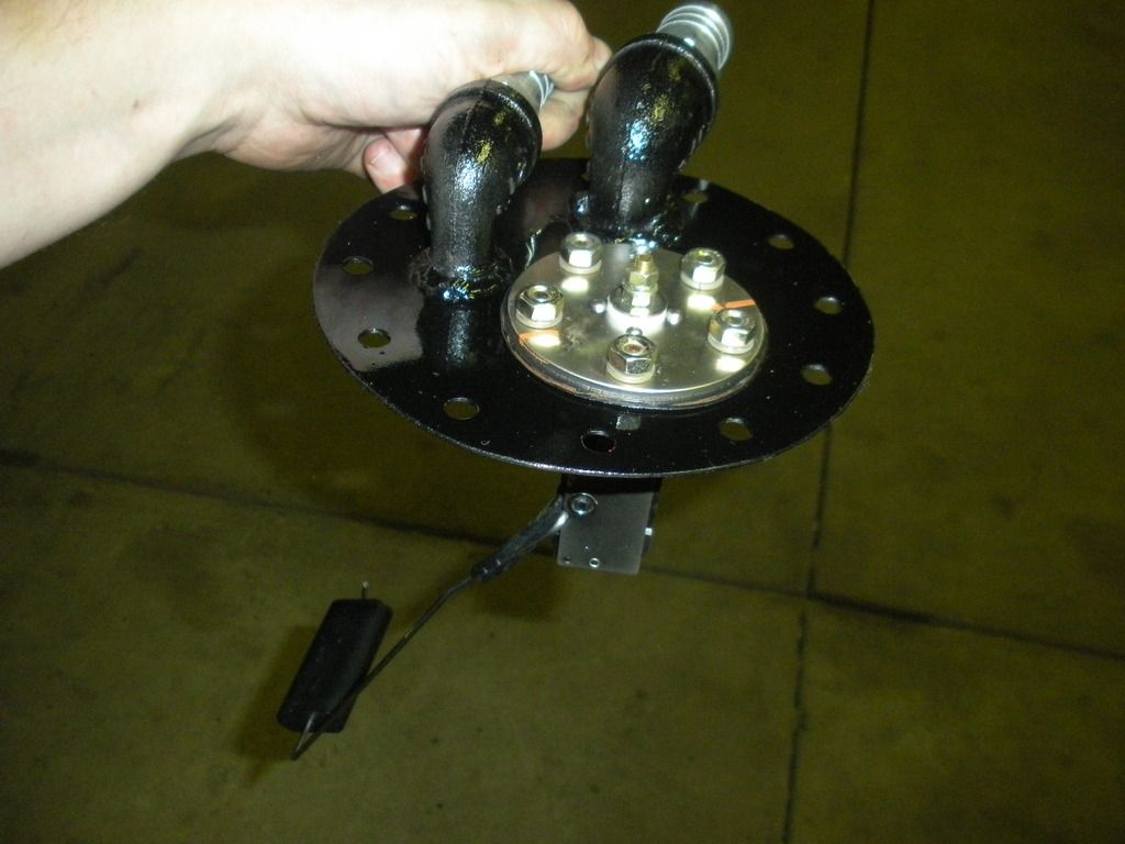

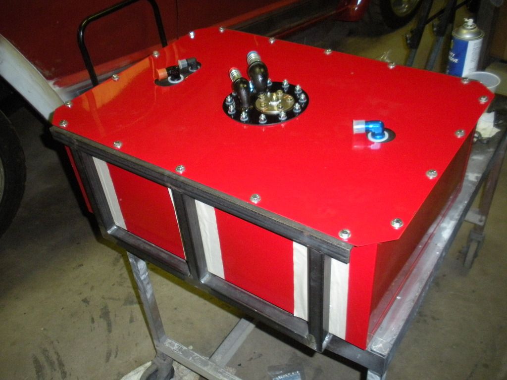

Been working on a bunch of stuff but the fuel tank is really the only one with visible progress.

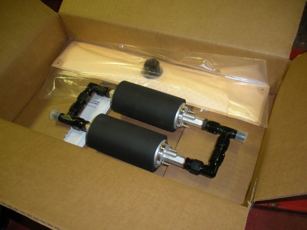

Bought Holley Hydramat, shouldn't have any issues sucking air. Also figured out the fittings for my dual Walbro 255s.
[img]http://i30.photobucket.com/albums/c324/ghinmi/1983%20Cherokee/DSCN8244_zp****9hr42.jpg[/img]
Made a plate with barbs to hook up to the stock fuel filler and a fuel level sender.
Cage complete minus mounts and paint. Also added a return line fitting to the tank.

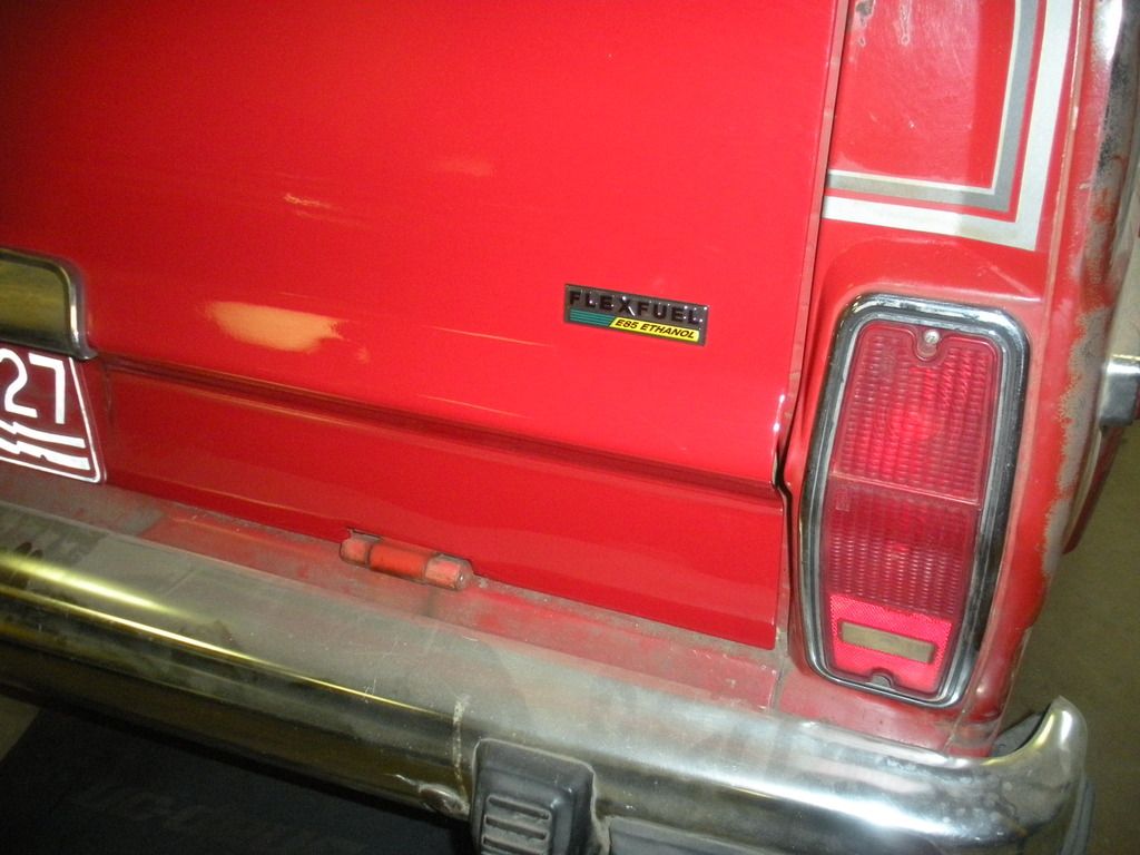

Also, Holley finally released flex fuel capability with the V4 update so I got a sensor and a badge.
