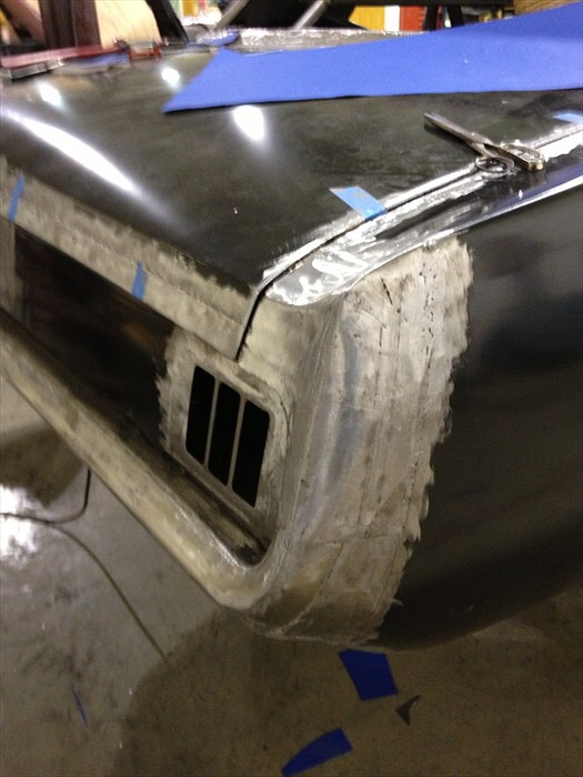

Need more power. If only I had known how many headaches this had in store for me...............
Finishing the smoothing
Through the deck lid gas fill
Let's just cut the hood to fit around the supercharger
Body back off to head to paint prison

Patiently waiting for the rest....In the mean time, what's going on at the back of the car in the picture? I see the bumpers been molded into the body, is the trunk extended and the taillight panel recessed?

It was an unexpected by product. Once the bumper and all was welded and molded in, the tail light pan appears recessed but I think we actually left it in the factory position. We added some metal to the trunk lid lip. I'd honestly have to have it next to a factory one to point out all the differences. Would make for a good "Hocus Pocus" in the newspaper, if you remember that strip. Lol
