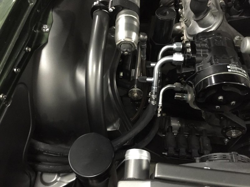

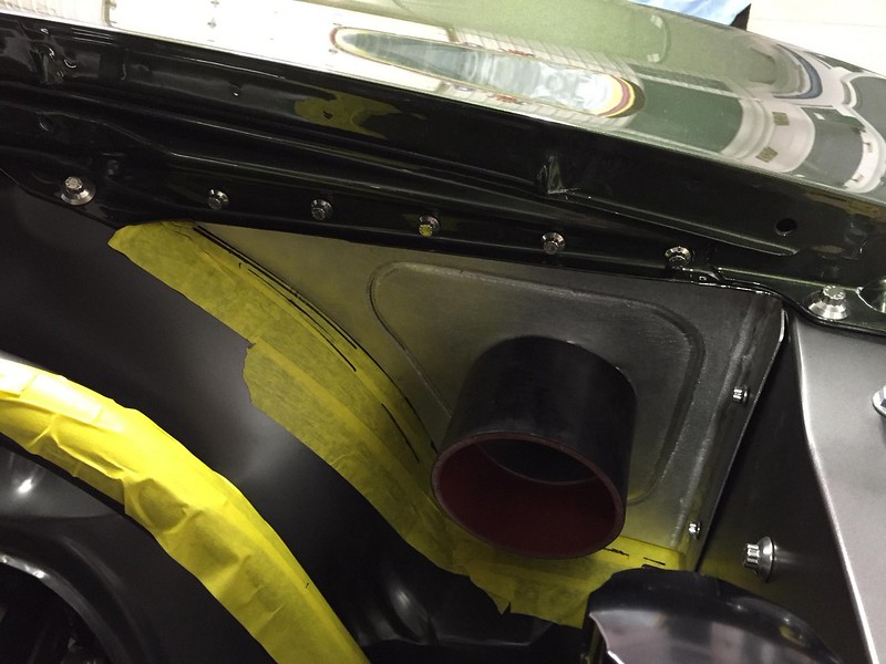

Door Hinges, Front Sheet Metal, Hood Hinges, Fender Braces and the Trunk Hinges.
I plan to run 12pt stainless in all those places. I'll see if I can find a picture. Pretty sure you all get the idea now though.
These are from Chris Kinkers 69. Good example of the look I'm going for.
Curtis
