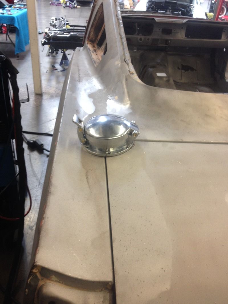

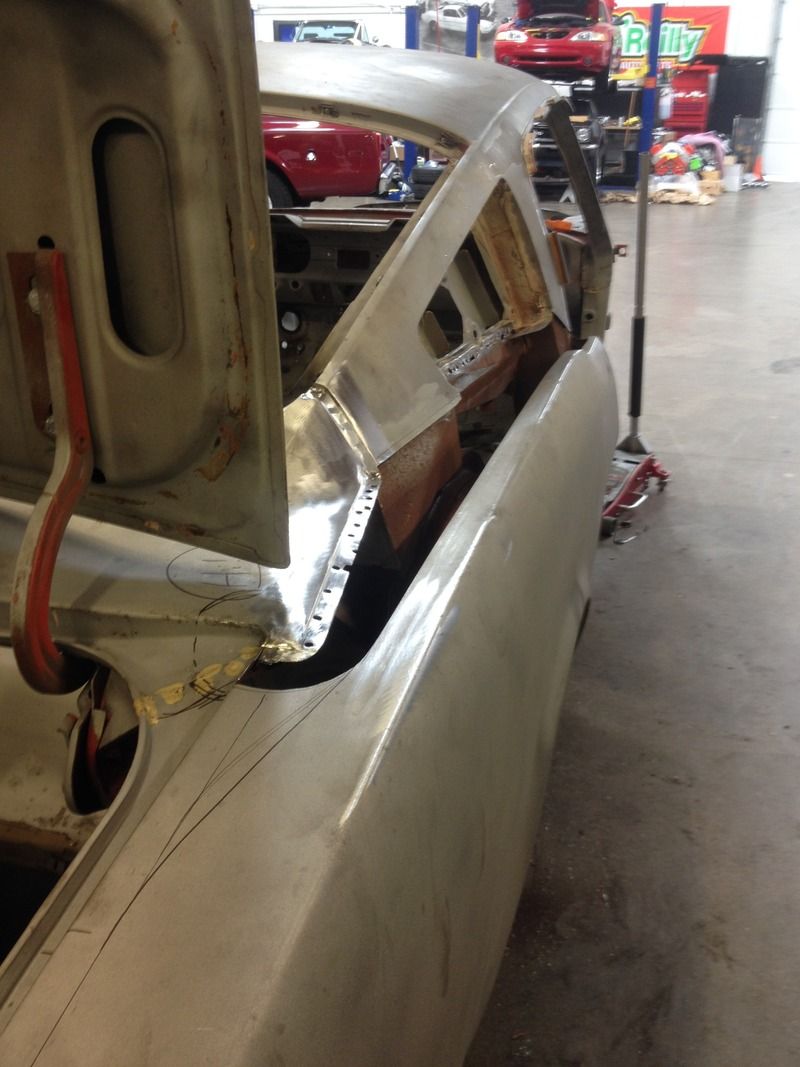

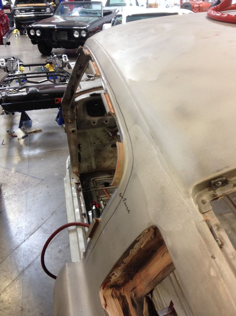

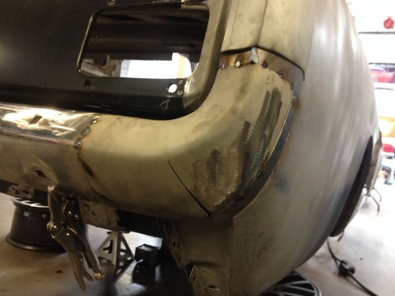

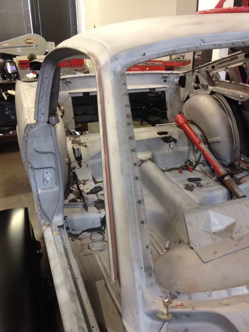

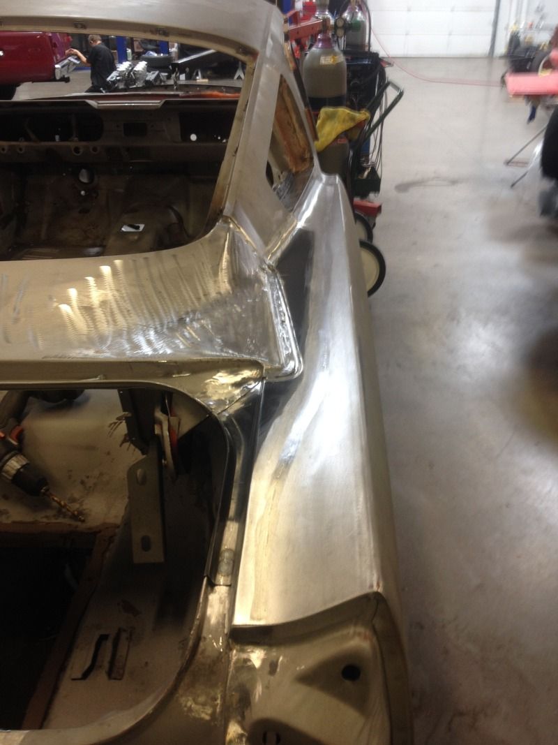

Getting the quarter repair fixed correctly. Cut out the overlap section and metal finished a piece in place. started filling the fuel cap on the new rear panel and found a new home for the fuel cap

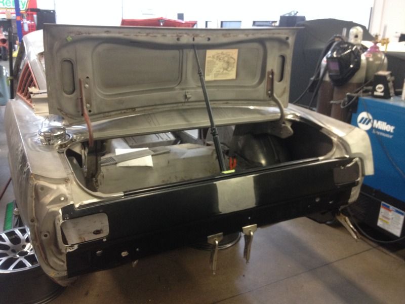

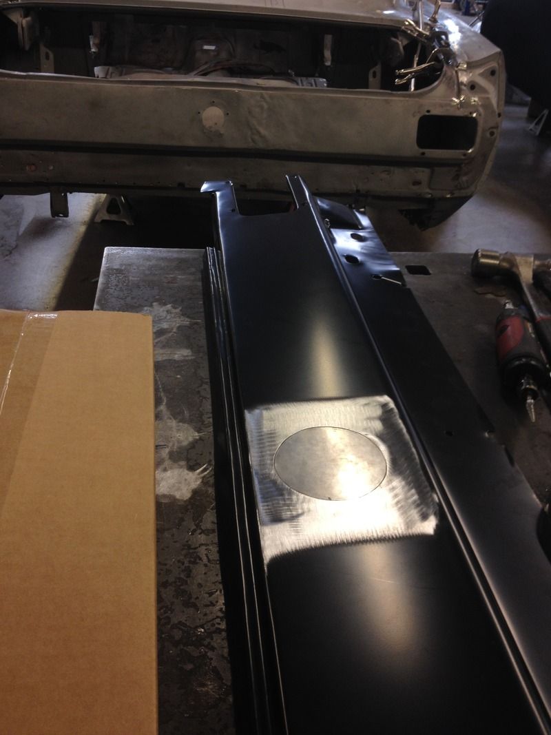

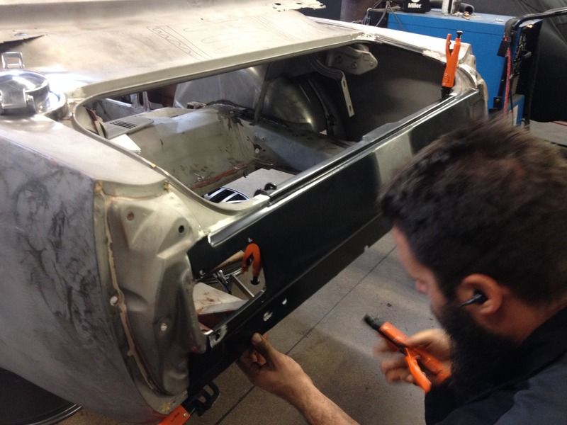

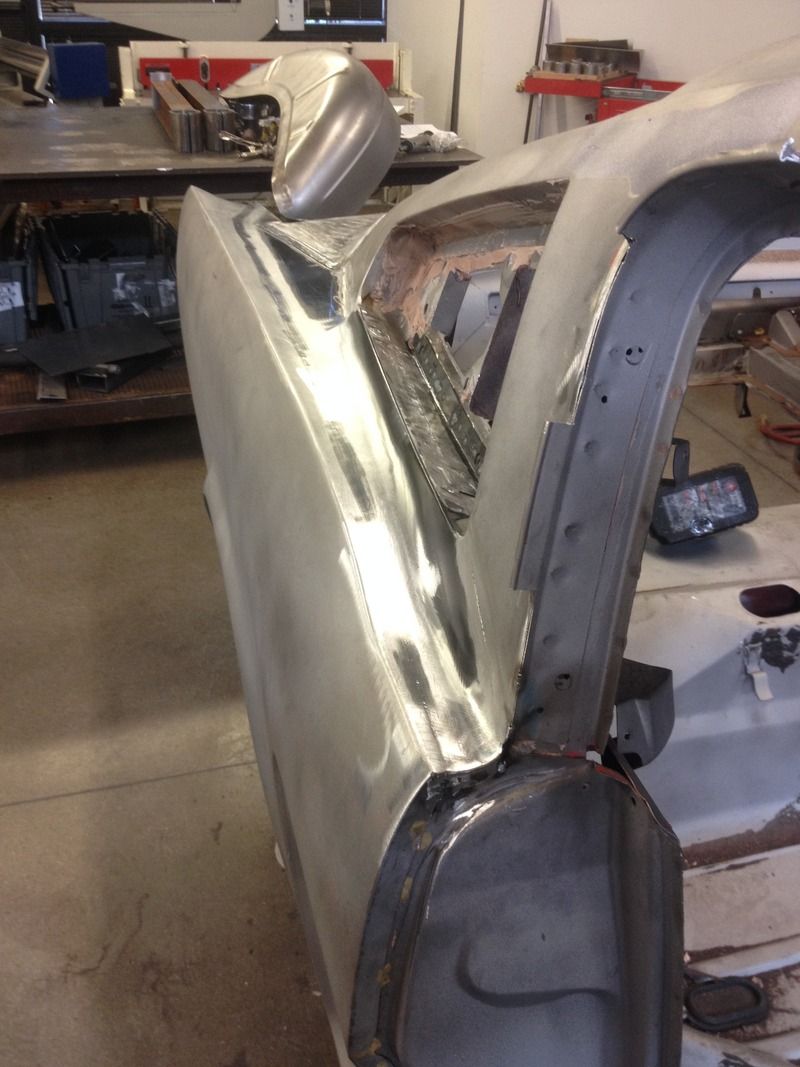

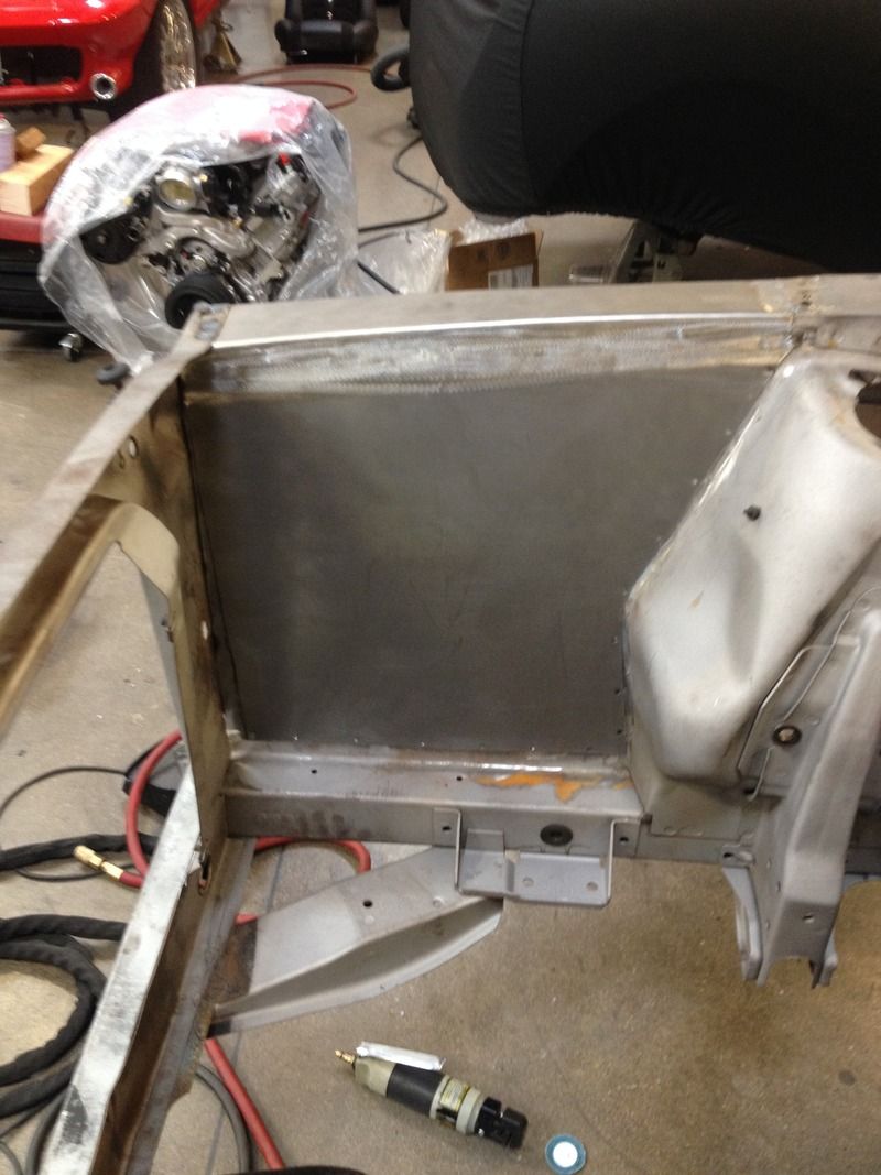

Got the Drip rails shaved, replaced the tail light panel and removed the battery tray pocket. working on getting the engine bay ready for the Mock up RY45

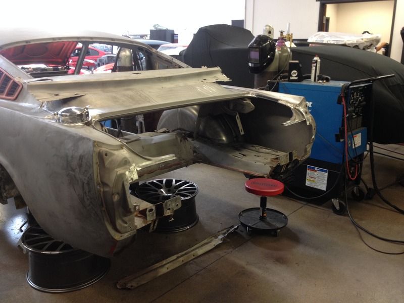

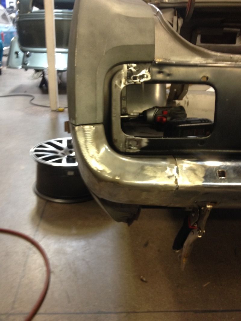

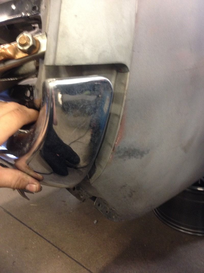

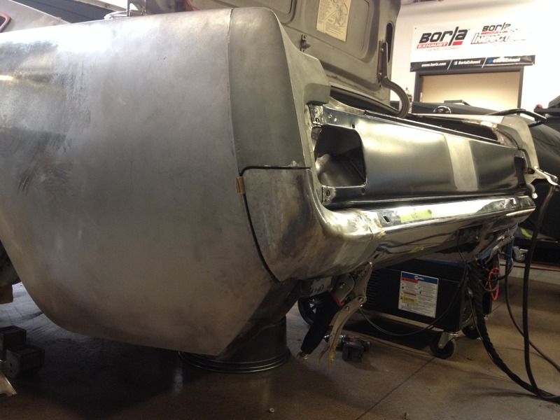

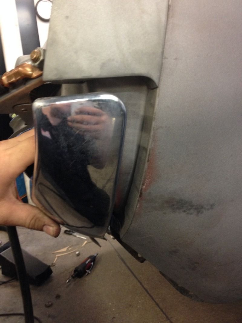

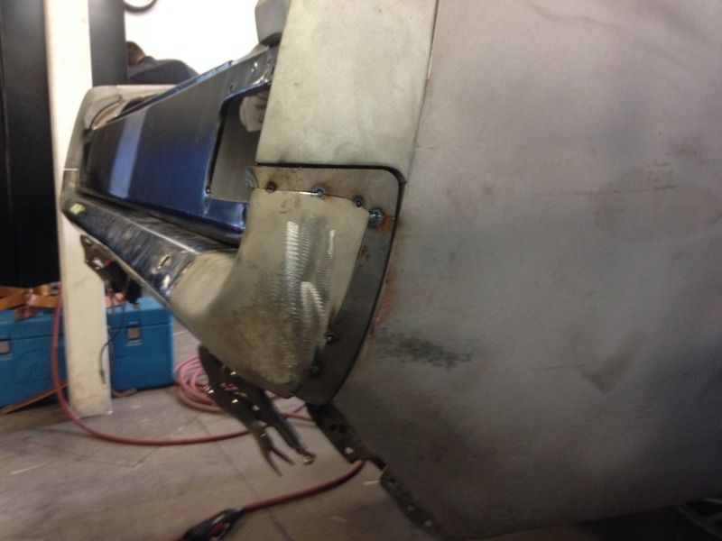

Staring to fit rear bumper
