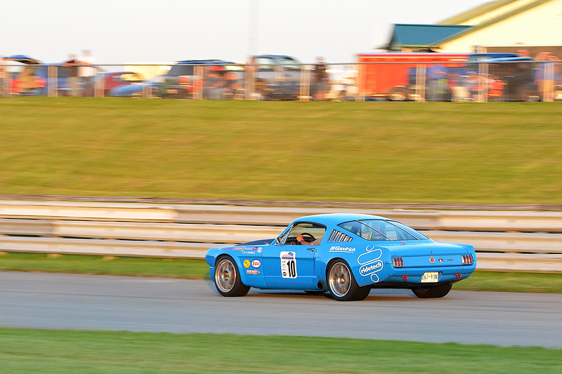

So finally here is a picture:
That air hose is fresh air from the cowl, and for some reason there is absolutely no positive pressure at the cowl I get no air flow whatsoever through that. Oh that's right I also built air ducts into the removeable cowl panel for the heater box and fresh air.
I also built some louvers for the he sides of the fenders to release heat. I could have welded them in directly but the method I used disturbed the bodywork much less, and I like how it came out and let me use aluminum for the louvers. I copied the design from a thread I saw on Lat-g, some pro in Australia who was posting up some cool things at one point.
You can see I also opted to build some hood louvers to cover the big vent. I kind of like the "open vent" look but because I had 2 ducts I had a divider in there anyway, so once I started I just louvered teh whole thing. It actually looks a bit too aggressive for what I'm going for but it came out well and it has been growing on me. As usual I don't have any pictures of fabrication or assembly !
I didn't want to post this photo because it makes the louvers look totally obnoxious. In real life they are much flatter like 50 degrees and not vertical looking at all, something with the light this photo does NOT do them justice at all but since I had it I will post it, they flow much much better in real life.

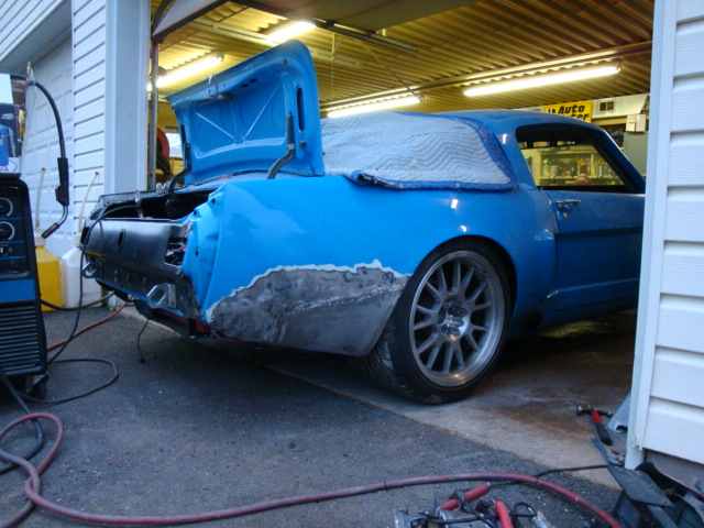

I love this view, but note the rear behind the wheels. I've learned recently about how much car designers try to angle the rear side view upwards and "bob" the back of the car to create a better profile, and I do notice sometimes how the rear has a bit of a full diaper look to it. My goal at the time was to have the sheet metal match the actual angle of the diffuser. I care less about that now but I have also read that while on paper diffuser angles > 7 deg don't work and stall the air, actual race car experimentaion has shown that steeper angles are actually quite effective due to vortices or something, especially on higher ride heigh vehciles. if you look at a stock Mustang, the rear quater actually starts 1-2" higher than mine and then angles much more sharply at the valence. So I am thinking of rebuilding the lower quarter with an OEM style angle and using a stock valence as my starting point (obviouslh has to be widened and massaged).
What do you guys think ? leave it alone or what ? Starting back with a stock valence would also allow me to continue pursuing the "looks stock" vintage theme, and it would actually look more badass revealing more of the big tires.

Here is my crappy photo of my car:

I love the car and think it looks really, really good. I may not have noticed it....but since you brought it up and used some mad photo editing skills to show the change, I do think it would look better with the changes on the back.

Huh. I agree with DBasher, I might not have noticed it as much before, but the last picture with quarters matching back up to the bumper looks much more trim and a little more lean. I like it!

Its funny, the more I look at the first photo (ie the current car) the more it has grown on me actually. It gives visual weight to the back of the car and gives it more "rake", like a pointed missile. I will still probably tweak it though because that's what I do.
The rear wheelhouses were designed to accept a 20" 335/345/355 size wheel and the chassis can be adjusted to keep the same ride height and I think it would be absolutely boss to have even bigger meats on the back.. I desperately need new tires in the Spring but I just can't see springing for new rear wheels and gears for the sake of vanity. I'd like to say I"m growing up but really I just would rather spend that money on mountain bikes.

But seriously I like the look of the tapered up rear too. Really would bring that part of the car all together. So start cutting.

I added to the bottom of quarters on my Mustang also, I do think it helps the lines on the car. We are just plastic surgeons on the original lines that Ford came up with.
