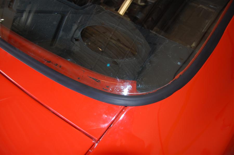

Manufactoring the glass is super difficult and very expensive and the demand just wouldn't satisfy the the development costs, so fabbing it is.
The height of the pinchweld is no biggie, you just make up the 1/8 to 3/16 difference with auto glass urethane, but the gap between the edge of the glass and the "flush" of the body is the visual challenge....
Thanks Brad, For me metal work might be easier to do than a $1500 glass set. I enjoy the torture.
We used retail a 1" lip seal in the past but getting the corners right was tough. Having the modern look is cleaner, no lip seal, all body work with a 1/8"- 3/16" gap.
I addtition to adding the sides we would increase the base too from 3/4" to 1 1/8" for a bigger urethane foot print.
pictured before urethane....see what I mean about the corners?

Maybe a bad angle but it looks like your glass would have to be wider to go flush like. Or maybe the Aerocoupe look.
My point exactly. If I want a flush glass look, one option would be to make the glass wider. In the past that was all but impossible or at least not feasible. Now with AM Hot Rod Glass, I can get one made for around $1500.00 At least that is what they estimated. Could be higher but cheaper than narrowing the body.

The rear is a bit. Blending the side and corners are tough.
The front fill can be done easier than the rear so a stock winshield for the front with a larger glass for the rear would be the ticket.
