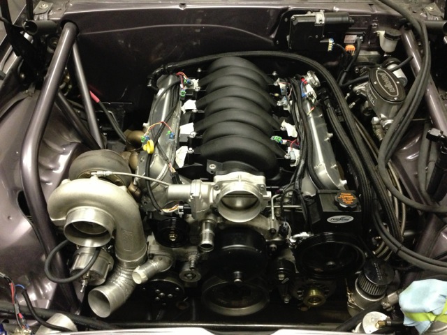

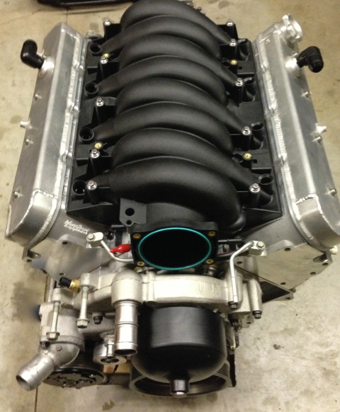

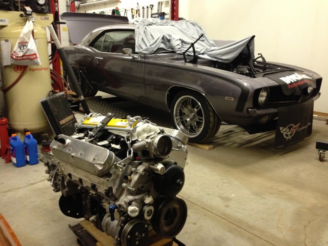

Ok it has been awhile but i can finally get back to the updates! After the last few pics all the mockup power train came back out and the completed 427 was finally put into the car!

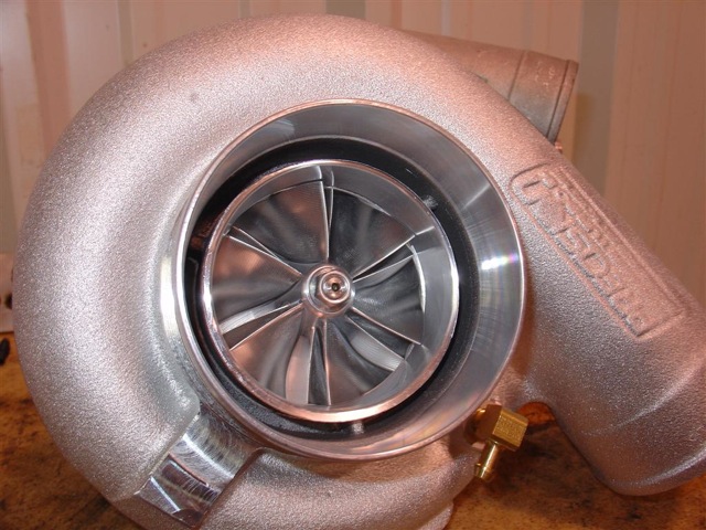

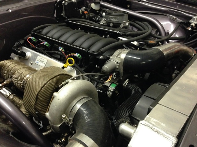

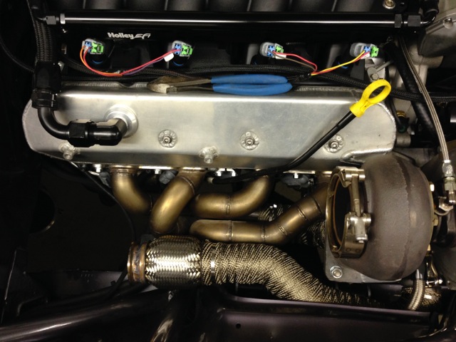

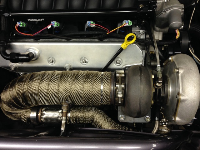

Once the 78mm precision turbo came in I did have to modify the housing as it was bigger than our mock up. We got it tucked in and fit right where it needs to be but its tight around the waste gate and i had to adjust the thermostat housing a "pinch" lol . Once that was done i could finally finish all the waste gate and exhaust on the pass side!

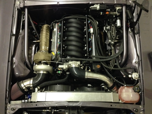

Mostly in but i still have some hose routing/fitting and cleaning to do but its in!

Very nice work. Love the top shot of engine bay. As Greg mentioned, I cant believe you did all this with the car painted.
Car has turned out great...Congrats!
