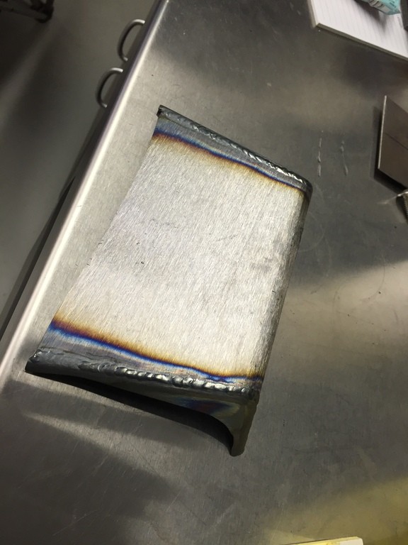

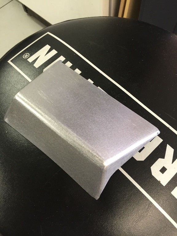

I have got a lot done in the meantime, just don't get around to posting pics.
Anyway hated the original front fender mounts on the firewall and I wanted to tuck the Peterson oil tank in the cowl area, so after gettting the dse fill plate welded on I decided to cut the old mount off and make a piece to flush it all up and square the corner off. filled in the original fuse block hole also
Also mounted the RestomodAir Ac/Heater bulkhead. Nice piece!!

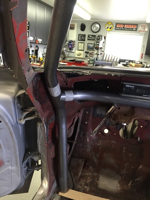

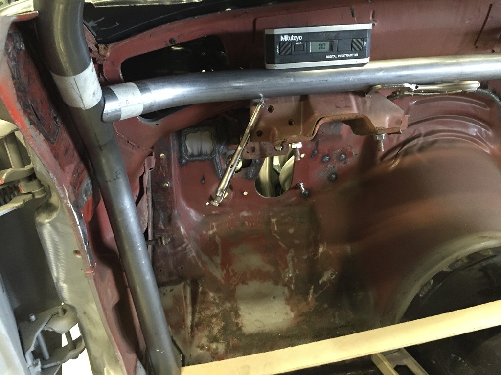

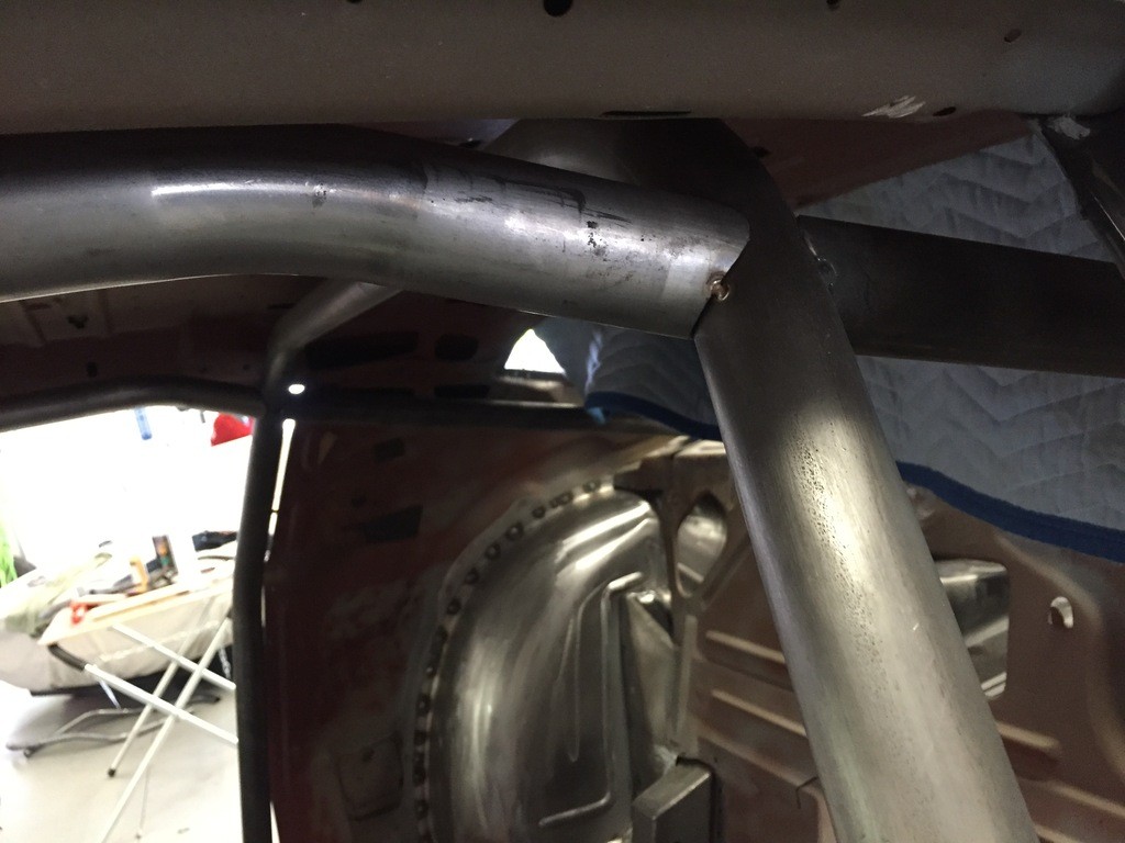

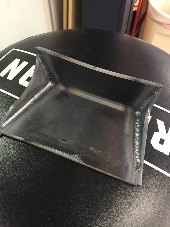

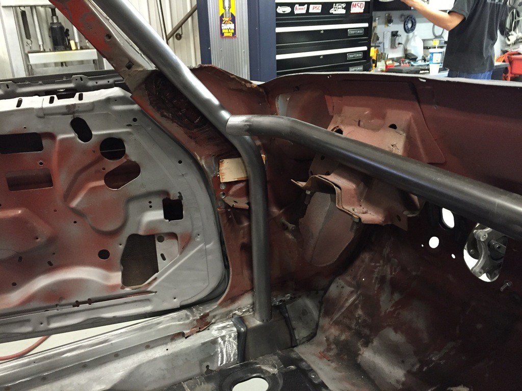

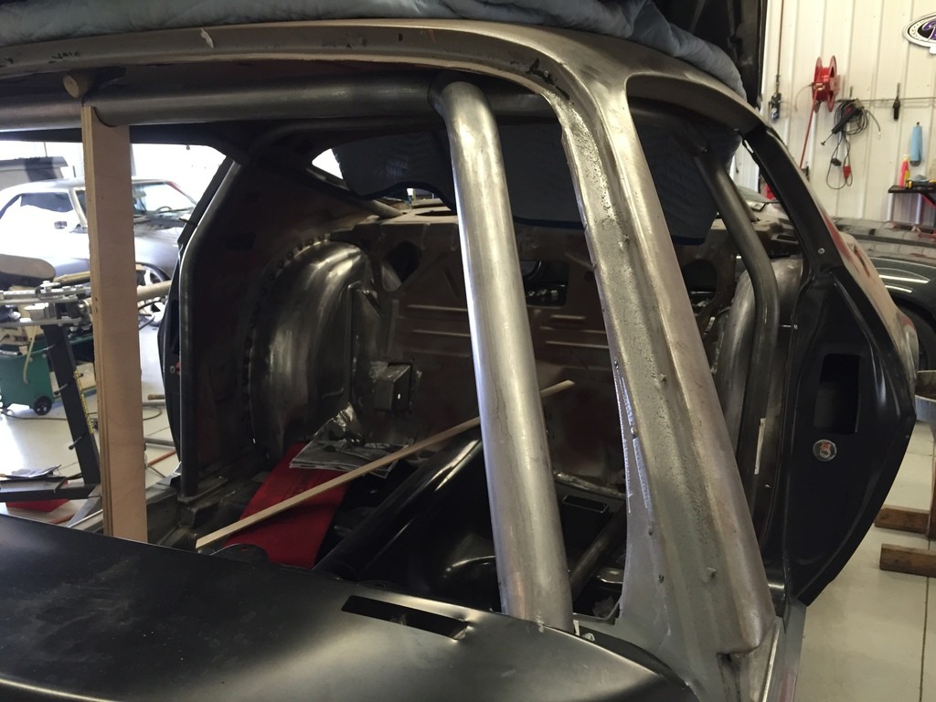

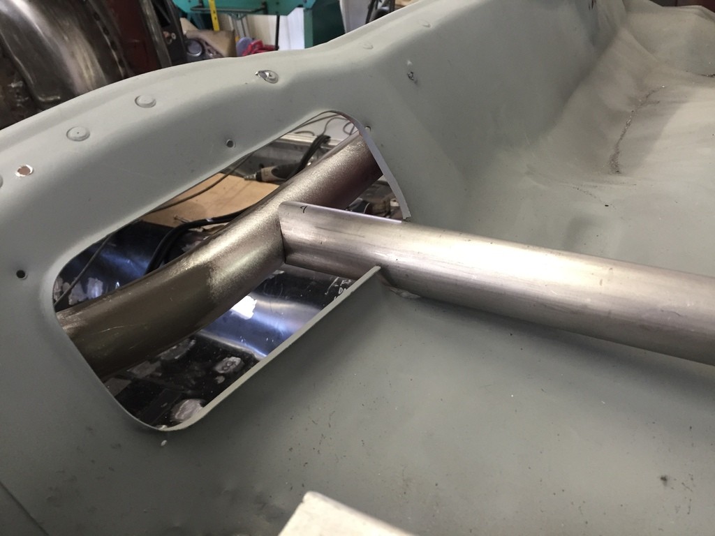

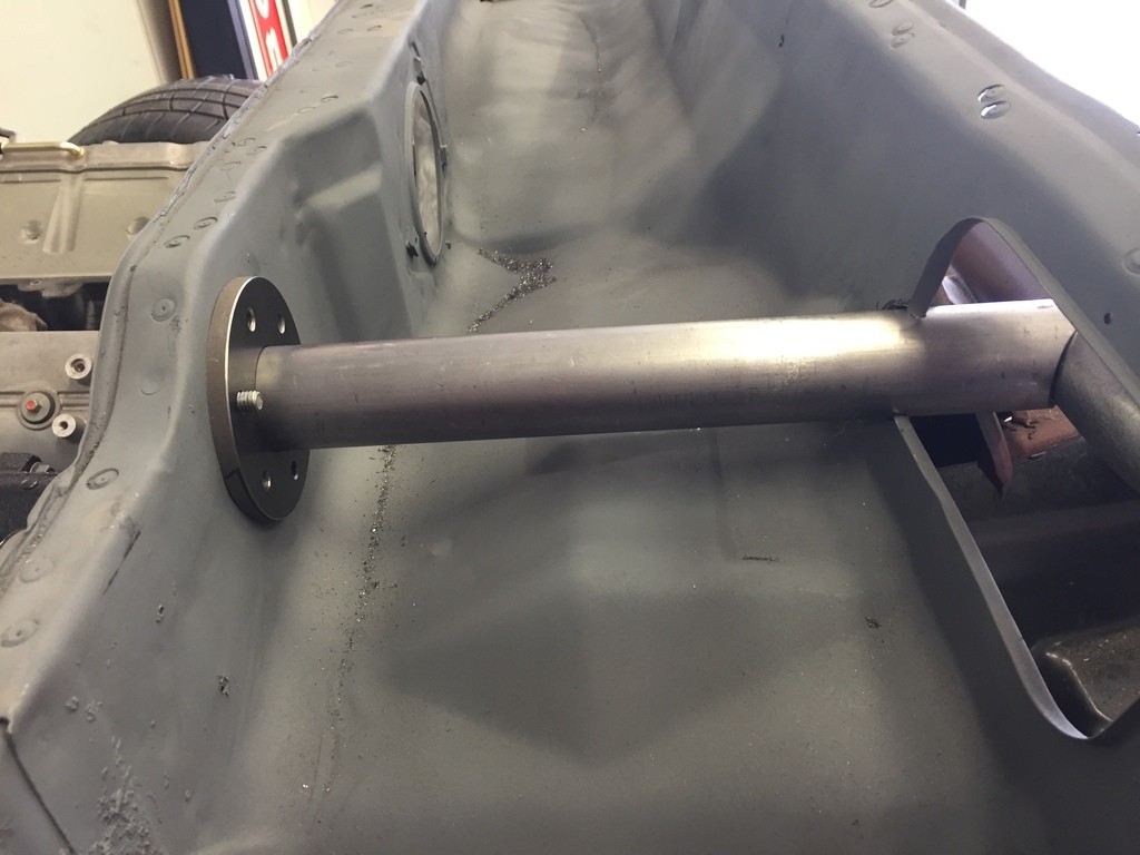

Also pretty much have the cage done.
We built these doublers to weld the down bars under the dash to the rocker panels.
I think it was Mac and Otto's?? thread where they had removed the cowl top for access to mount the bars from under the dash to the firewall. Mine needed a little rust repair anyway so off it went. Cleaned everything real good and primed. Last pic shows the rear half to the firewall bulkheads we built (well my son Taylor did )

nice work Steve. Cage looks real good. You bend that up or is it a kit?

Thanks Vince Never done it before but I bought a JMR Air/Hydraulic Tubing Bender and a hole saw tube notcher from Trick tools and bent it up. Didn't even waste hardly any material, it's a miracle!!
