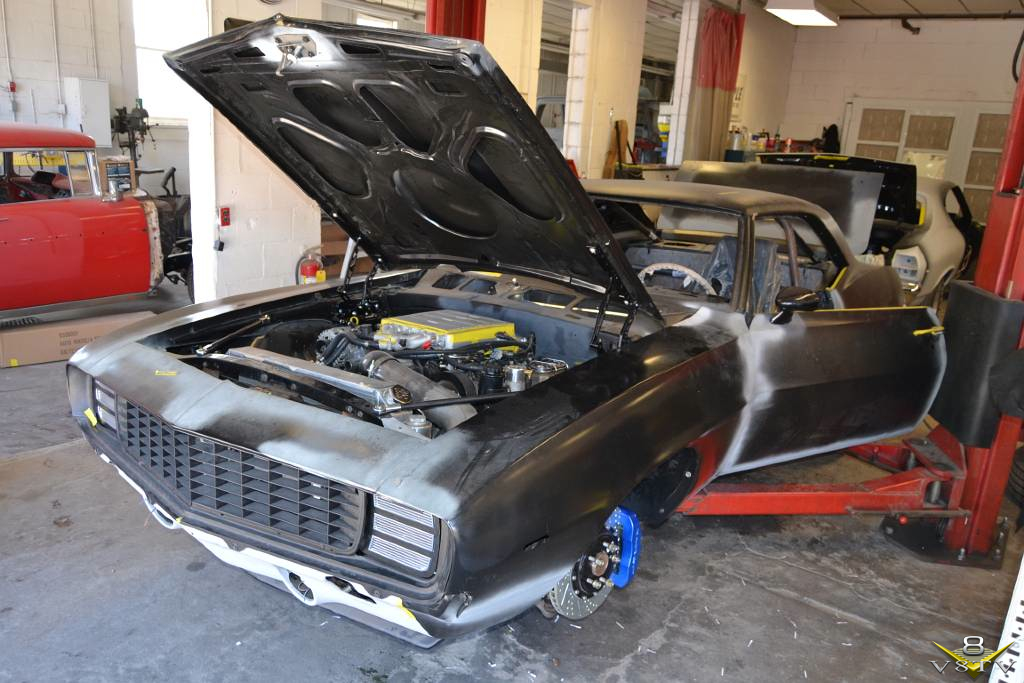

We got the sneak peek at the color with the Baer calipers powder coated to match the blue exterior color.

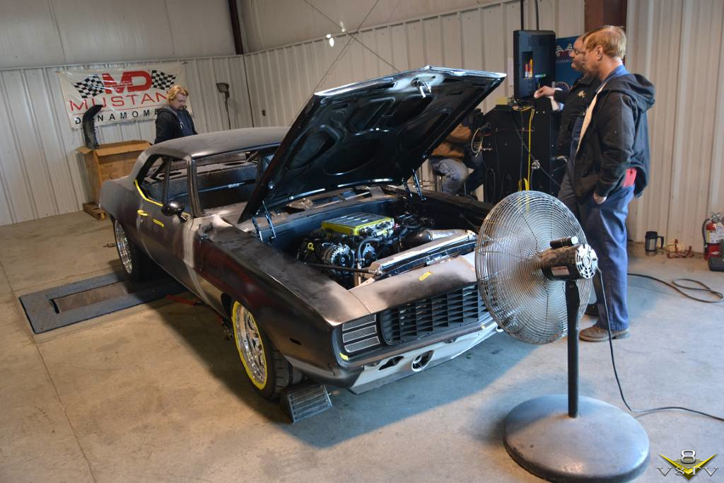

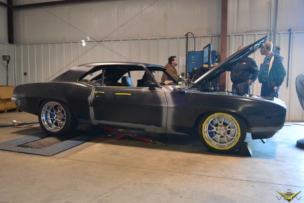

Our test assembly was nearly complete, and the car was started and run for the first time. The crew built a complete running and driving vehicle to ensure that no additional holes or fabrication would be required after the car was painted.
We ran the car on the chassis dyno to break in the mechanical parts and to verify the state of the two. After a software glitch that was restricting the throttle, the car eventually made over 620 hp at the rear wheels!

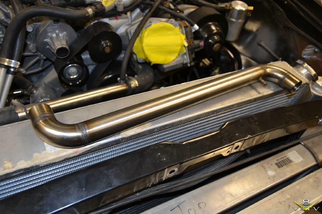

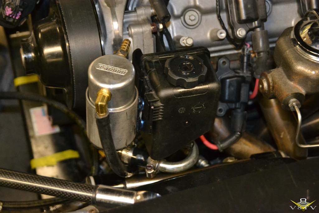

A custom bracket was made for the Moroso oil separator and mounted by the power steering reservoir. Note that we changed the steering reservoir to a stock GM style, we have learned that they are much better for preventing air bubbles from the power steering fluid then non baffled reservoirs.
Stainless radiator tubes were made to replace the temporary rubber ones.

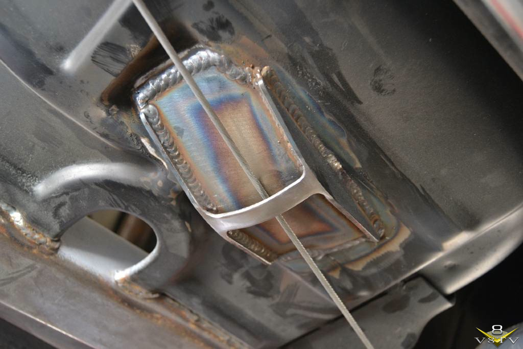

Steel guides were made for the emergency brake cables under the car.
