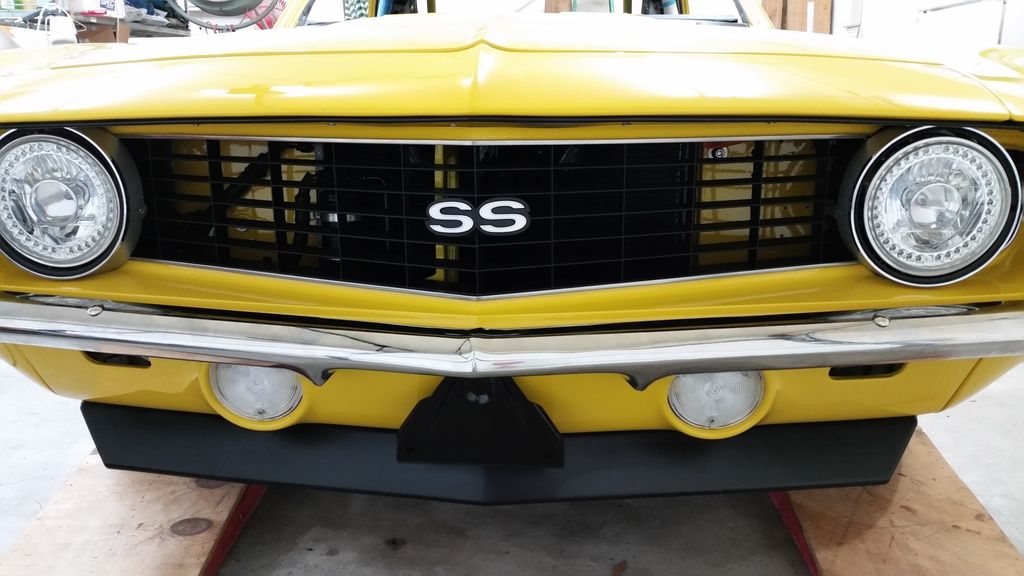

The headlights and bulbs that I ended up using are these types.
The headlights
http://www.ebay.com/itm/7-ROUND-GLAS...item540831bac6
The inside bulbs:
http://www.ebay.com/itm/161614752487...%3AMEBIDX%3AIT

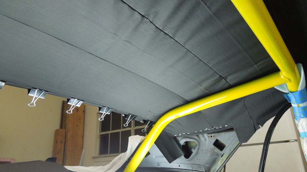

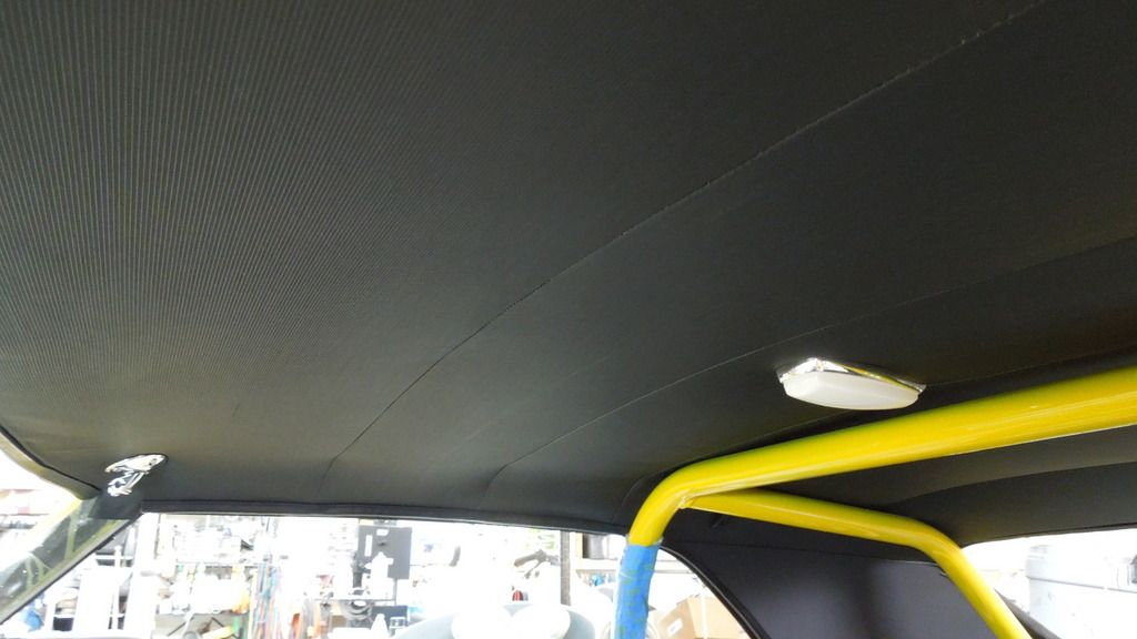

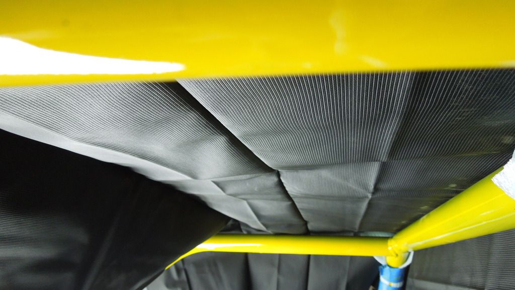

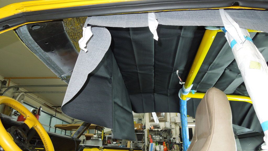

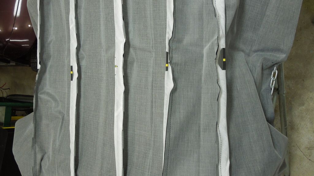

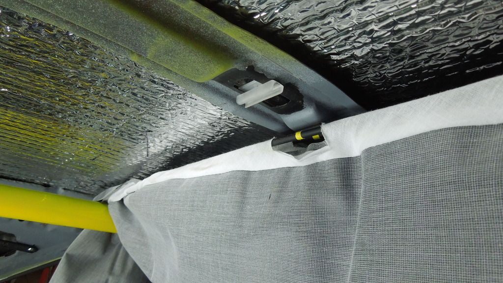

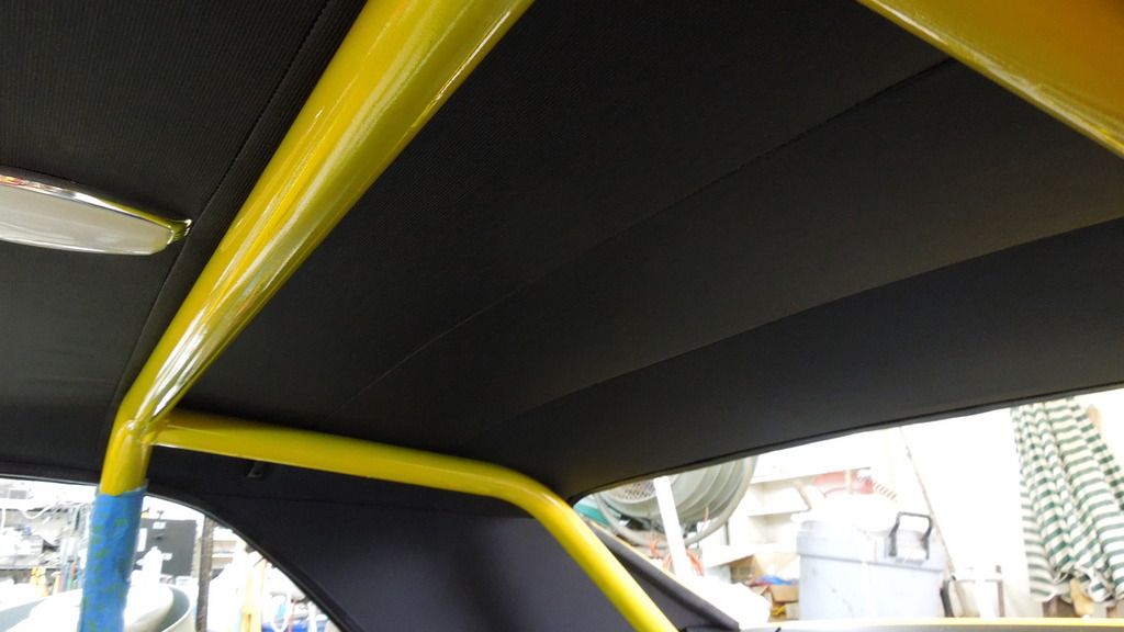

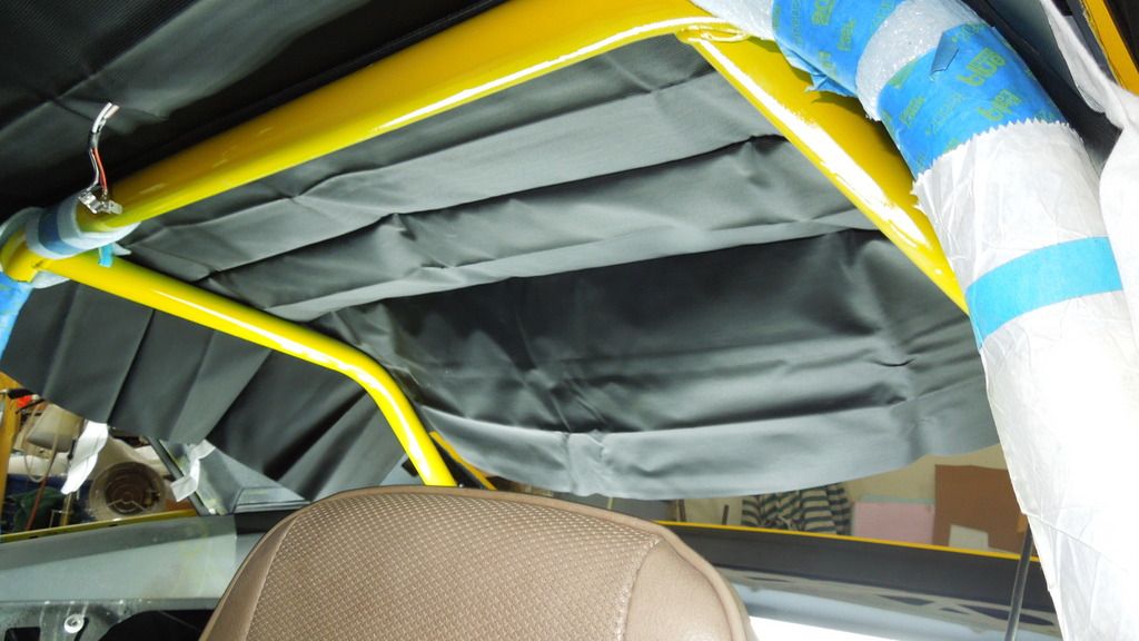

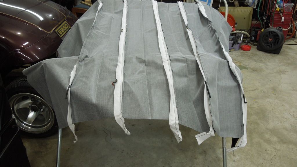

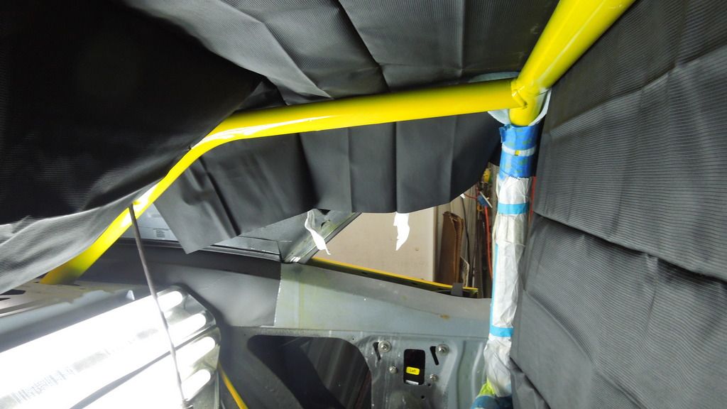

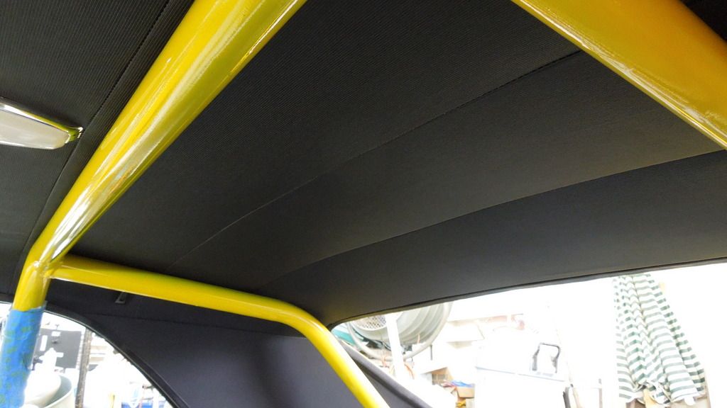

Post My first try at a headliner install...
With all of the other stuff that I have tried I thought I would give a try installing my headliner. In the end it wasn't so bad.
With some help of the carefully placed heat gun and my heat lamp while monitoring with a temperature gun, I kept it below 220 degrees.
