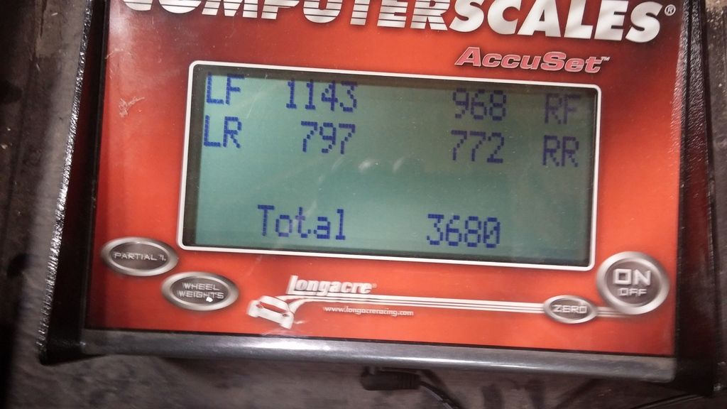

I decided that since my engine upgrade is basically finished and I had a bit of time and money left over...that I'd tackle some left over suspension projects.
My first chore was to corner weigh and balance the car again. I have not done this since before all of the interior changes last year and the aluminum heads this year. First step was to disconnect the sway bars front and rear. After that set tire pressures to race trim, remove spare tire and it was ready to weigh...fuel tank was completely full. Basically the car shed about 80 pounds with the changes above, but the corner balance\cross weights stayed in the range they needed so I didn't need to make any adjustments to the springs.
Here is the car in race trim, no driver.
With driver
and cross...
Car still has 57% on the front just a little bit less than before is all. Cross is within a half a point of the total right weight which is where Ron likes to see the cross on a left heavy car like mine. Right front could use 10 more pounds or so but that isn't enough to mess with making changes in our eyes. Overall I'm happy with it, really good to see it under 3500#s now.
