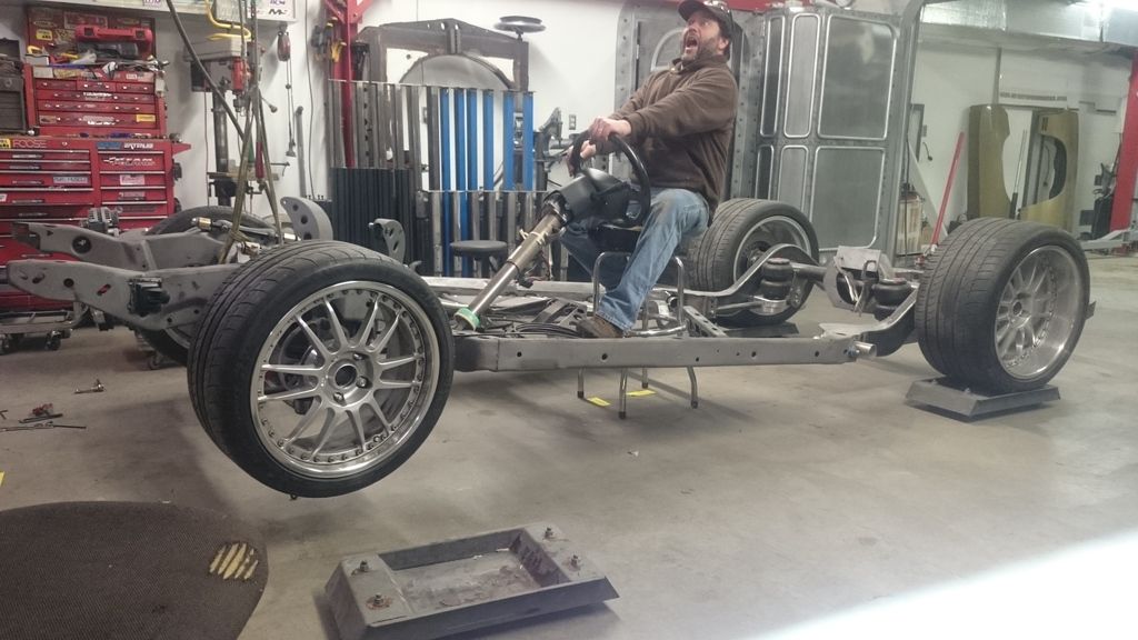

after taking wayyyyyyy longer than it should have finishing the inside of the shop and eqip. it is finally going to jump back on the Chevelle !! after attending Ron Sutton's suspension workshop I am going to try to implement some of suspension ideas I learned and put them to use!

Originally Posted by E.rodz View Post
Ok, I'll ask first. What are these?
'68 C10 swb
'69 Camaro convertible
'72 Chevelle

Posts: 6,612
Thanks: 1,728
Thanked 912 Times in 679 Posts
Legs for his frame table
lol. how am i supose to know who is burried in Grants tomb? been there done that! i think they are in every picture on the entire page.
thanks for clearing this up for me. i don't have the time to keep up on all of the forums.
