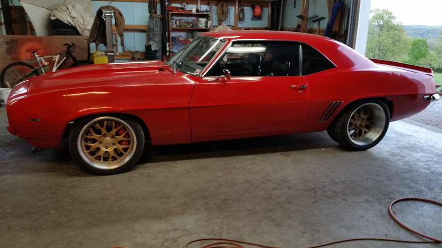

Originally Posted by dhutton View Post
Would be useful to see a pic at ride height.
Don
Ask and you shall receive...at a later date. lol

I finally got my ride height set thanks to Josh for sending me a coil over wrench. I had to clearance the front corner of the muscle bar on the passenger side because of a rub. At full lock the back of each tire doesn't rub on the frame and the front has clearance at the muscle bar. I will have to get a little clearance at the fender on both sides to compensate for suspension travel while turning at full lock. Nothing unexpected with the install on my 69 Firebird.
