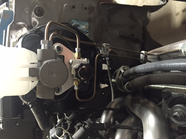

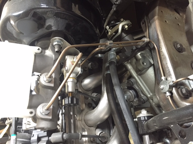

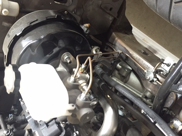

If anyone has any good line routing examples (I am not using a distro block) just an adjustable prop valve ... I woul love to see some good ideas

Here is what I did on my DSE booster/master with a wilwood proportioning valve. Don't know why the pics loaded sideways.
Guy
