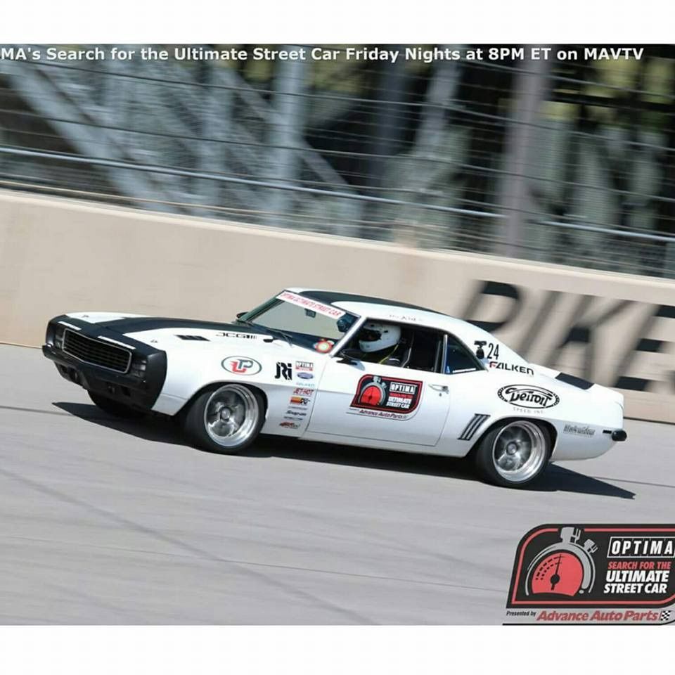

Jake,
Is the entire car wrapped? How has the wrap held up to rock chip and other misc battle wounds?
Do you have any pics of the cage? I've checked your website and this build thread, but I can't find any pics.
Also, good job this weekend.

Yep the entire car is wrapped. It's held up really well to chips but I've been disappointed by how hard it is to clean. Cone marks and road course rubber usually rub right off paint but with the wrap I have to spend hours with a polishing pad to get off a lot of stuff. It still looks darn good though when clean.
I'll see if I can dig up some cage pics... It's a 4 point that JCG made us and is the exact same as the one in blu balz.
And thanks this weekend was a blast! For those of you on the fence about doing these USCA events I can't recommend them enough, and the pikes peak CO facility this past weekend was incredible.
