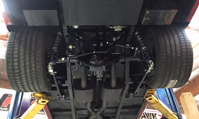

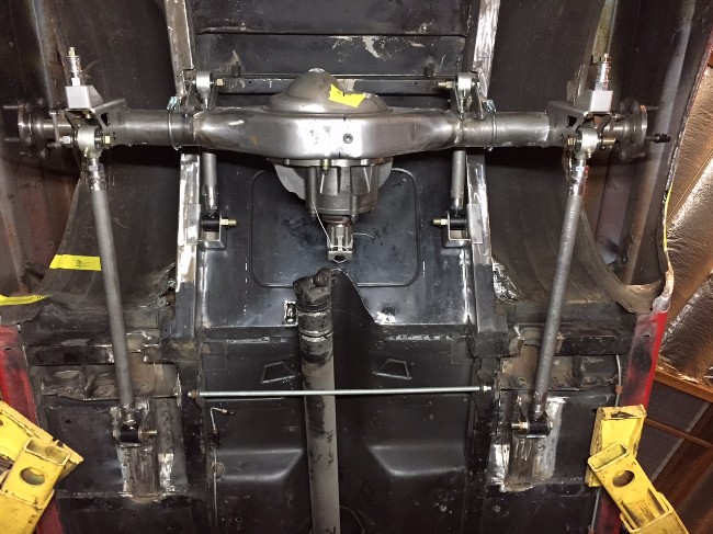

With the links bolted in, the brackets tacked on the car can be put on the ground to check final tire fitment before we start the watts linkage.

Start of the watts linkage supports and mount. With the roll center height from 9 1/2" - 13 1/2" the center plate is drilled.
Rearend housing mounting tubes and braces welded in once the links were set.

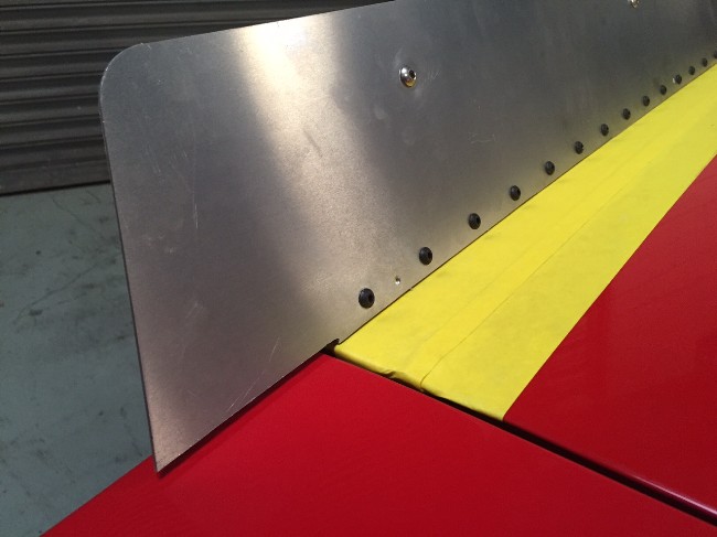

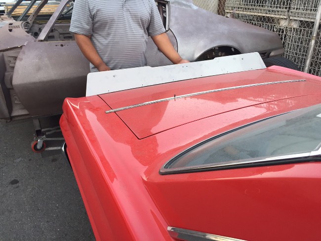

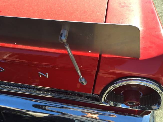

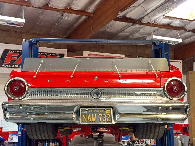

The one thing I was not sure about was the spoiler. When my fabricator pitched it to me I was on the fence. Especially when its a bolt on piece. Once its on it will need body work to reverse.
The one is actually designed for a Camaro and the Camaro trunk shape.
As far as width it was perfect because it lined up perfectly with the roof line.

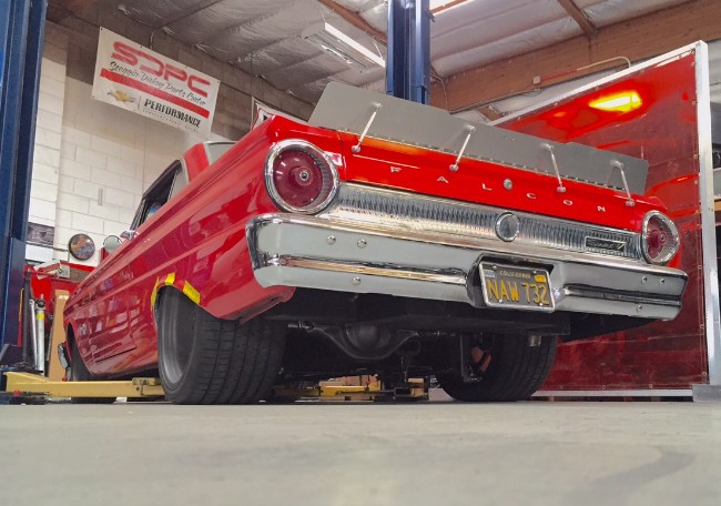

Rear is all welded up and painted. Came out pretty good. Had to redo the tail pipes because I wanted to leave them where they were, under the bumper.
Bunch of sheet metal work and then the front fenders.
