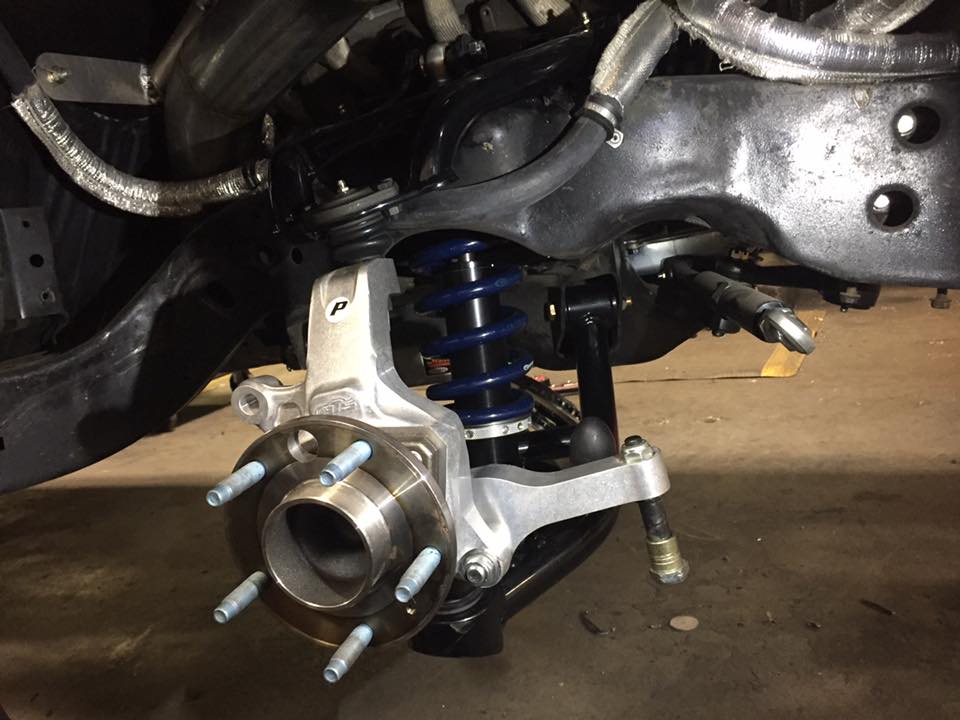

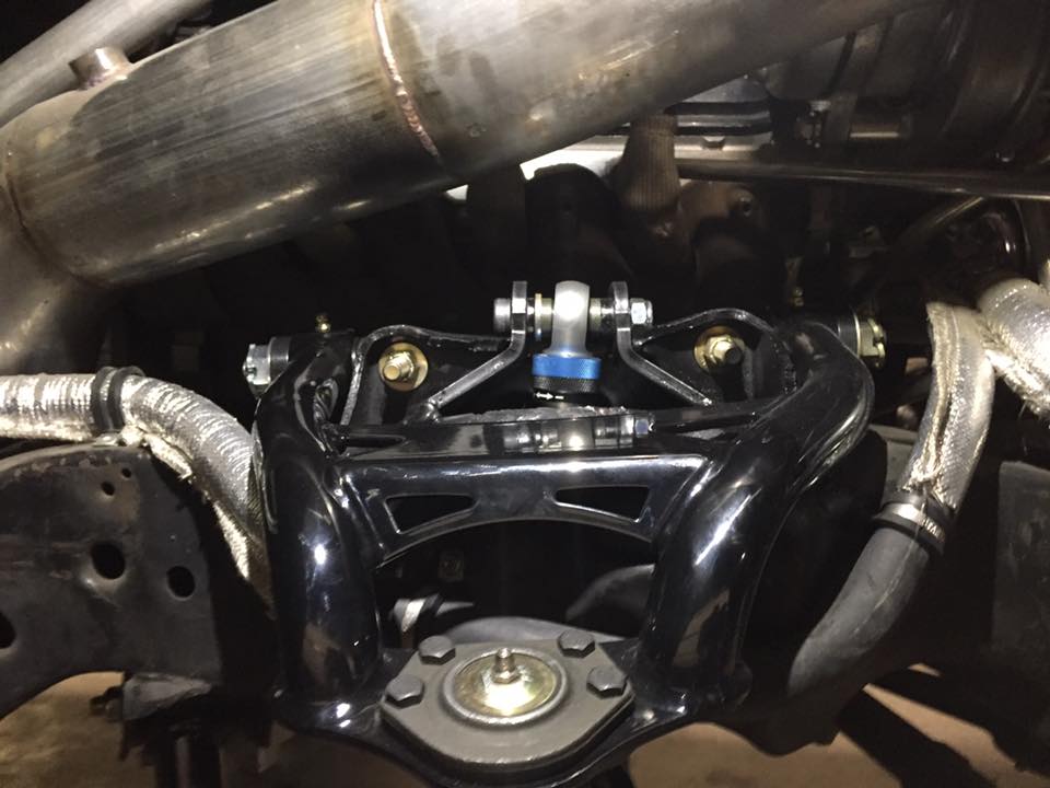

Some more progress as been made and we are pushing to finish the car this year. Lots of little things to wrap up and make happen.
Thank you Filip at Cortex Racing for the JRi coilover hookup. Chris will do whatever is needed to make the SpeedTech control arms work in order to fit them.
Blake at SpeedTech- thank you for your help with coilover info and other tips you have shared so we could build this custom setup! Great people to work with.
They will pair well with your forged front ATS spindles/ZR1 hubs and I plan to give this suspension a pounding.
Some pictures of recent work.
