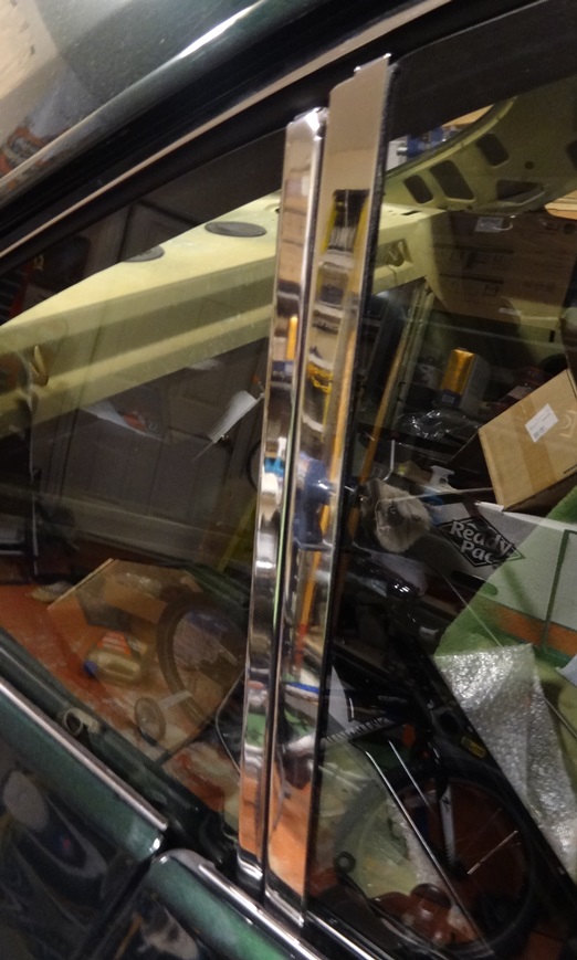

Worked on window alignment Saturday. Spent an hour or so tweaking the passenger side windows. I was starting to feel a bit inept, each adjustment affecting position a bit in ways I did not expect. Took a while before I was happy with the outcome, still may tweak the up stops on the rear to let the window come up a hair more. Tested the fit with a dollar bill in several places along the top of both windows and the seal between, pretty tight.

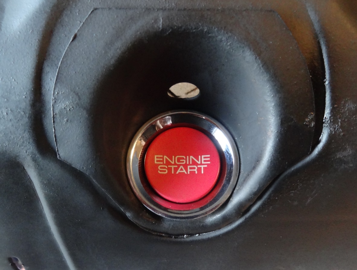

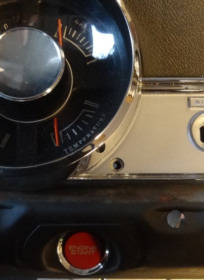

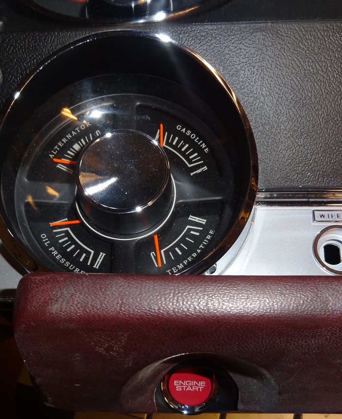

Sunday I took a dremel to open the ignition switch hole up a bit, then a flat file to make the hole almost a square. Start button fits snugly. Still need to sand down and paint the dash frame. With the lower dash pad in place the button will be a subtle change. I have a few more modifications to the dash to do... parts are a little dusty stored in the garage, definitely some clean up to do when it comes to final install. The maroon dash pad in the picture is a spare I had lying around, my "good" one is black.

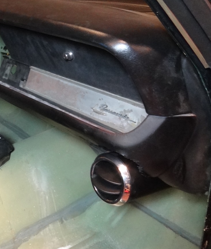

Worked on AC ducting today. There is no easy way to add AC ducts to my dash and keep the factory dash bezel. I really dislike the aftermarket plastic bezels that hang under the dash and have a hose snaking under to them. Then you put a dress up or billet vent on the plastic bezel...
I do have an idea though. I took my old cut up dash frame and some old dash pads and mocked it up today. Need to pull it up 1/2" and maybe in 1/2" deeper, but here is the idea.

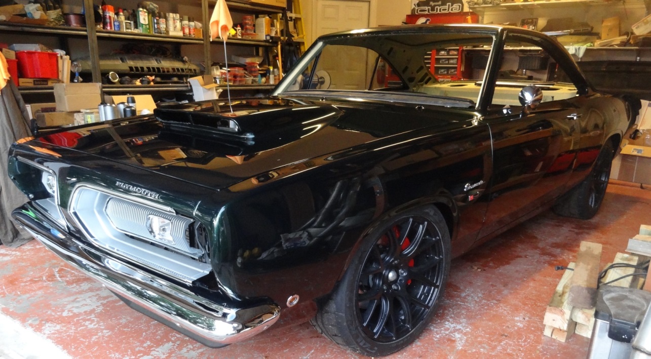

Very little progress as of late, too busy at work and no money. I rolled it out of the garage for a wash and wax. Rolled it back in and took a few pictures. Need to get lowering blocks for the rear but looks pretty good. Plan for the air cleaner is black base, hemi orange top with the 440 6bbl sticker. Suspension, engine and transmission are all in place. Trying to get myself motivated to do what work I can on it. Took a few pictures.
