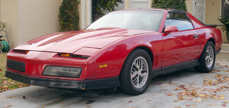

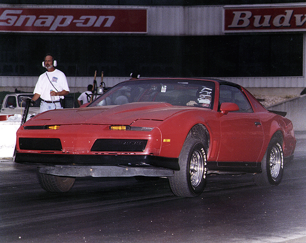

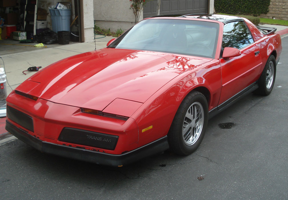

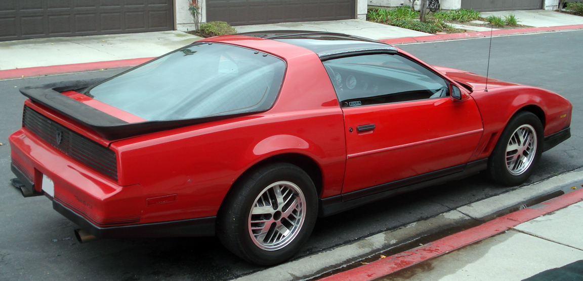

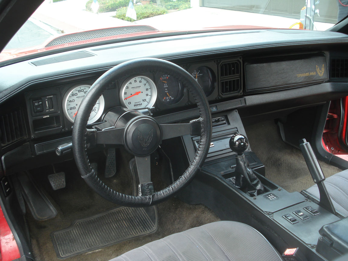

I had an '84 Trans Am for 19 years, and I miss that car. It would be fun to have another one day, and having a good suspension system available to improve handling and fit wide wheels would be great. I wouldn't prioritize slamming it per se (with just a 1" drop on my car I had enough trouble with speed bumps and curbs) I'd focus on handling like it's on rails with big meats and not compromise the steering.

That's a pretty sweet sleeper there Tuske! I think another should definitely be on the build list!
