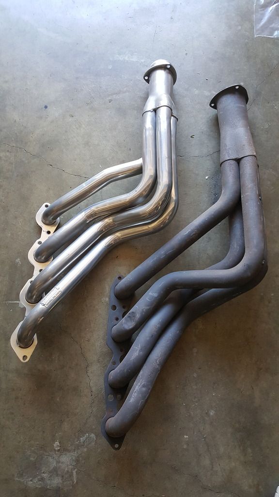

Thank you! I guess sometimes it's not always better to have a bigger pipe! LOL, I have a hard time going from the old drag racing ideology to pro touring or resto mod. I had these Hooker Super Comp headers with 2" primaries and a 3 1/2" collector. They hang really low and there's little room for spark plug wires, steering, etc. I got these Headmen Elites with 1 7/8" tubes and 3" collectors and gained almost 2" of ground clearance!

For the application the Headman's are great fit. Are those the: Hedman Husler® LS Engine Swap Headers 45216? I will be purchacing these this summer (although the pic in the add may not be the specific application) and from the research I've done they are what you've just installed. That confirms things for me…Cheers!

Thanks Joe. No they aren't the Hustlers. I have a big block chevy. I'm kinda stuck on old school for now but haven't ruled out a future LS swap.
