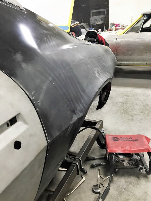

Not much of an update but;
Camaro went to the body shop a few weeks ago, FINALLY
I took a few pics 2 weeks ago when i was there. The shop is about two miles from mine, so I have that going for me, which is nice
[IMG][/IMG]
[IMG] [/IMG]
The quarters are pulled 1 1/2". I had a second set of quarters sitting here ( the ones I said earlier in the thread fit like crap) that we used to do it. I stopped last friday after being out of town all last week and they have both sides fully welded, hammer and dollied, english wheeled, side marker holes filled, primed and back on the car.
They were stretching the outer fenderwells when I was there.
But!! I forgot to take pictures
I will be back there and taking pictures by tomorrow
Steve

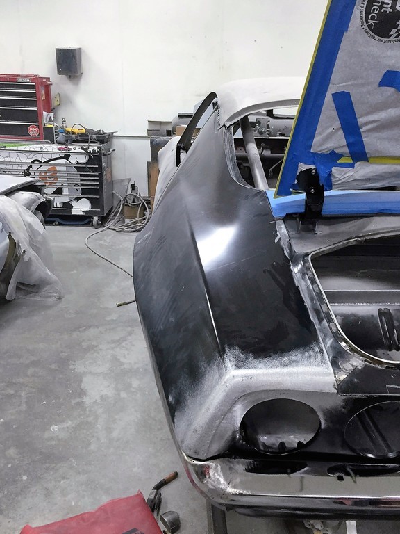

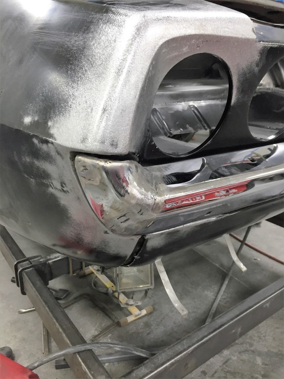

Ok Here's an update, although not much of one
Quarters, inners all welded on except around rear window as I am waiting for a Fesler flush glass set.
First two pics give an idea of how much the quarters were pulled (1 1/2"), I love the way it looks

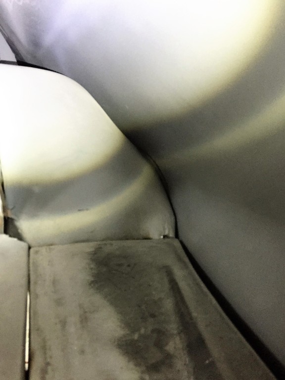

Now the shop is tucking the bumper in to the body and working on getting consistent gaps around the perimeter. Also filled the seam between the qtr and tail panel
Tried to take a couple pics to show how tight the outer wheel weels fit the qtr but it doesn/t show up too well. I'll try to get a couple with better lighting

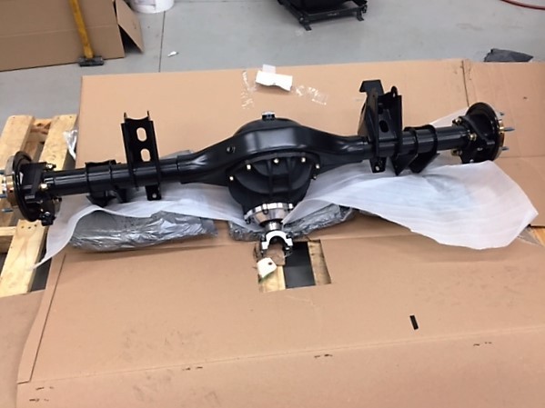

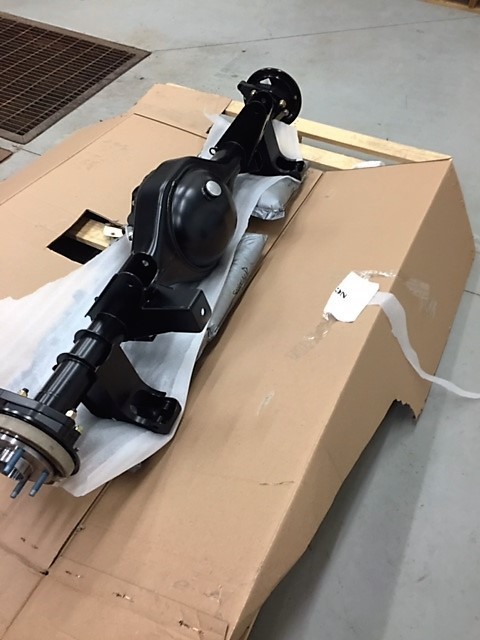

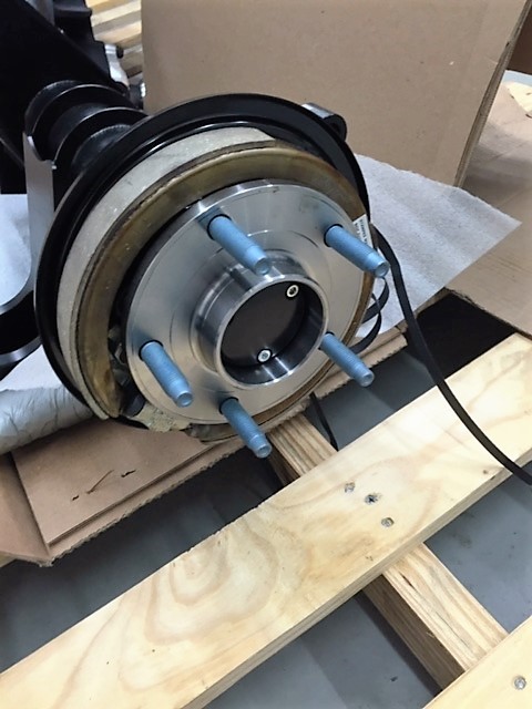

I did also receive another puzzle piece from DSE. This has the new "Stielow" floater setup on it. The Baer 6S brakes are here also.
