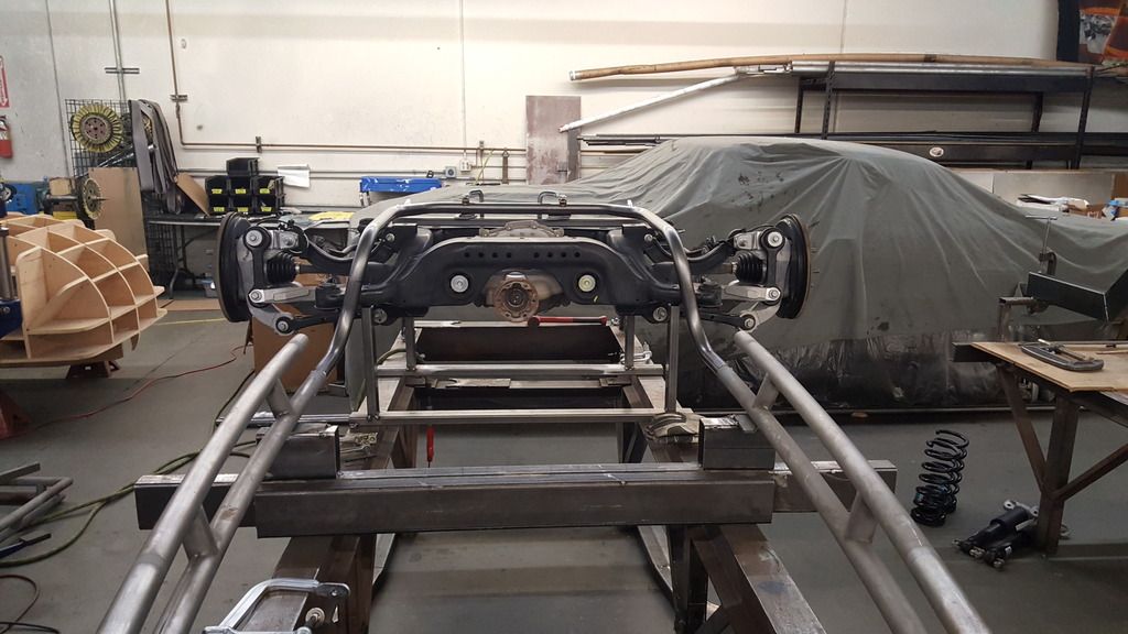

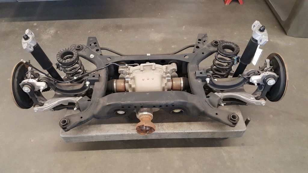

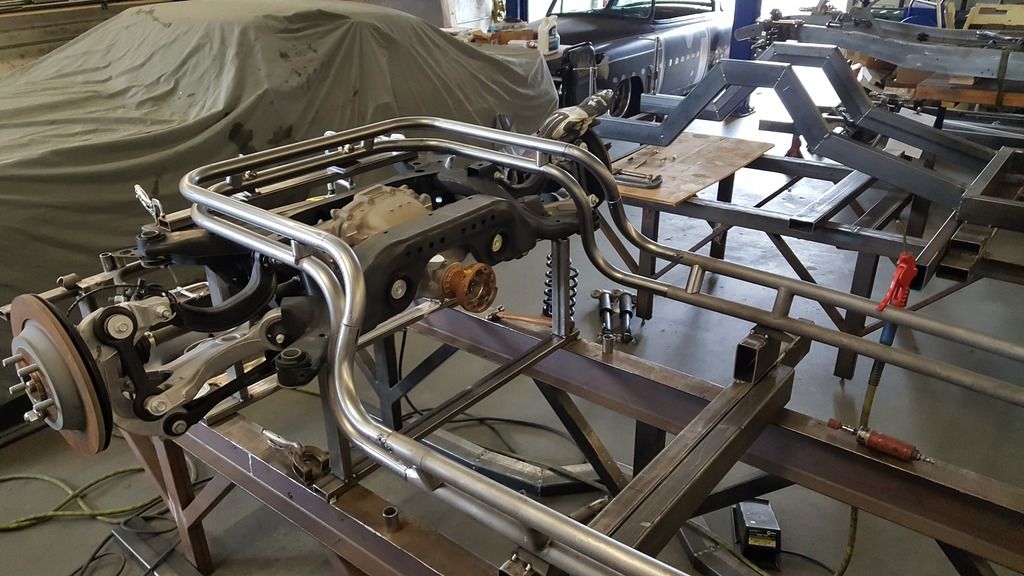

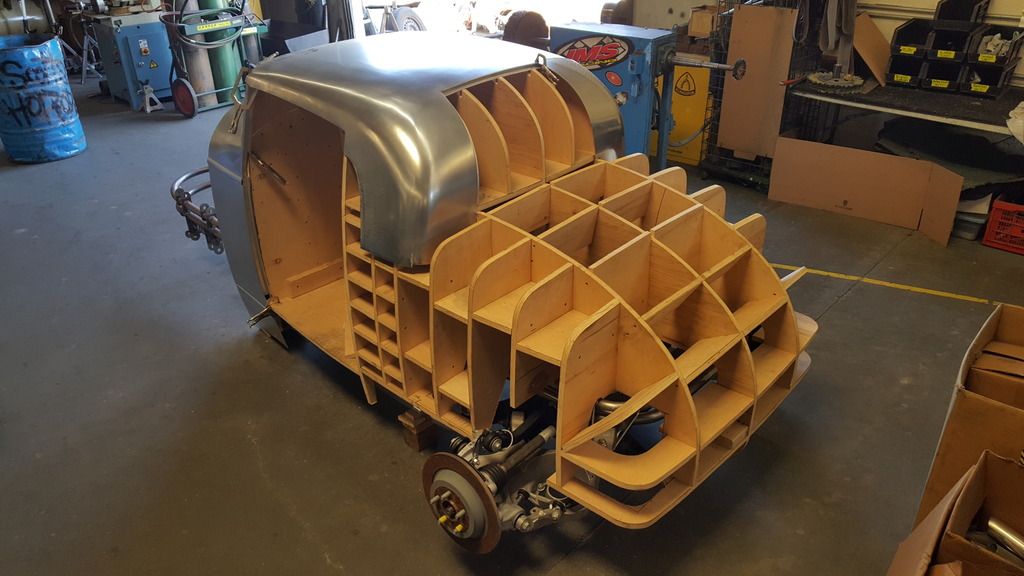

so last weekend I worked my butt off to get the new IRS mounted into the chassis so I can make this thing a roller for the Wings Over Camarillo air show coming up this week on the 20th and 21st. I cut off the old rear of the frame and remade it to accept the 2015 Ford Mustang IRS. here are the pictures

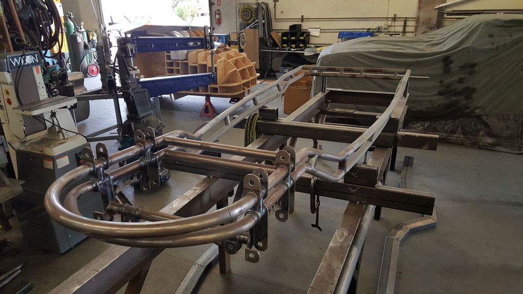

I bent this first tube all out of one piece.
the second tube wouldn't fit into the bender properly so I had to do a few joints

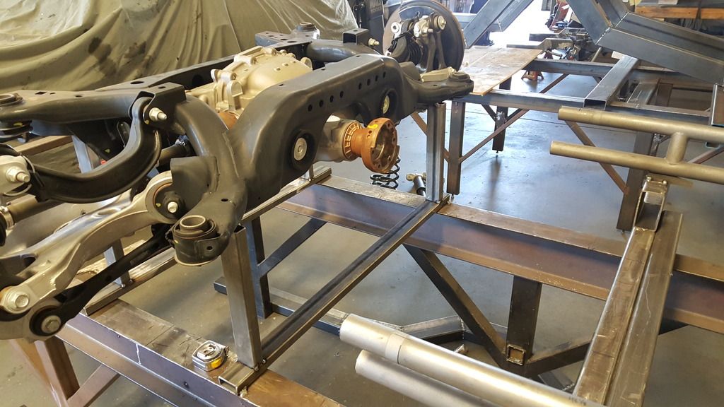

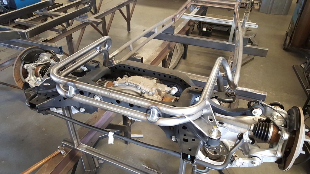

I then had to disassemble the rear of the buck so I could rework and cut out some room for the newly remodeled rear of the chassis.
once I had the chassis in place I bolted in the IRS and began reassembling the buck around it.

Like I mentioned in a previous post, I am getting the car ready to go to its first public showing at the Wings Over Camarillo air show here next weekend August 20th-21st. So with that, a lot of things are coming together for the car all at once, and it feels great. Yesterday with some help from my Ol' Man I was able to get the car looking a lot more like a car! while I worked on reassembling the buck he was busy cutting initial shapes for the nose of the car. once those were complete him and I tag teamed the nose to get it just about finished. enjoy!
