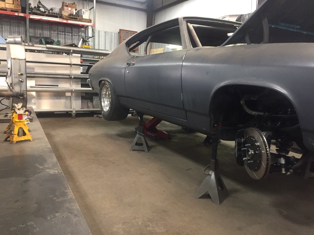

A little more headway:
Wilwood 14.25" rotors/6 piston Aero6 calipers
Speedtech upper/lower control arms with upper coilover mounting kit (very nice quality parts)
Coffey Fabrication custom lower mounts
JRi coilovers with Hypercoil springs
Next up torque arm, watts linkage, WaveTrac LSD out back.

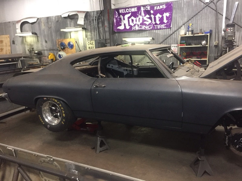

Under the knife for the Watts link/Torque arm..... and Wavetrac LSD. Out with the Detroit Locker.... (35 spline... for sale)
That hole you see in the housing was the fluid fill!
test fitting some alternative tires out back....
Time to order some rims.... Next up is exhaust and not much more left after that
