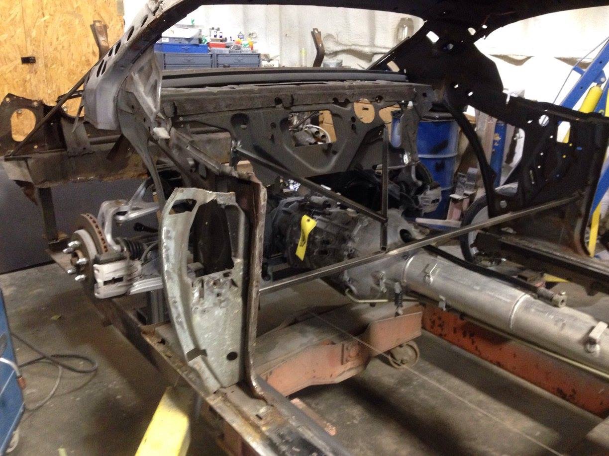

Thanks, the Chevelle was just wide enough. I'll have to run the Corvette wheel spacing so no dish in the back but I think it looks pretty good with them. I can't wait to get some nice wheels on it

Looks real good. How much will you have to lengthen the torque tube?

Thanks, We lengthened it 6-1/4"

Do you think you will be able to have a usable back seat?

There will not be room for a bench seat but we are going to mold buckets into the back. I doubt there will be much legroom though.

You can see the transmission takes up a lot of the room for a seat
