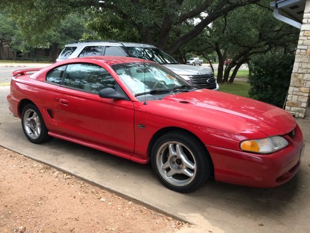

I never planned to give up on the Camaro but I did get another car too. Picked up a 95 Mustang GT with the 5.0 and 5 spd for $1k. It was from the original owner with ~300k miles and the AC still works. Certainly no show car but its a great beater to practice Axing while I get the Camaro back. Last AX I put air in the old tires and added 2 qtr of oil. That was enough to beat out 3 of 5 BMW's on the course. Who knows what will happen with decent tires. Later on I plan to build it up as a NASA CMC car. Wont be as cool as Robs AI car but should be fun none the less.
Weld has seen the beast in person and can attest to how magnificent it is.
Attachment 60286
Awesome score.
Yes it will.
Dave is just pissed he is not part of team CMC / AI
Looking at the progress you are making on the Camaro and your fab work I have no doubt your CMC car WILL turn out better than AO.
Your doing a great job!
