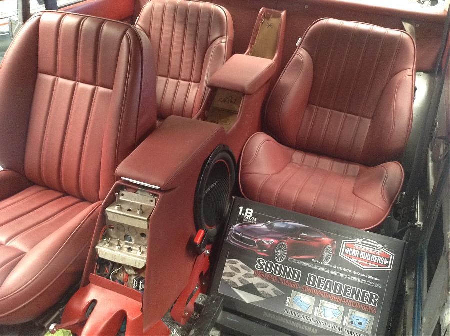

Great to have another Falcon on the board....my project is now "down under" but was an East Bay car till 2013 ( center of the Modified Falcon universe it seems ).
I have progressed a lot since the pic, last pieces of the interior going in this week, a little more wiring to tidy up. Has G8 strut front suspension/brakes/power rack, 4-link on 10-bolt Salisbury LSD. Strut conversion not started at time of photo.
Drivable for 10 days now........
