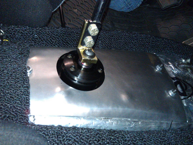

I'm glad I decided to build a shifter access plate as the 3 shifter changes I made would have required R&R of the trans.
