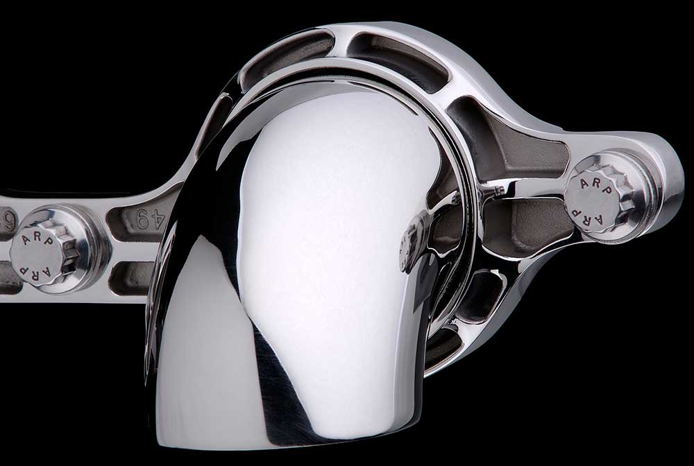

Talking with Ultimate Headers, they are still working through headers for the '67 Chevelle. It should be released in a couple of weeks. That said, I put on order a set with their 316L stainless flange
I also am going with their extreme low profile clamps:
Finally, it will all be ceramic coated (verses polished) for low maintenance.
http://ultimateheaders.com/swap-head...4-camaro.shtml
