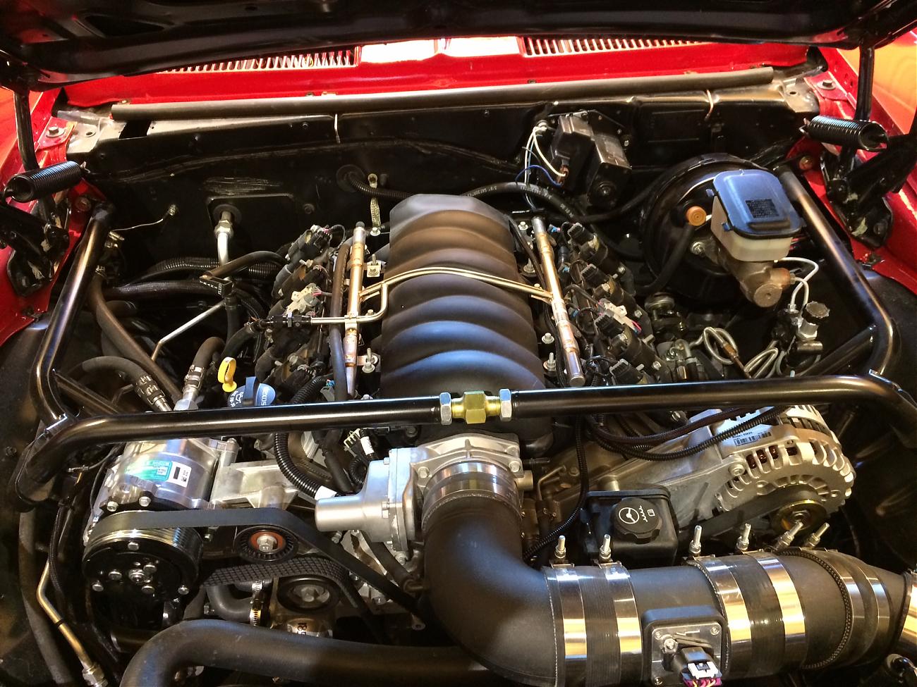

I was looking at these but they don't say what size of brake booster will fit, only that the stock one won't fit.
I modified a set of Hotchkis braces to fit around the Holley accessory drive on an LS3. It took a fair amount of cutting and it is still quite tight. I put them on my wife's 69 Camaro convertible to try to kill the cowl shake. No shake so far....

Here is a pic.
Don

Looks like the bars cleared the accessories just fine. It's the cross bar that interfered, correct?
Didn't want to hijack the thread, but it seemed relevant to the op's original question.
Tu
No the bars that go down to the control arm mounts hit the compressor and alternator hard. A lot of cutting and welding to get them to clear. Cross bar also hit.
Don
