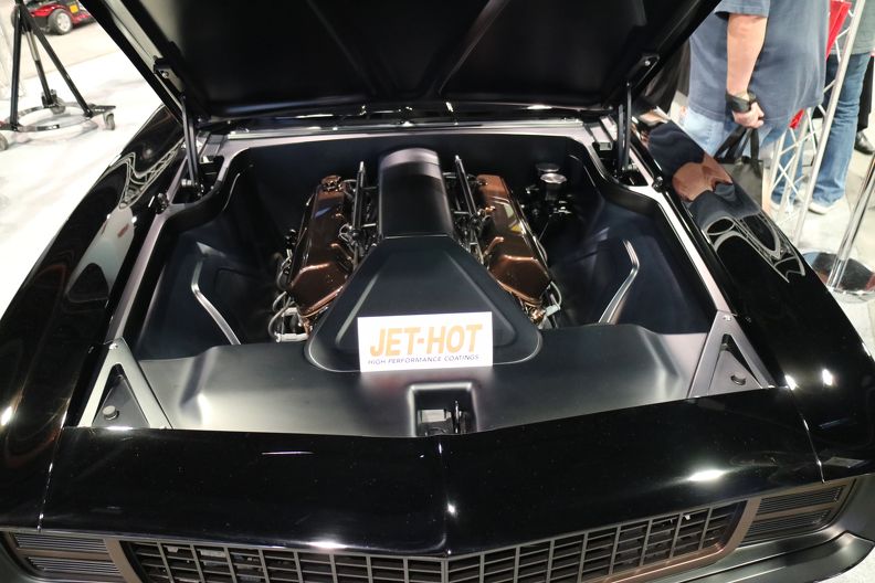

My opinion hasn't changed, I don't think you will like the results of the manual brakes on that beautiful street car. I'd be looking towards the C6 vete specs for a booster and master cylinder and do it right once. That will get you a modern brake feel with lighter pedal effort.
Todd
  #32
Old 09-19-2017, 08:21 PM
Musclerodz's Avatar
Location: washington, ok
Posts: 4,286
Thanks: 22
Thanked 164 Times in 95 Posts
9" dual diapragm booster with 1-1/8 master, its what I run, DSE runs, and I'm sure a few others. Once I get the prop valve dialed and pads bedded, its effortless braking and like pulling the parachute.

DOOM's Avatar
DOOM DOOM is offline
Location: South Side Chicago
Posts: 2,912
Thanks: 7
Thanked 64 Times in 40 Posts
Two words NO ROOM!

Originally Posted by DOOM View Post
Two words NO ROOM!
Maybe hydroboost would fit. Check with Paul at Hydratech.
Don

I have posted this before, I apologize if I sound like a broken record. You need clamping force or friction. A little of both or a lot of one or the other.
Assuming your hydraulics are functioning properly, it sounds like you don't have enough of either.
Do carbon brakes actually generate more braking power? Serious question. I looked around a bit and didn't see anyone that states that these brakes have a higher friction coefficient. They are lighter, and last longer (), and can handle more heat than iron rotors, but do they actually stop better?
Get a pressure gauge and hook it to the front brakes and see if how much line pressure you are building. Check it a 3-4 times with moderate pedal pressure and then 3-4 more with all you got. With line pressures a known we can come up with a clamping force at the caliper.
Donny
