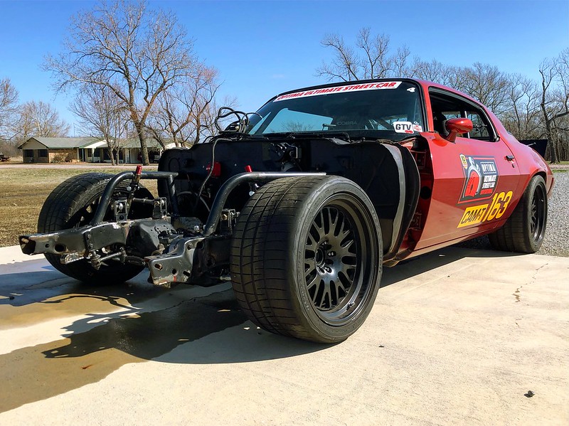

Onward and upward, 2018 was coming fast and we needed a way to close a pretty significant gap to the front of the GTV. We've scoured tons of build pictures and had some ideas for a while on how to revise the front suspension to fit a proper coilover and make it much more effective with a redesigned lower arm, along with redesigning the upper arm mounts to cure some issues with the base geometry.
Step 1: build a frame table
Step 2: disassemble car
Step 3: take a break to spot yourselves on Battle of the Builders
Step 4: hack and slash
Step 5: we will rebuild
The march of progress
Step 6: redesign upper mounts for a less aggressive camber gain and significantly lower roll center
Step 7: mount coilovers (coilovers coming later..)
Step 8: NASCAR swaybar!
For better or worse, we're changing damn near everything. The car should be significantly stiffer, with a more compliant camber curve, and a vastly improved shock package front and rear to keep it all under control.

Planning to keep it the same. We're limited underneath by the bellhousing, and up top by the fenders with so much tire underneath them. It should be more composed, so it might open up the possibility to lower it a touch more, though.

Plan is to stay the same, but we are gaining clearance on the inside with the frame mods and new swaybar, so we'll have more freedom to move it around if needed. After going to the CPP spindles I've been pretty happy with the fitment with using a 1/4" spacer.
