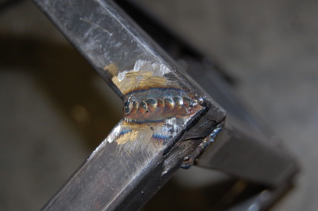

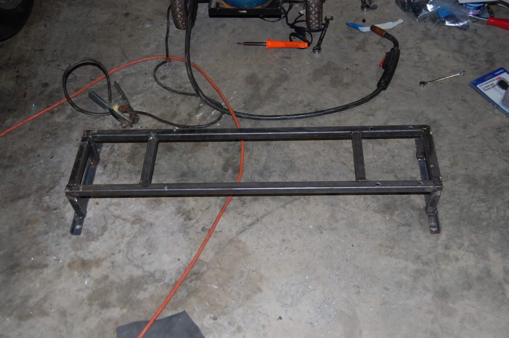

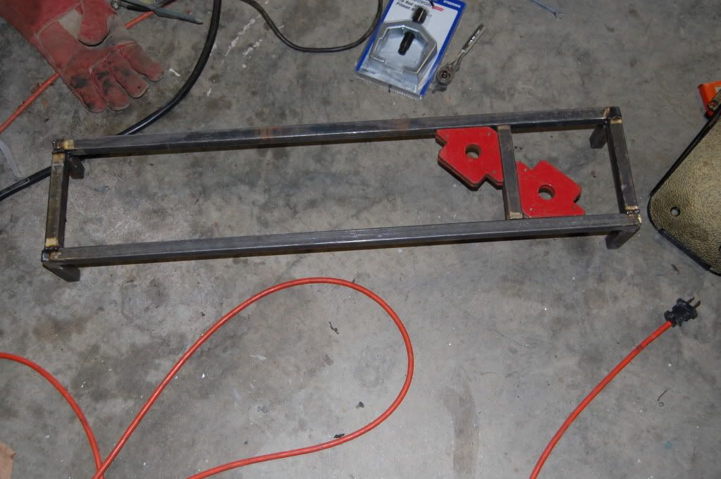

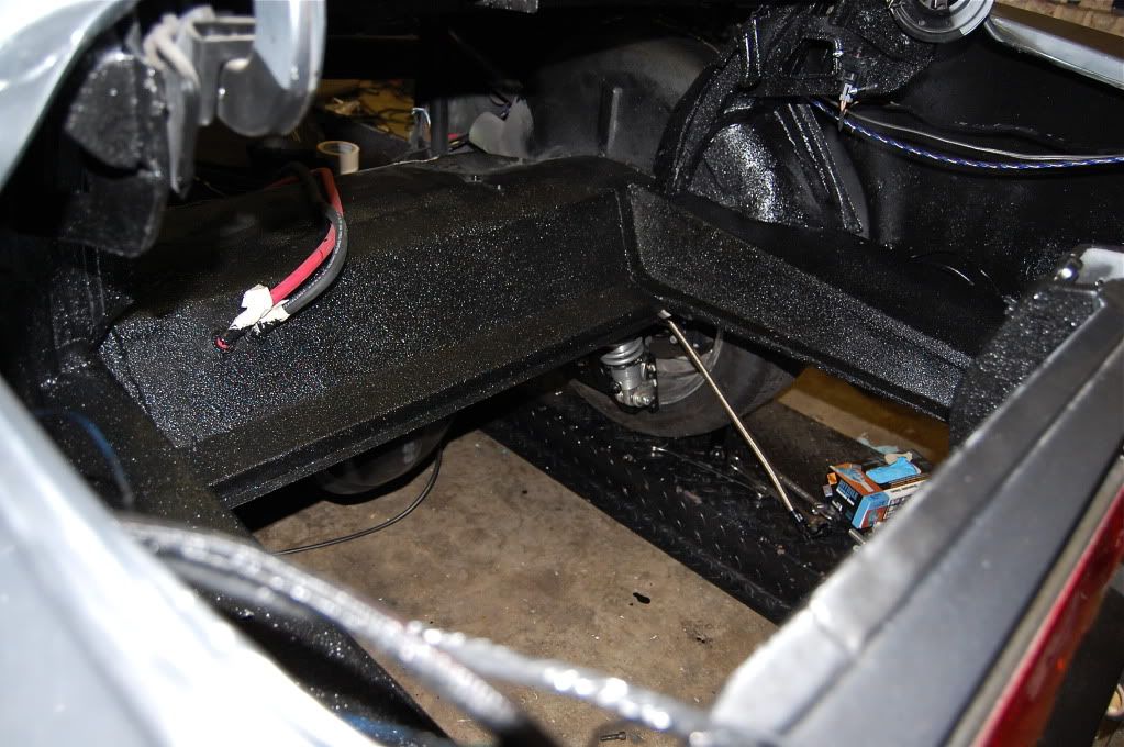

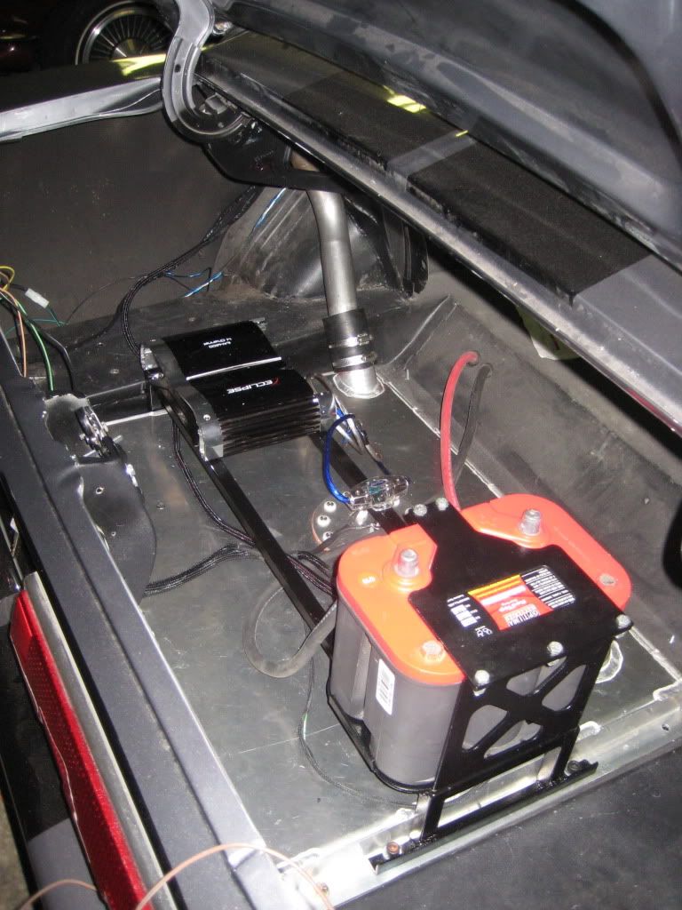

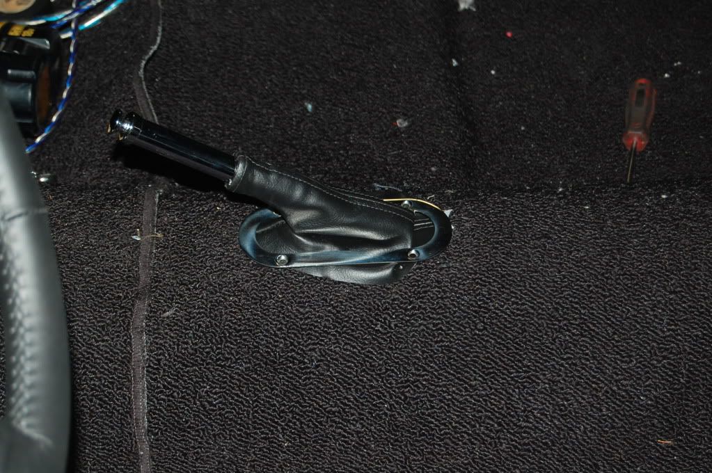

Made the bracket to go over the tank that holds the amp and will now hold the optima battery as well-I moved it from the drivers side of the trunk. Why i put it there to begin with, i have no idea.
Hey look, I made a semi-decent weld.

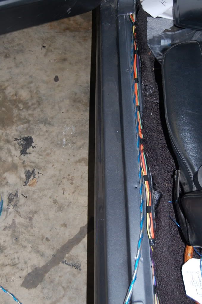

Wiring is now all wrapped up and neatly tucked away.

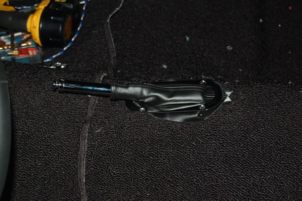

Lokar E-brake handle installed in trans tunnel

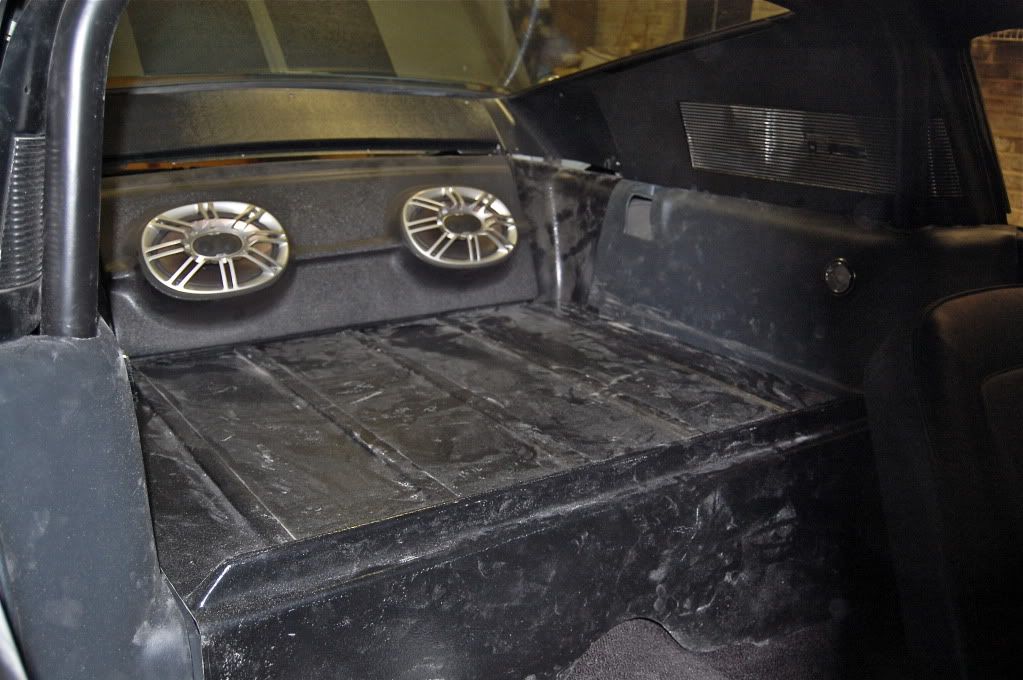

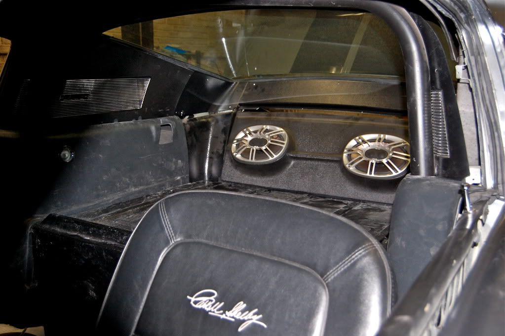

Fuse panel moved from trunk to rear seat area, which will be covered with the 66 Shelby seat delete.
Seat delete trimmed and temporarily installed. Excuse the fiberglass dust. Quarter panels were also trimmed to fit around roll bar.

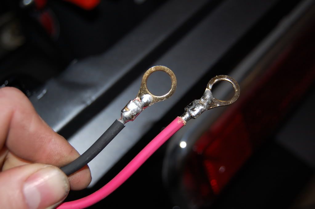

Why the wiring takes so long-each fitting is crimped, then soldered, and then I put heat shrink over the wire and connector.

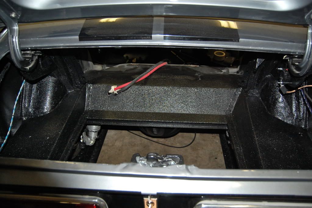

Had to remove the fuel tank due to some issues, so i went ahead and put herculiner on the trunk floor and then rolled the quarter panels and outer wheel housings with satin black paint.

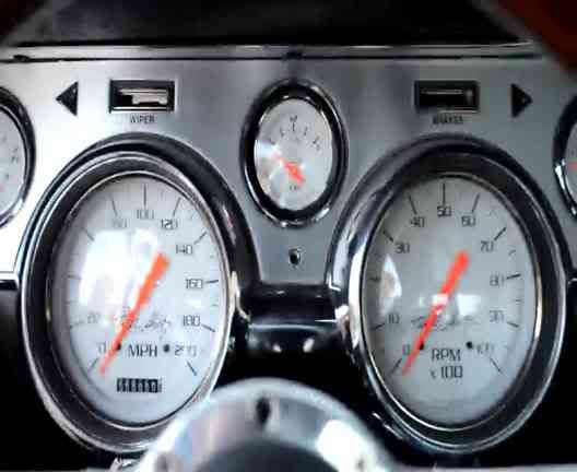

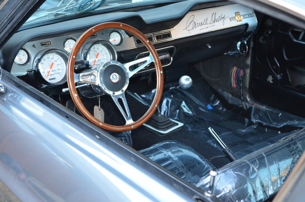

I posted a video after the photos. It looks like a photo, but if you click on it, it will play. I'm using a new camera and i am still learning its features, so excuse the initial focus and the focus when i move from the interior to the engine bay.
After twelve hours of trying to make the front exhaust pipes myself, I threw in the towel and took the car to another exhaust shop. This shop had the front pipes fabricated in less than a day and they look great. The mufflers are now installed, but i still need to add flanges to the spintech mufflers and to the pipes that exit through the rockers and into the tips.
Just a couple days of work and an alignment rack away from being roadworthy. Now i just need to find a couple of days to work on it.
The plastic you see in the photos is in place to protect the carpet, seats, and rocker panels.
