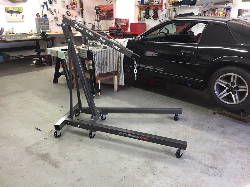

Made some more good progress this weekend. I think I am pretty much done with disconnecting all of the wiring, removed the wiper motor, power steering hoses and the driveshaft. Couple things came up along the way:

Getting closer to being able to pull the motor out. 90% of the wiring is disconnected and I'm working on taking apart the intake to get at the fuel rails and a couple of electrical and vacuum connectors underneath the plenum (man this Super Ram has a lot of pieces and bolts!)
