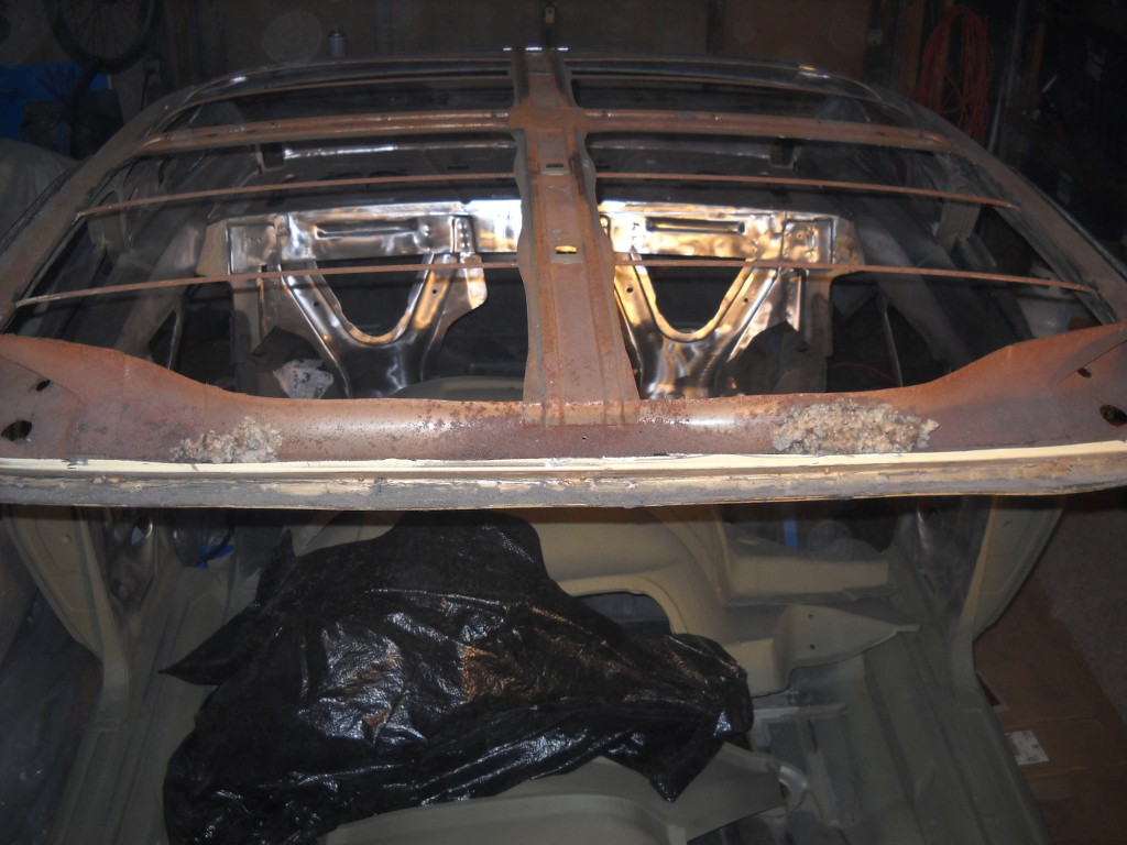

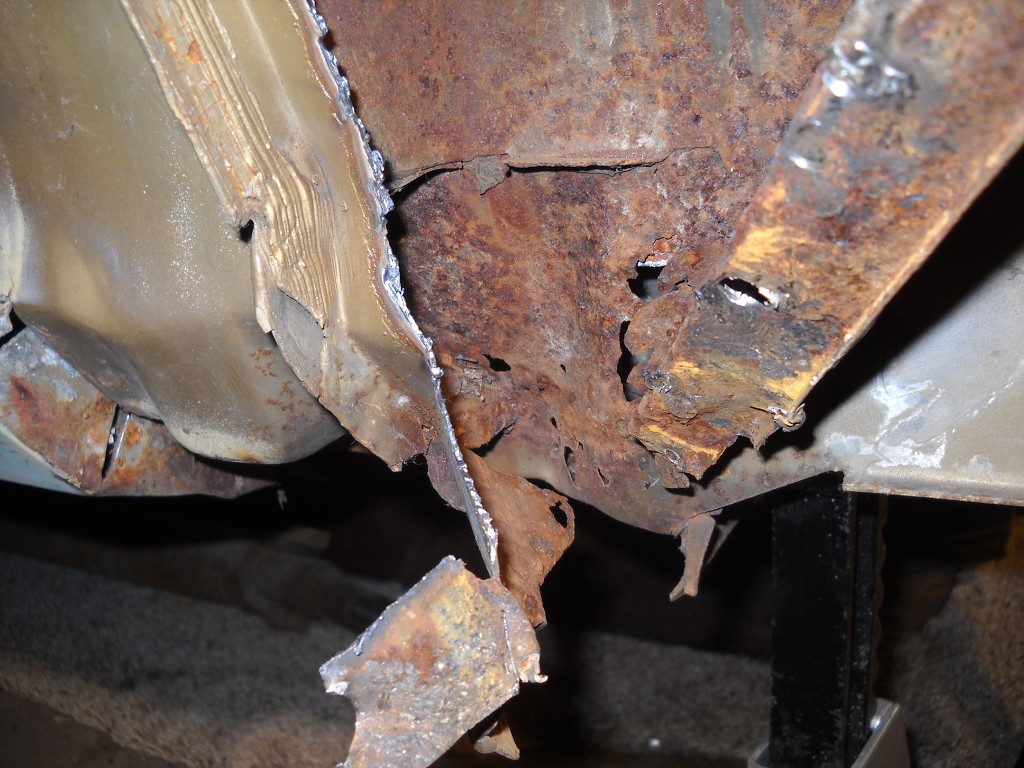

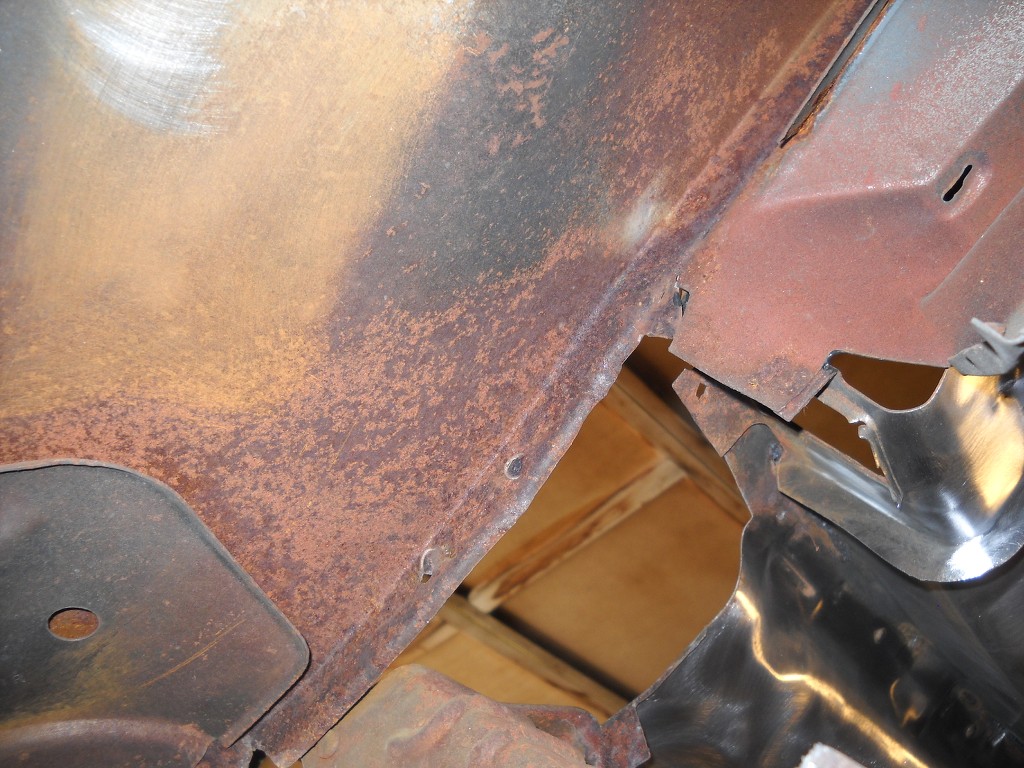

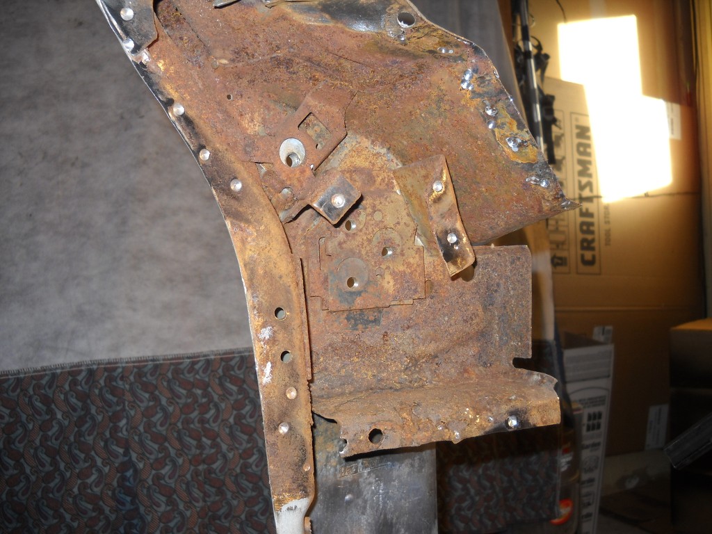

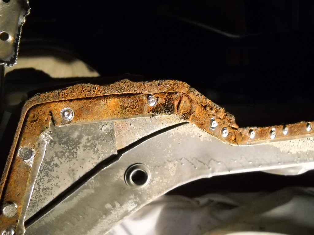

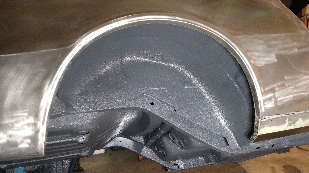

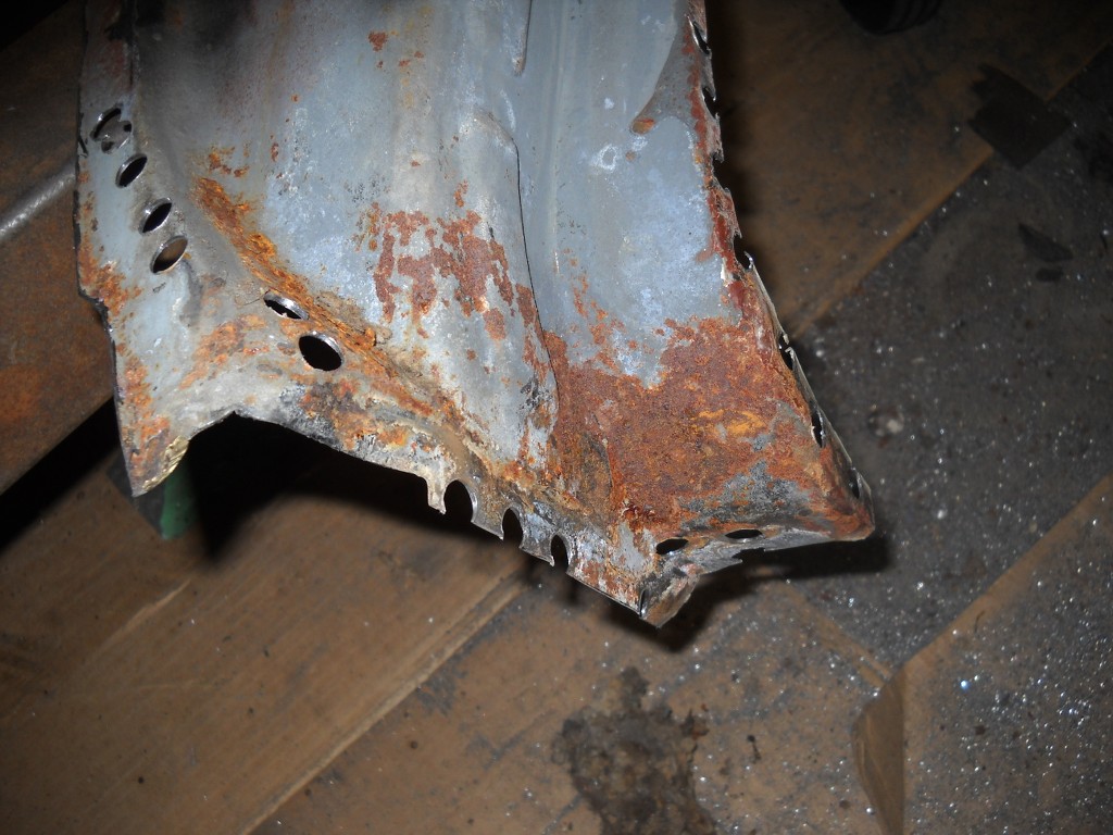

Was looking back at the RUST my Camaro had when I started I thought I might share some pics in case some of you hadn't seen the beginning ....
If you think patching a corner of the door will fix the rust think again!!
Looking up into the quarter from the trunk!
The door pillar where a mouse house was sitting on the shelf, yuck!
Yeah seam sealer in the trunk ... what a waste of time!
Big blob of DVM ...
Causes the quarter to rust out .. grrrr!
This pic makes me cringe!!!
Side tulip rust, making me sick to my stomach ....
Both sides looked like this ... yours does too!
IF you don't replace your roof it will keep rusting ....
So that's why my OCD took over and I replaced all the metal ... lipstick on a pig doesn't cover up the pig, lol!
One of my favorite pictures ... post rust of course!
JUST PICTUREShttps://imageshack.com/user/mcavery

Nice work Chief, you are doing it the right way. I'm in the middle of a similar situation on my project. I replaced the entire floor from toe boards to the tail lights. At this rate our cars will out live us.
It's nice to take a step back and recap on occasion. Documenting the build process is excellent because you can see the steps, time and materials invested that gets forgotten once everything looks pretty. For me the odd pause to reflect gives me perspective and makes staying motivated to keep moving forward much easier.

More I explored more rust I found.. ended up with just roof and quarters everything else was cut out and replaced

I'd be suspicious of 'what's under the roof' just saying from experience its not pretty if the rest of the car needed repair!

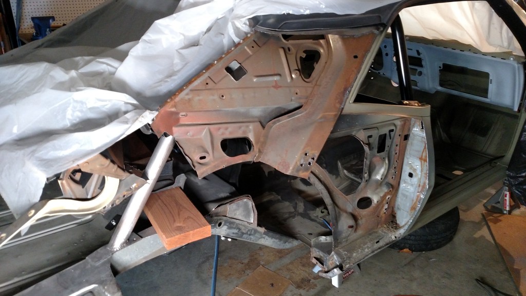

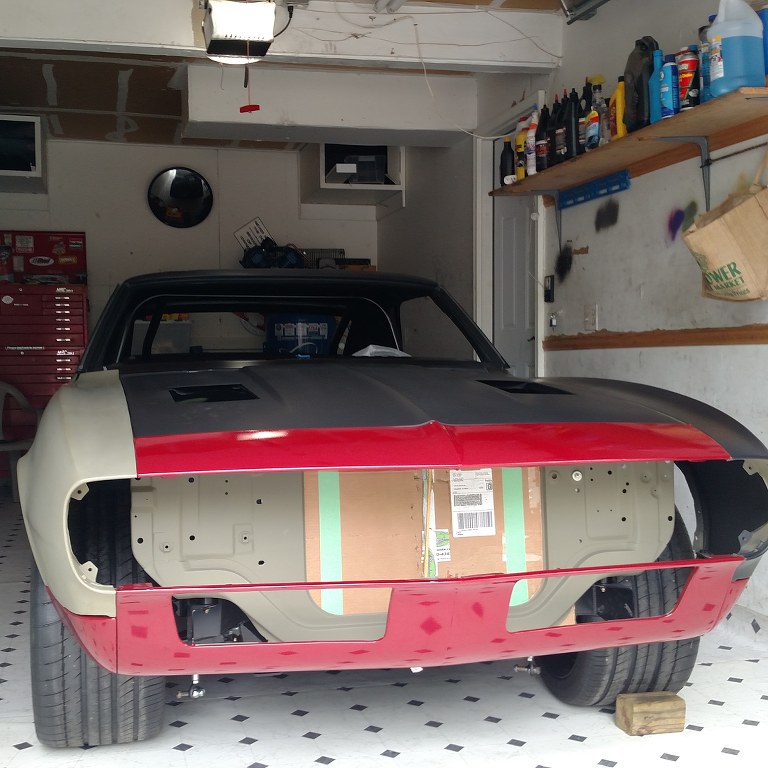

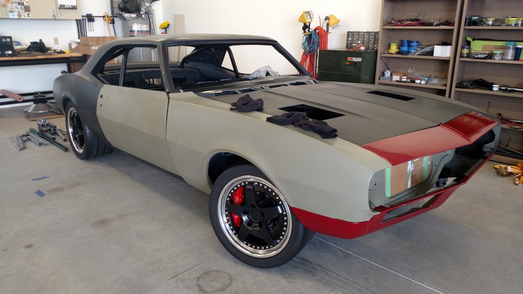

hey isn't that a Dixie Chicks song? My car is finally home, thanks to Kevin for keeping her safe and sound, and only steps away from me now! [insert happy dance] I had to put her on wheel doolies to I can move it from one side to the other and still get a door open. Of course the XR650R has to be pushed outside to move the Camaro. I have been working on final body work, which is not my favorite task, and hopefully get it back into epoxy and then wrap.
I pulled the maroon wrap off the front valance and header, didn't undercoat the back sides, and found out the SPI Epoxy didn't want to let go of the wrap. I came off in little bitty pieces and then left the adhesive which I had to "skin" off with a razor blade, grrr. So a call to SPI and he suggested I clear coat over the SPI Epoxy to provide a barrier to the wrap. After all, clear is nothing more the paint w/o pigment.
Knowing my limits I have a body man coming over next week to look at what needs to be done to get the doors and the front sheet metal aligned and looking as good as the body tub. Meanwhile I'll finish the body the best I can and start with the mock up of wiring [AAW 15] and A/C [V/A]. I ordered Speedtech tubs and engine down bars, and sent my Ididit column back to get shortened, thanks Jay, for working with me!
Well, here's some car porn for your viewing pleasure, and yes I sat out the shed and petted my car when she came home, missed her bunches!

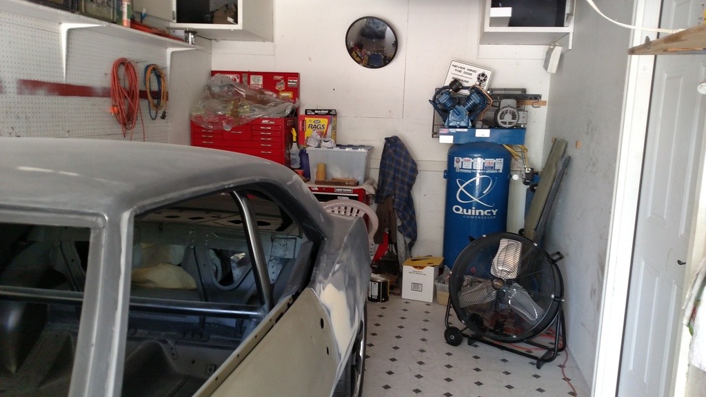

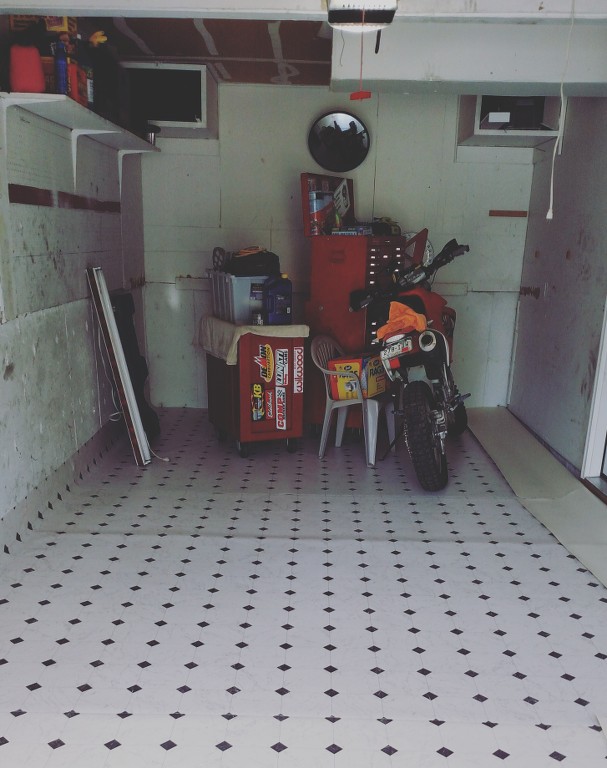

Got the shed cleaned and started laying down some vinyl flooring …. she deserves better than a greasy ol floor!
Pulled out of Kevin's car hauler!
After some "redneckery" loading she's home
Not a lot of room, but we all have to work with what we have!

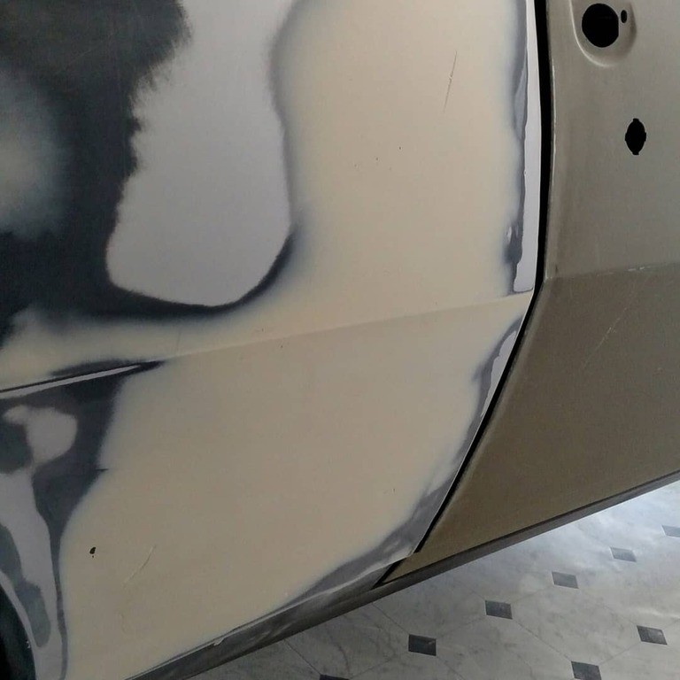

Started sanding down the SPI epoxy and added filler to getter straight … as I can!
Working on the hood today, half done!
