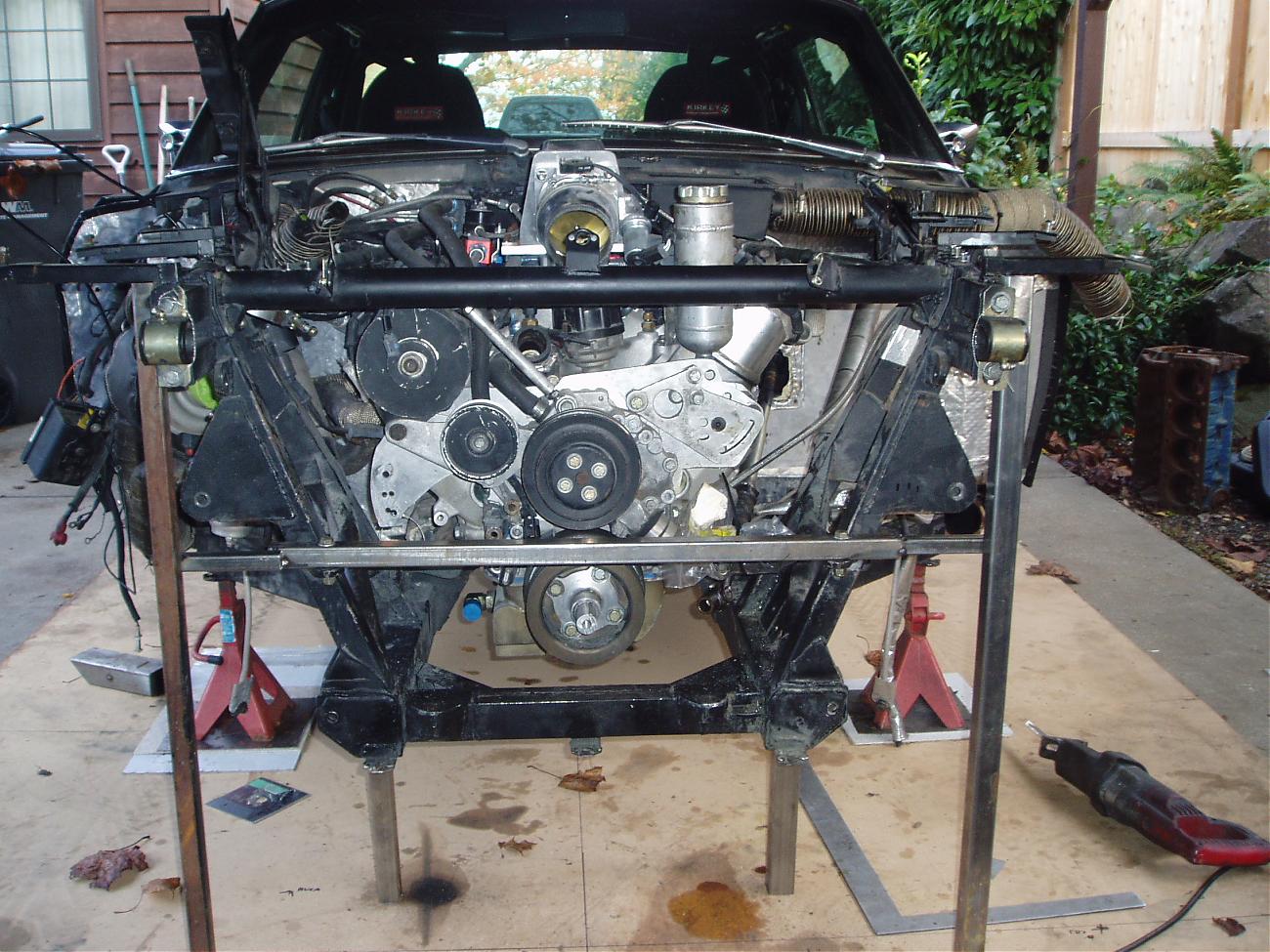

1) building a frame jig on the old chassis to maintain alignment. You can see I am using my $35k blanchard ground 1" thick tool steel chassis table.

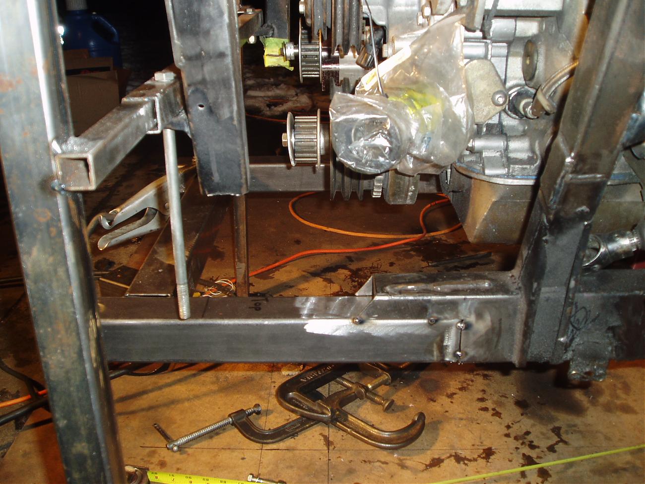

2) Starting work on building the new frame stub. One trick I learned when butting tubes together is to "cap" one of the tubes so you have a solid internal gusset and a good seam for really getting good weld penetration. You can't see that cap in the photo I'm just calling it out.

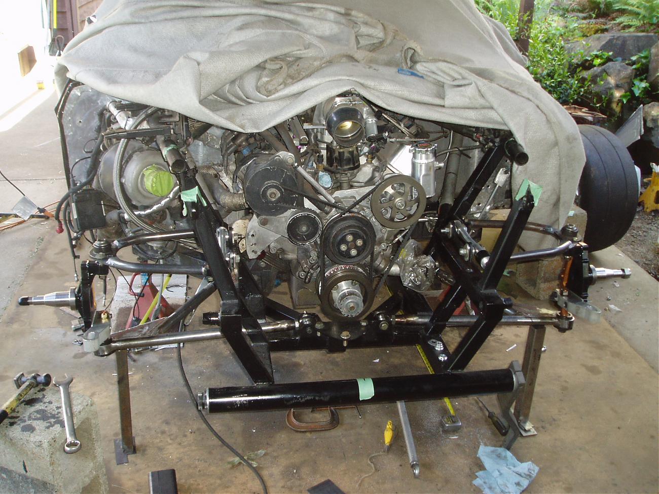

3) A good picture of how long the arms are and how close the pivots are. To my eye it would look better if that sway bar tube was gusseted at the ends but I need that real estate for turbo piping, and the DOM tube should be plenty stiff.

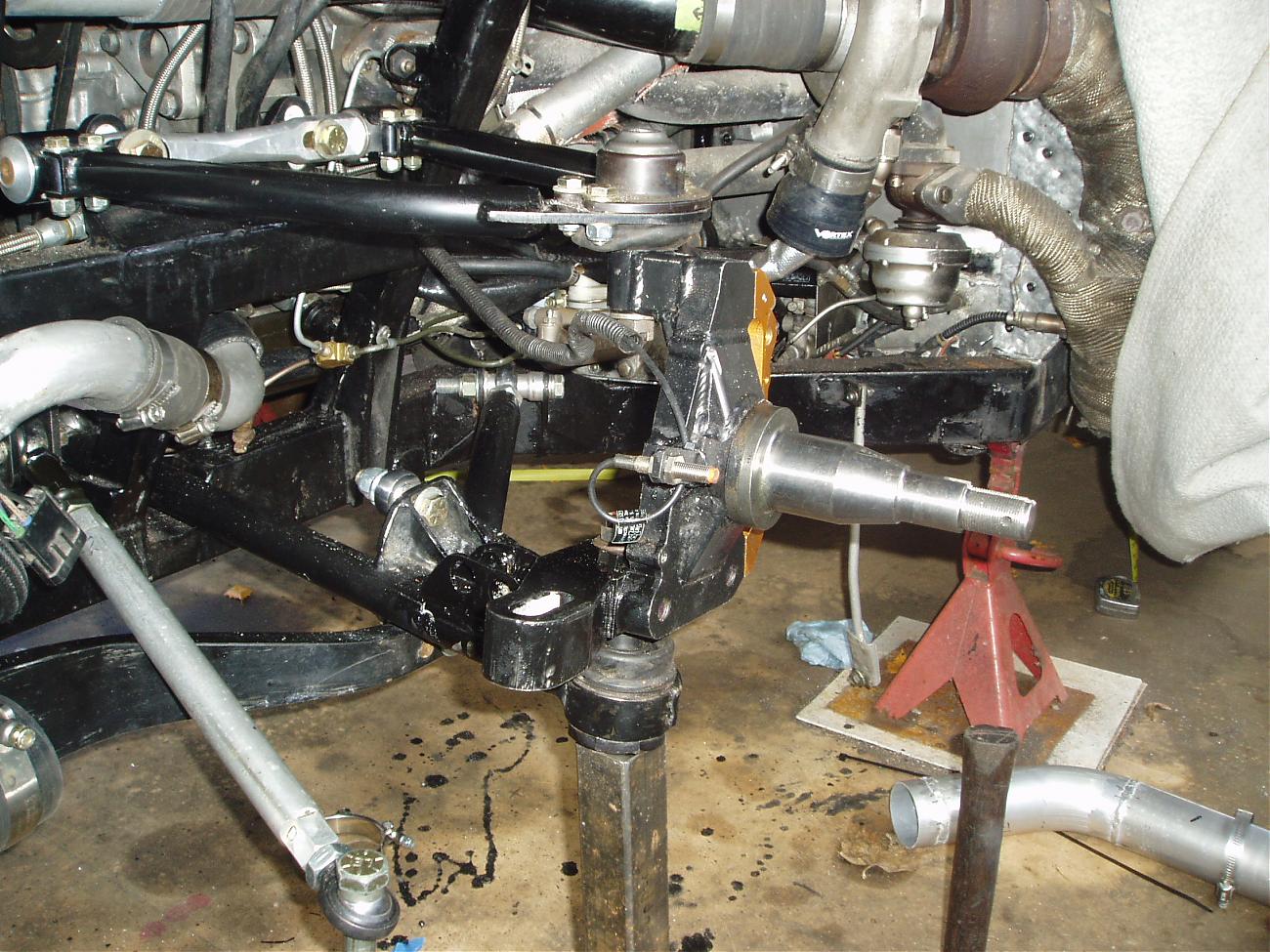

5) A picture of my upright with the wheel sensor attached (RaceLogic traction control). Be careful with those sensors they are $130 apiece and I managed to damage two of them while rebuilding hte front and rear

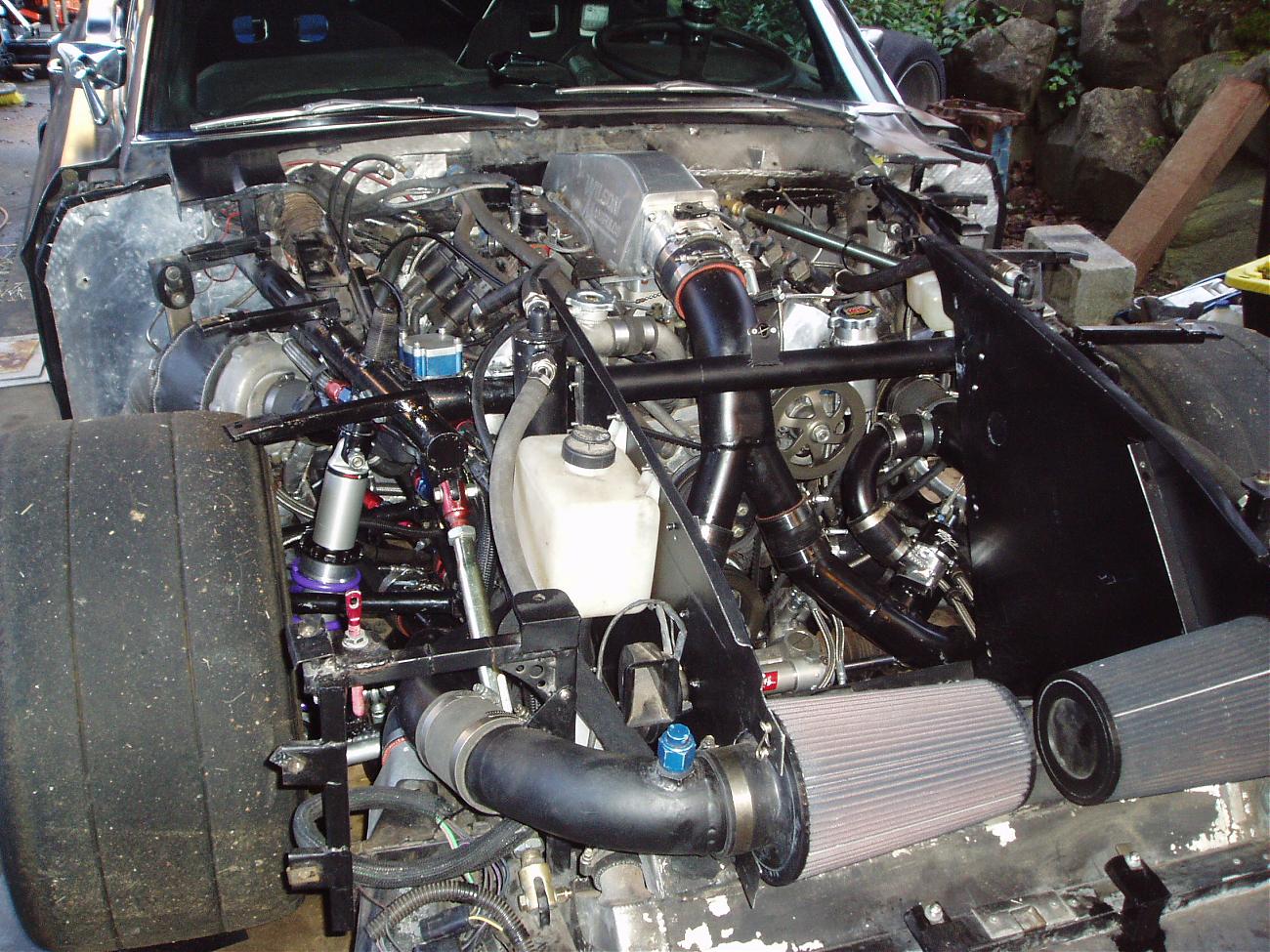

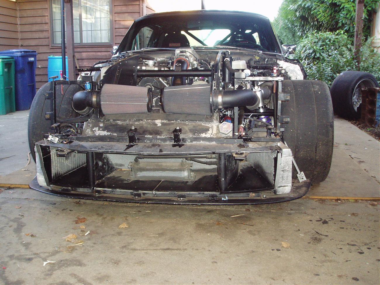

6) A couple shots of the car before the body goes back on. Hard to believe how much turning radius I have, I was amazed when I drove it I thought it would be pretty limited which is very annoying for a daily driver (ha).
