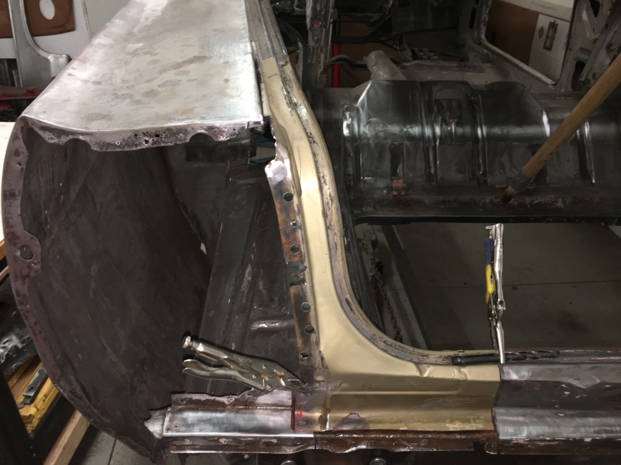

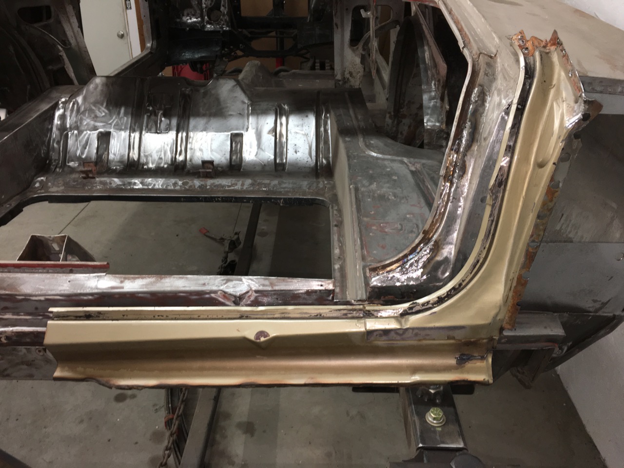

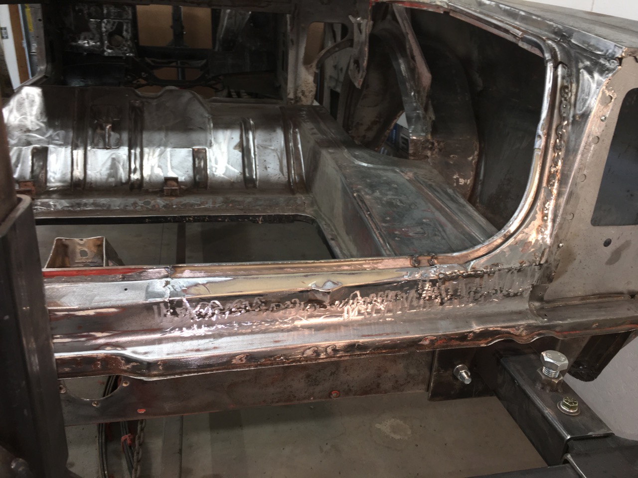

Thanks for the sentiments guys, I just take each day as it comes, some are better than others.
I was able to get a few more hours in, almost all the rust is cut out now.
Putting in subframe connectors to hold it all together
Fixing cowl, firewall and floor pans
joe
Semper Fi
My 68 Torino

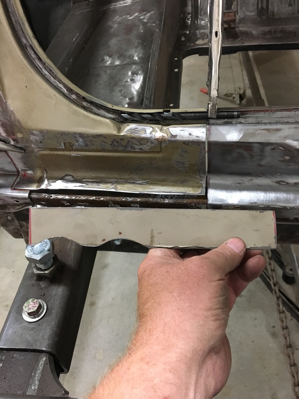

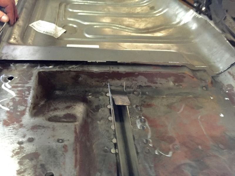

Apparently I just gawk at other folks projects and never post any progress on mine. Maybe because I am always building pergola's our yard work?
I haven't got much done in a year, mainly because sheet metal work is frightening
Jody really needs a MIG welder Smilie
So I had to go to the salvage yard because my trunk weatherstripping channel was rotted out. I found a 69 Fairlane which was helpful because it also had the tail light sheetmetal in it that I wasted a week on making and didn't get quite right.
I started with the passenger side that drops down along the trunk, tedious and stressful.
joe
Semper Fi
My 68 Torino

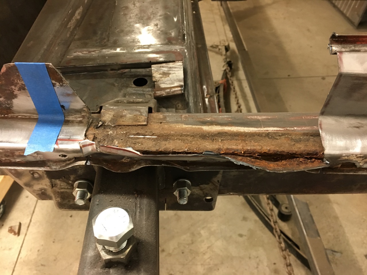

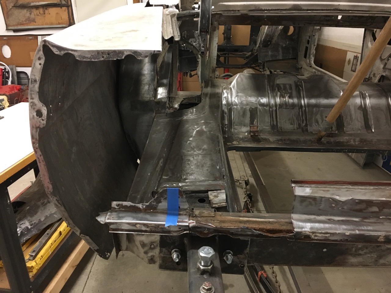

Then feeling confident I moved along to the driver side, but I found rust in the "so called frame rail".
joe
Semper Fi
My 68 Torino

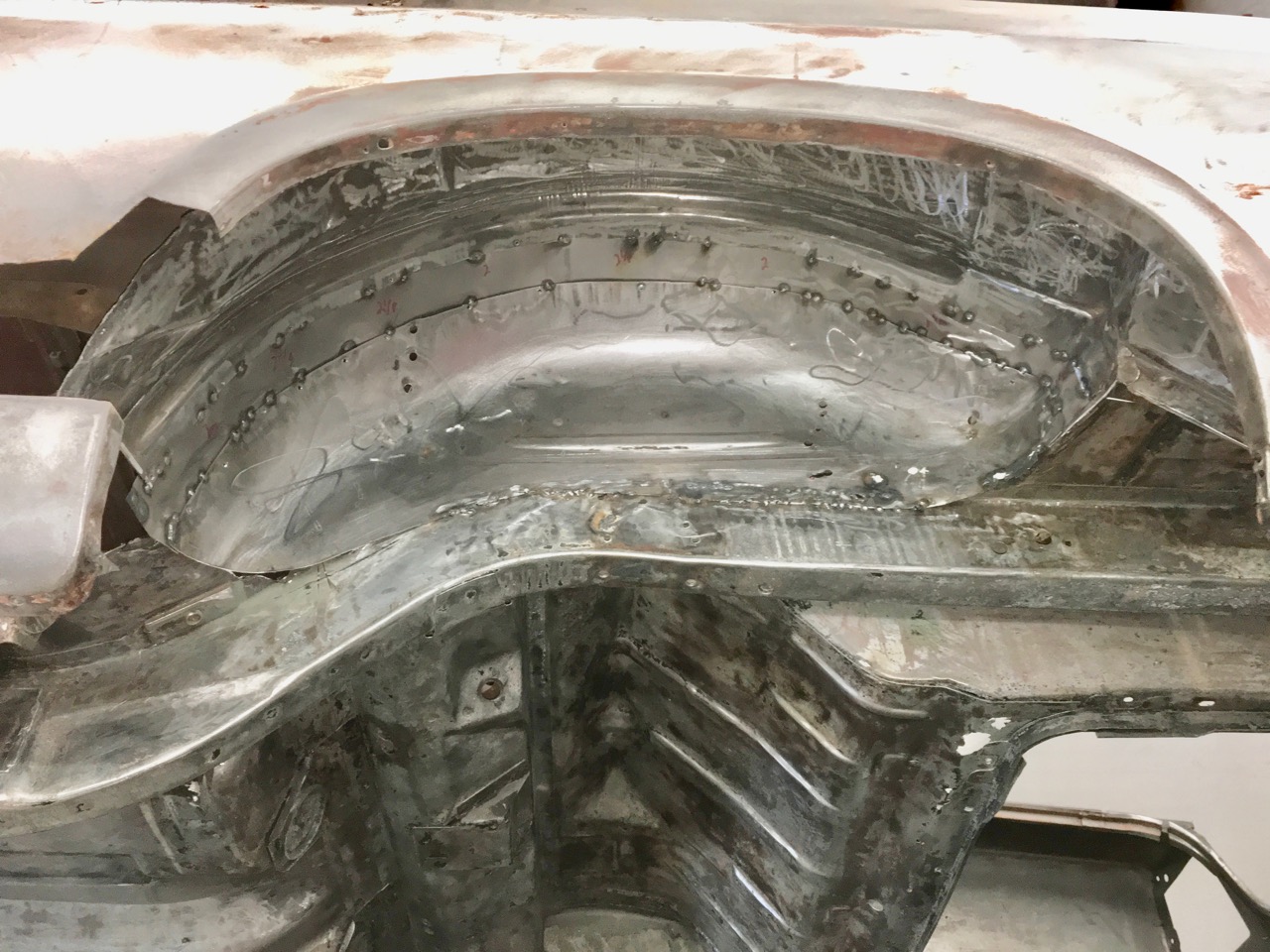

I had to clear ou the rust in the rail. make a pattern and then a patch out of the salvage yard metal and by then I was concerned about welding that corner up without the trunk lid on...
So I did what any amateur fabricator would do I moved on the the wheel tubs and left this for another day until I grew a bigger pair.
joe
Semper Fi
My 68 Torino

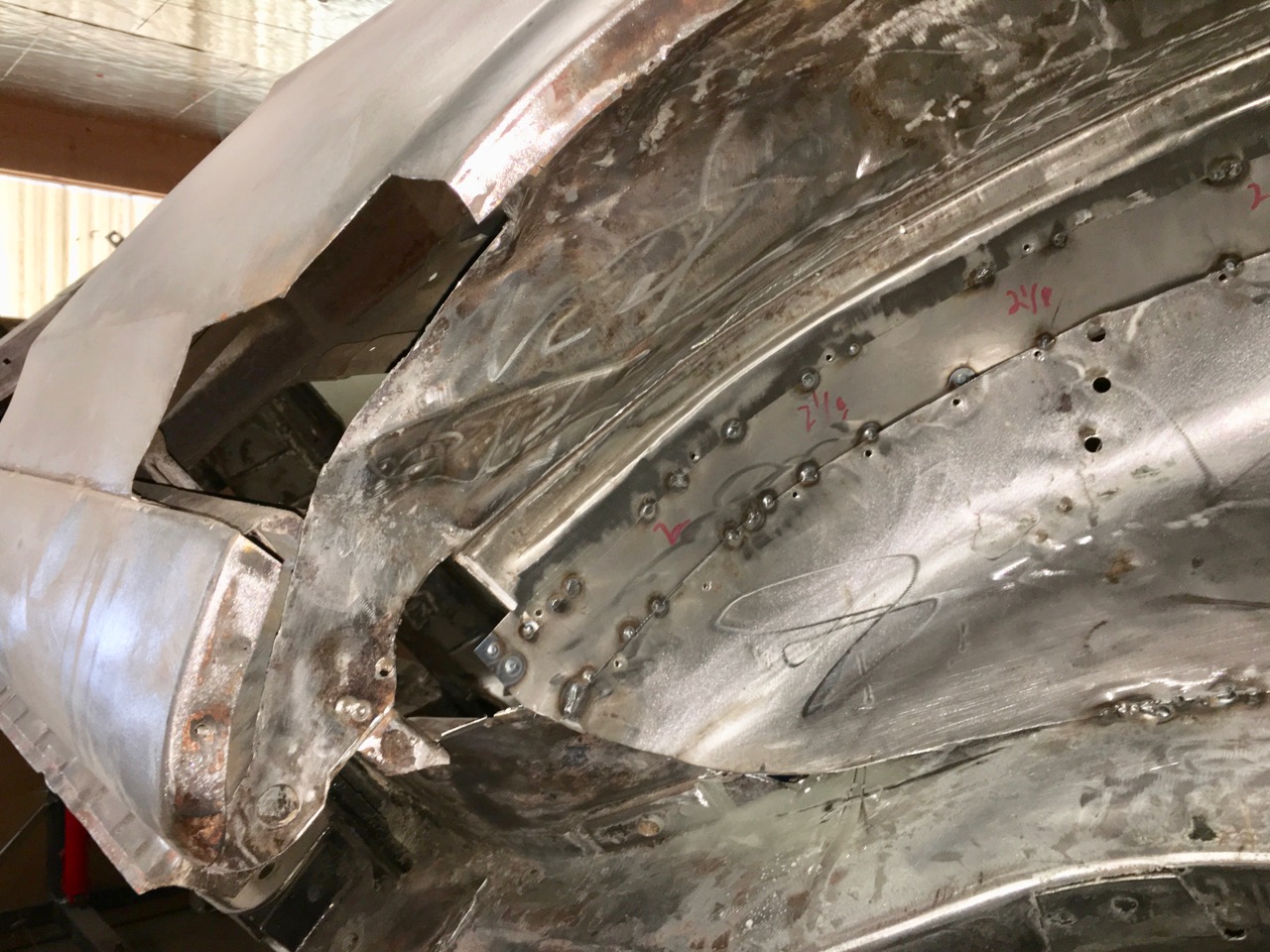

Since I had already cut the inside wheel well out on the driver side I started working on it. It was 40* in the shop so I got it tacked in place and had to quit. There was some pattern making I forgot to take pictures of during the deep freeze but I did get some pictures.
I did some measuring and I am confident I can get a 305/35-18 in here, Maybe a 19 if I find the right wheel that I like. I am kind of set on a "steelie" look..
Hopefully I can get back out the soon and do some more welding.
Joe
joe
Semper Fi
My 68 Torino
