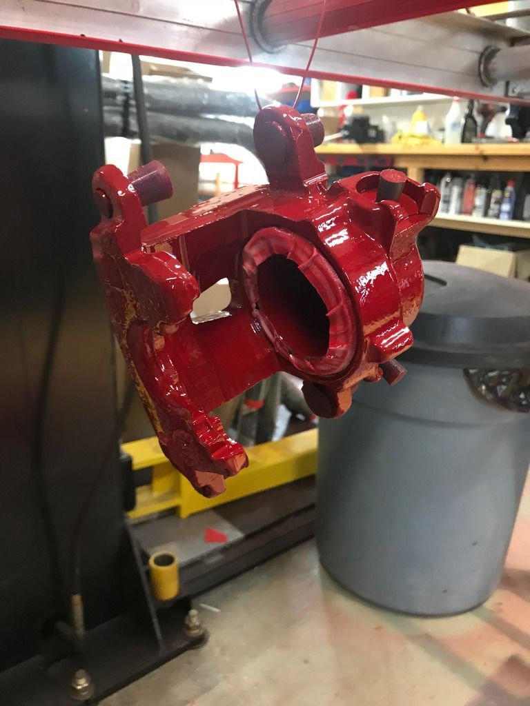

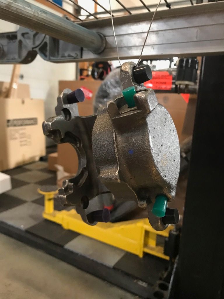

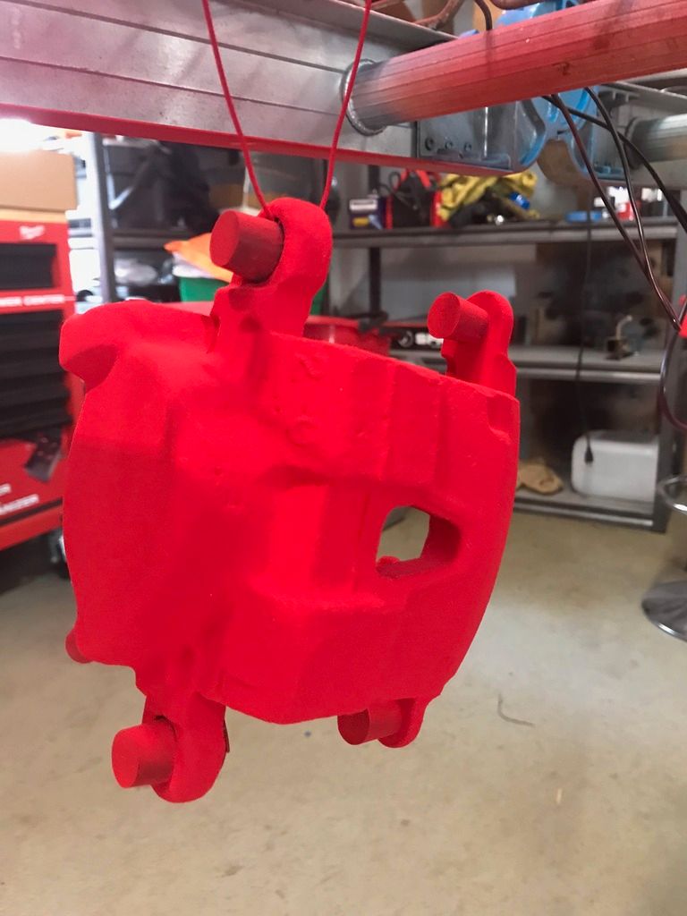

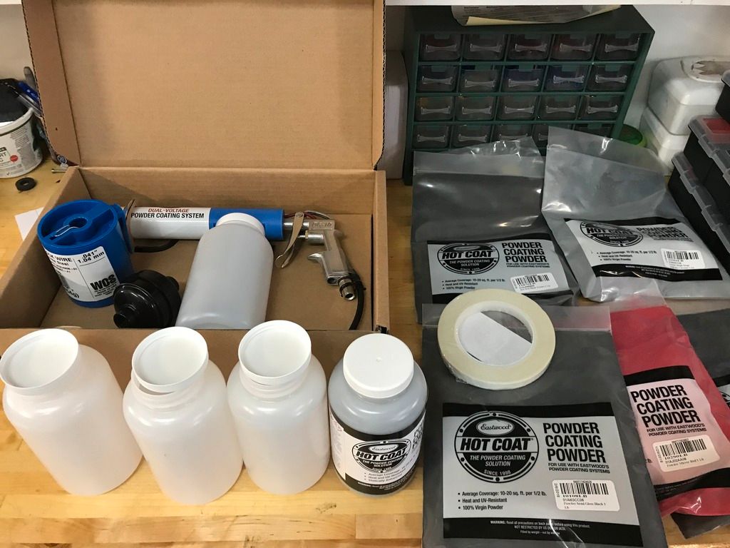

OK... for those of you that may be interested in powder coating at home
I've always wanted to powder coat stuff myself as I'm fed up with taking parts to my local guy and spending a small fortune and waiting for the sh!t to get done. So I made a little investment ....
Eastwood starter Kit ... $165
5 more lbs of powder ... like $70.00
Nice oven off Kijiji ... $150
Panel breaker/electrical ... $60.00
Total ... Under $500.00
Result ... awesome !!!
This was so easy, should have done this a long time ago but I was a little intimidated.
Kit has it all, bag of plugs, heat safe tape, hanging wire etc.
Approx 13 mins at 450 degrees until it flows, then 20 mins at 400 deg. to cure

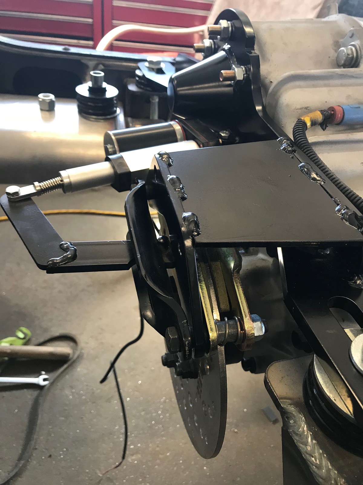

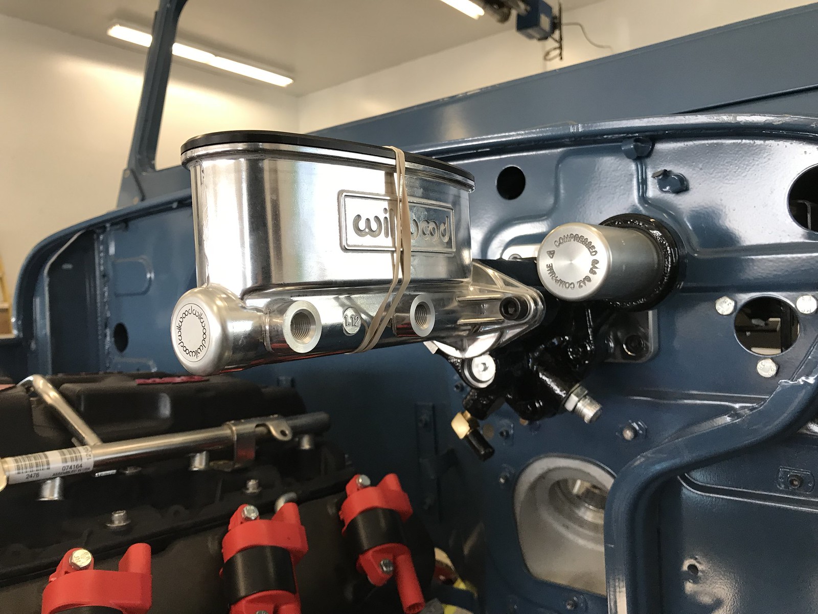

Super cool electric parking brake with a 200Lb actuator
IMG_8021 by Steve Heck, on Flickr

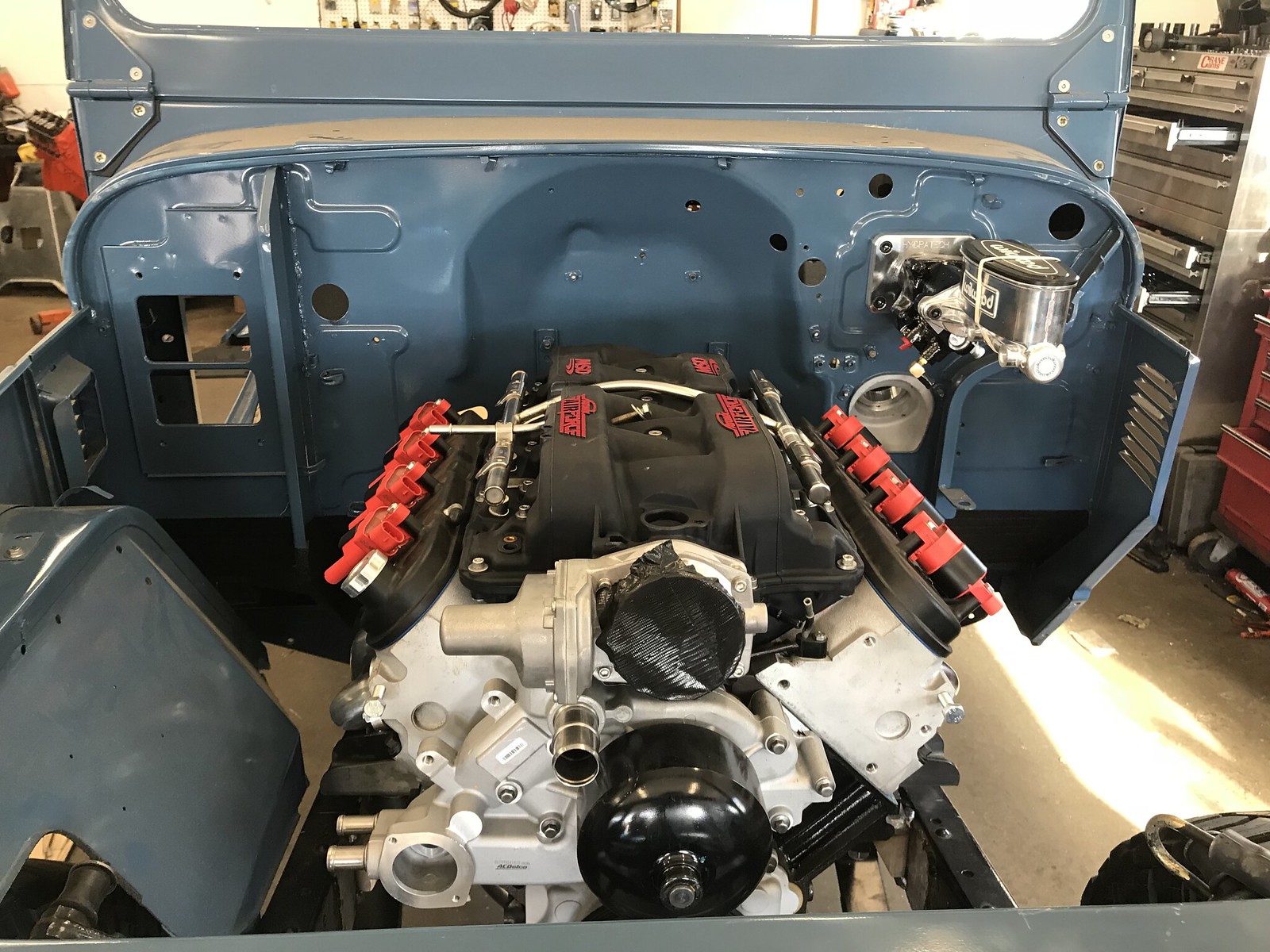

Engine with new MSD intake, and BIG thanks to the guys at Hydratech for the sweet custom boost unit !!
IMG_8037 by Steve Heck, on Flickr
IMG_8034 by Steve Heck, on Flickr
Got the stance just right
IMG_8038 by Steve Heck, on Flickr
Its ALL in the fine details ....
IMG_8041 by Steve Heck, on Flickr
IMG_8030 by Steve Heck, on Flickr
IMG_8013 by Steve Heck, on Flickr
