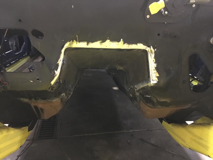

Firewall view of the forward trans tunnel mod...raised enough there should be plenty of room for engine setback and still have easy access to bell housing bolts and running the ECM harness down the back of the engine...
