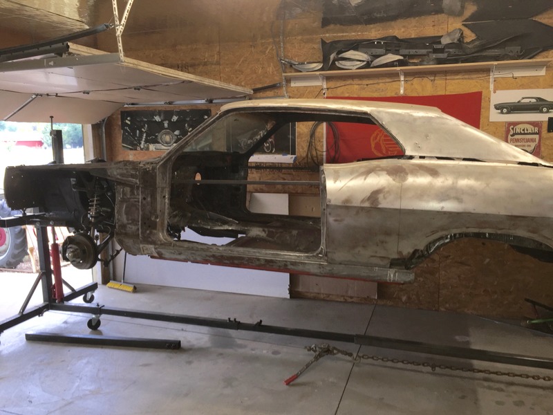

Has anyone used one of the "Hooker Headers 71223008"
http://www.jegs.com/i/Hooker-Headers...23008/10002/-1
I have a TKO600 and was looking for something "easy" to cover the hole. I have previously covered it with a fiberglass patch I made.
I cant seem to find a picture of this thing covering a T-56 or measurements of it.
I have the floors out of my 68 Torino and was going to make something and this looked like a "solution".
You can "sort of see" the missing floor :-)
Thanks, Joe
