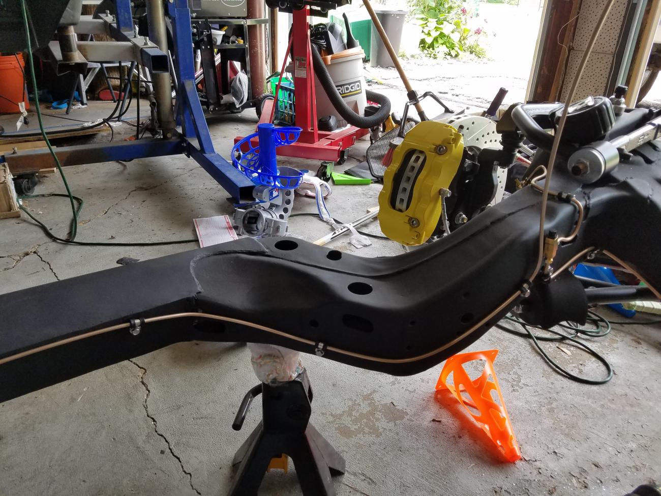

I also bought all the brake line fittings and decided to try my hand at running brake lines. I used nicopp 3/16 brake lines and think they turned out damn good for my first time bending and flaring. This stuff is great to work with. This is pretty much where I am at now. Wheels are on order and should arrive at the end of August.
