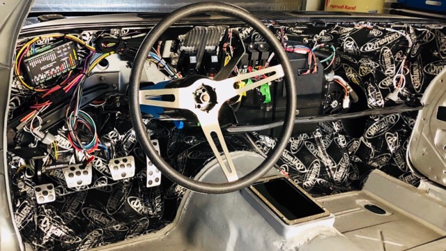

I also have my ricks stainless tank, that I'm running the PressureWorx fuel module control system. I might of over though this fuel setup but after speaking to Carl at vaporworkx it should run flawlessly.
Finished up my wiring under dash and started working on my rear interior panels for the mini tub stretch.
Basically waiting for my motor from engine shop so I can install my drivetrain, then back to bodyshop for final body work and paint.

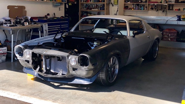

I threw some sheetmetal on the car to get a look at the wheels. I'm happy I spent the money on the Forgeline's, the quality looks incredible!

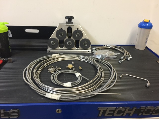

I installed stainless lines for fuel and brake lines and bought everything from inline tube.
I picked up a, K Tool Professional Brake Flaring Tool Kits 70081 from Summit Racing and it made flaring the lines a snap. Also had to order a brake line straightening tool as the lines come coiled up for easy shipment.

I’m running 275 35 18 upfront with all original sheetmetal. I won’t have full lock to lock steering but seems like more than enough to be practical.
