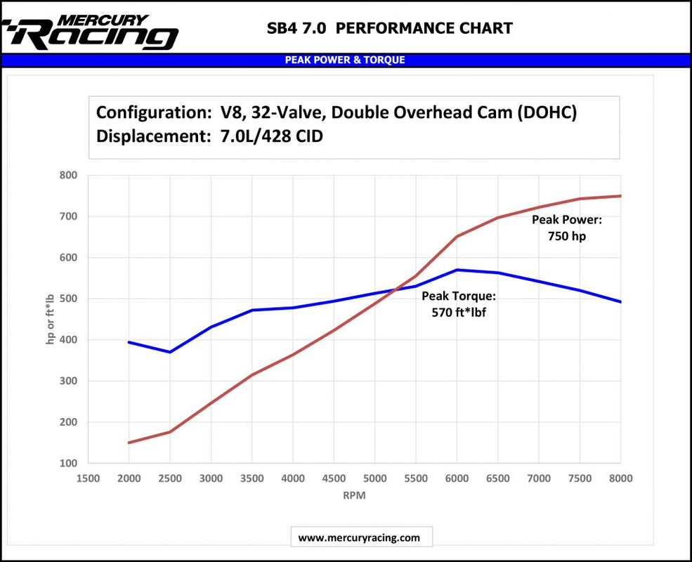

- LS7 reinforced block
- Callies Dragonslayer crank
- 11.7:1 compression - custom Mahle Pistons
- Carillo rods

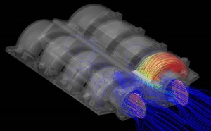

-Custom heads/intake designed by Mercury Racing using computation flow dynamics and cast by Edlebrock(heads)
-Twin 80mm TB's
-a bunch of other goodies to survive regular sprints to 8,000 rpm
-hp/tq figures are on 91 oct

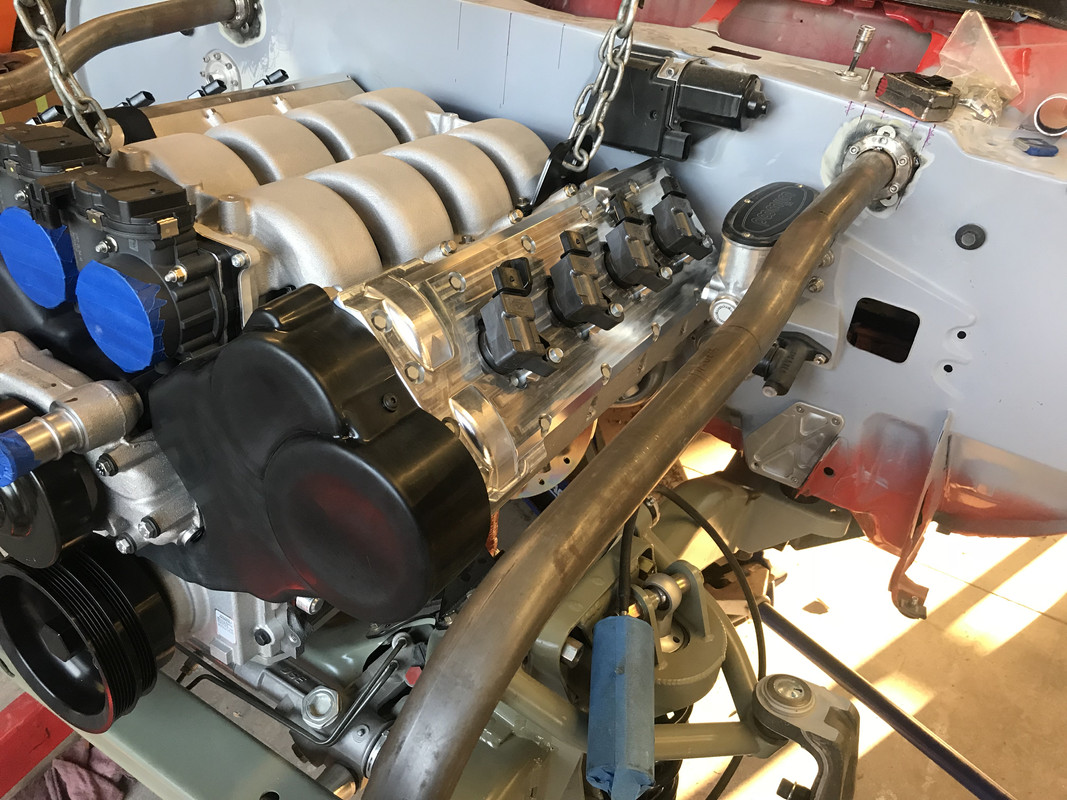

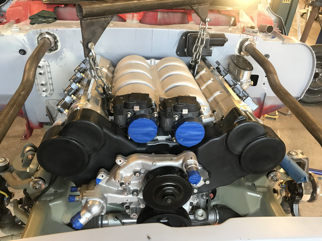

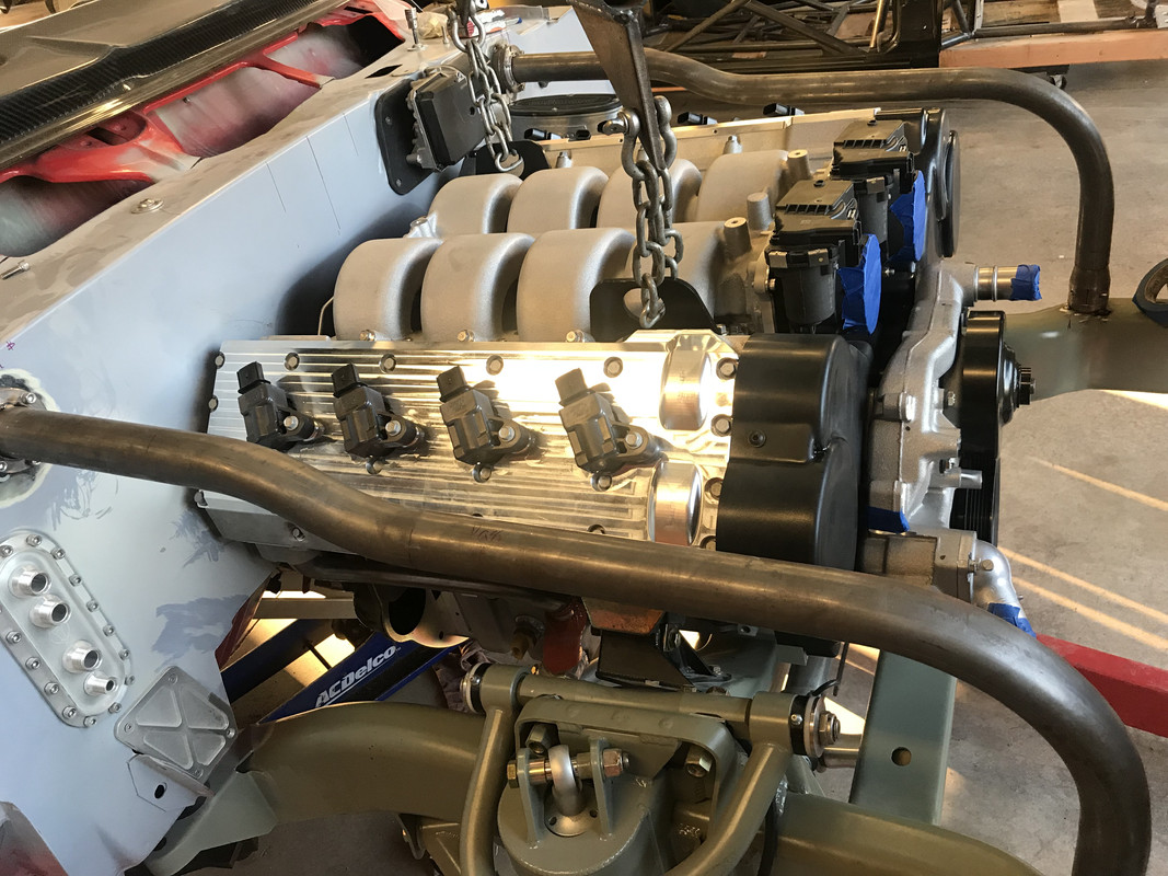

Test fit..not going to be able to use the set back motor mounts with this one.
