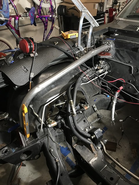

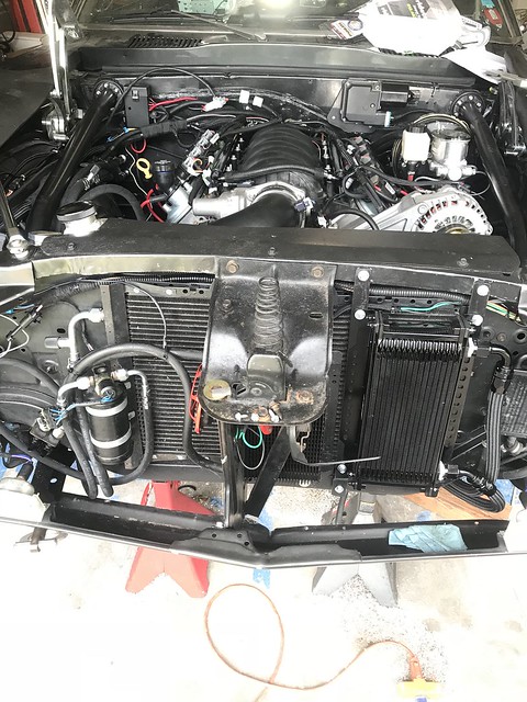

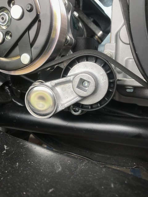

I had to add about 1" of spacers (provided by Ron Sutton) to relocate the sway bar to clear the balancer and the AC tensioner.
Added oil cooler/thermostat, and changed out the AC lines to EZ-clip hoses.

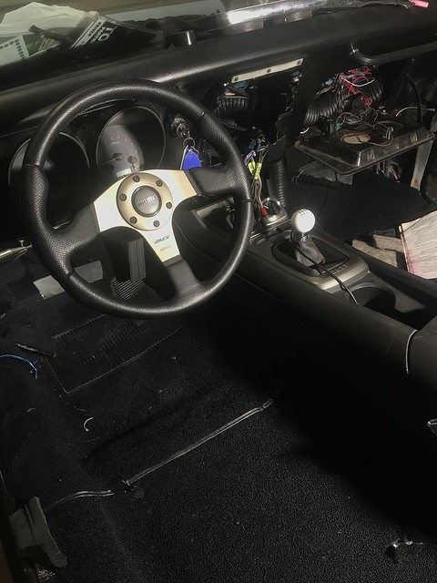

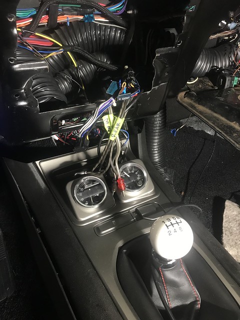

Put back the interior, and mounted the console for good. I added 2 new gauges to the console - oil temp gauge and fuel pressure.

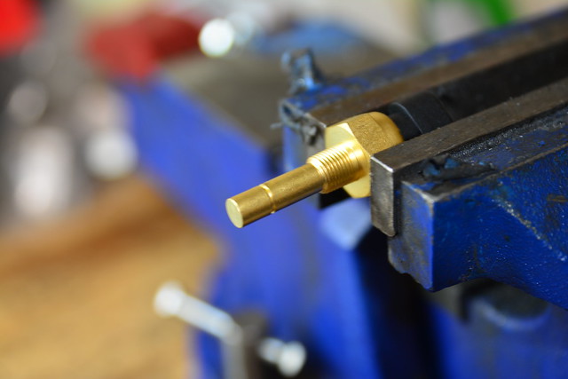

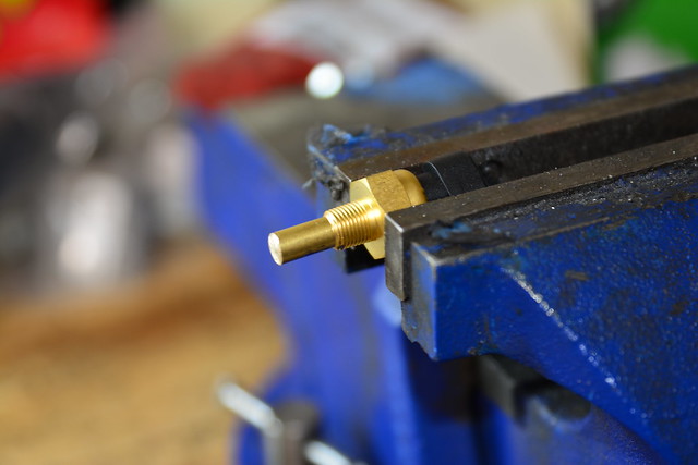

Had to cut down the temp sensor probe in order to fit into the Earl's oil cooler adapter.

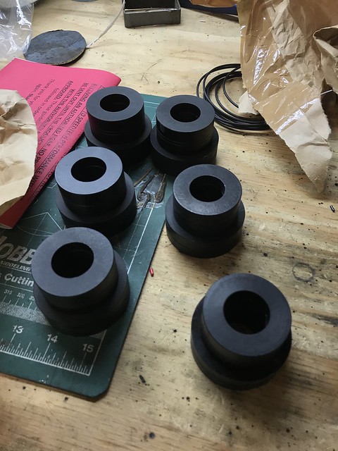

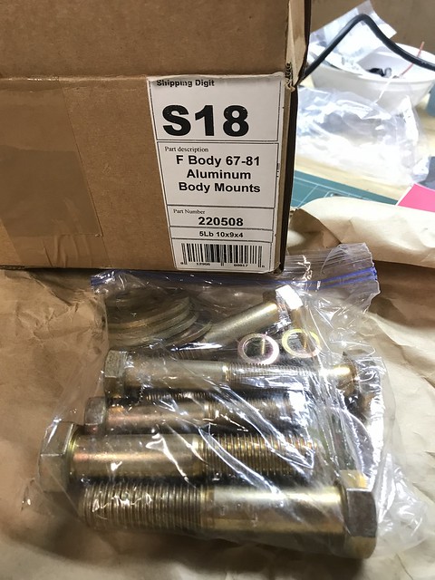

Switched to Speedtech solid body mounts, and had a buddy bend up engine down bars using 1-5/8" tubing.
