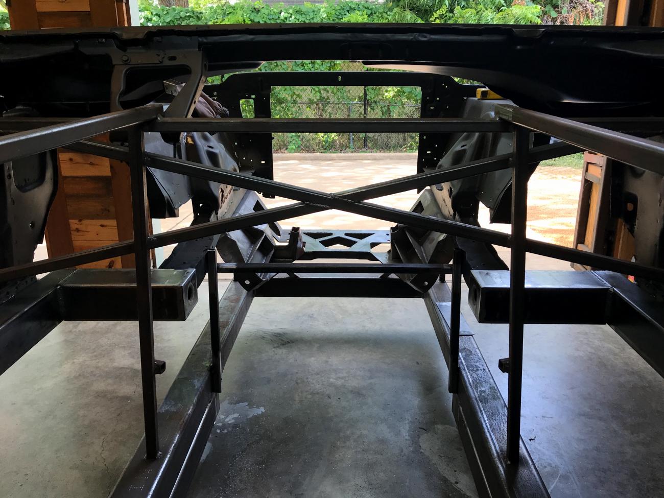

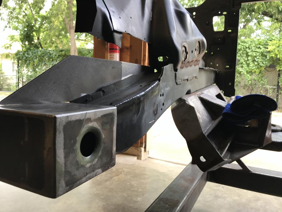

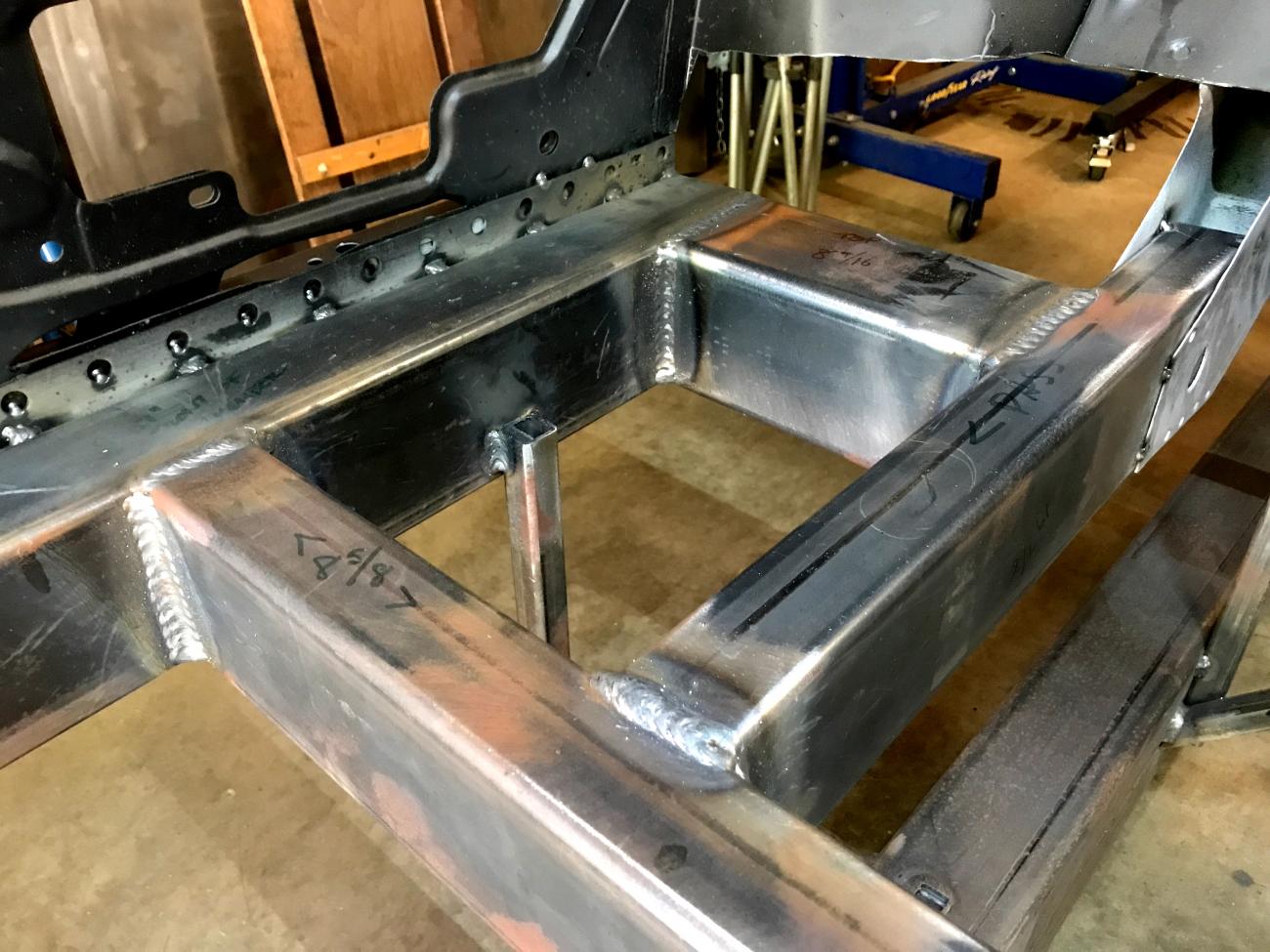

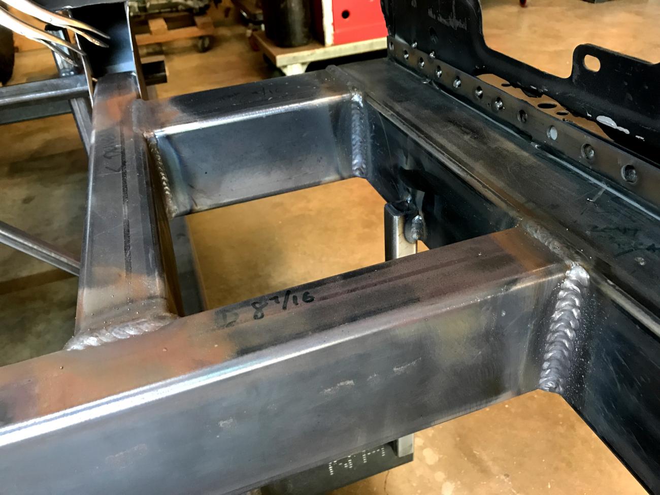

Continued progress building out the chassis.

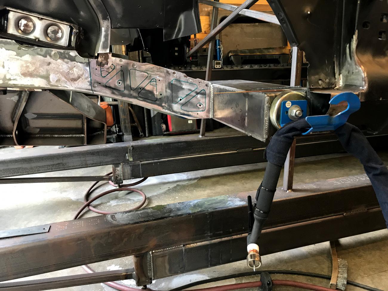

Front and rear "torque boxes" are burned in and now one continuous structural member from front to rear. I took my time with setup and welding so everything stayed level and square. I'll wire-wheel and blend all the MIG welds later.
Next up is the front frame expansion - looking to make a stronger connection between the front rails and the torque boxes, improving rigidity, and transferring loading to the (not yet built) inner rails and rockers. There's a lot of pock marks in the frame, so I'm filling with my TIG and smoothing as I go.

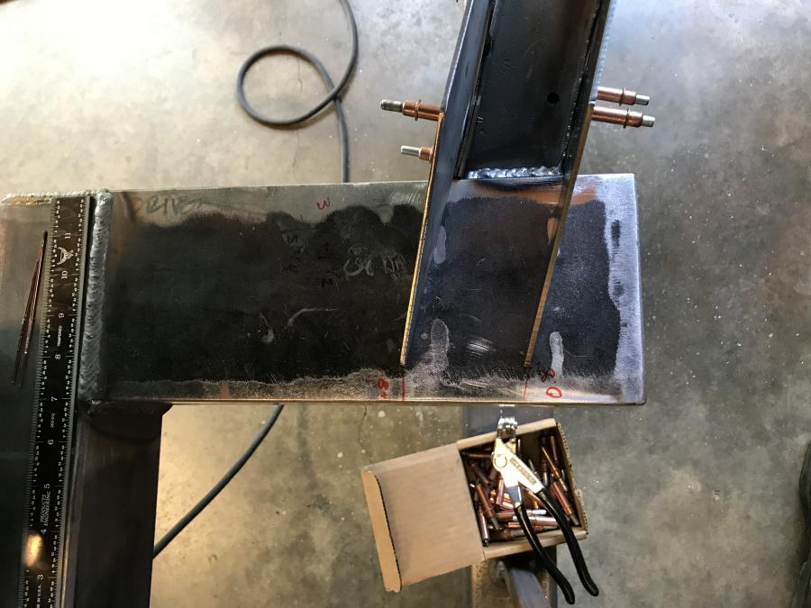

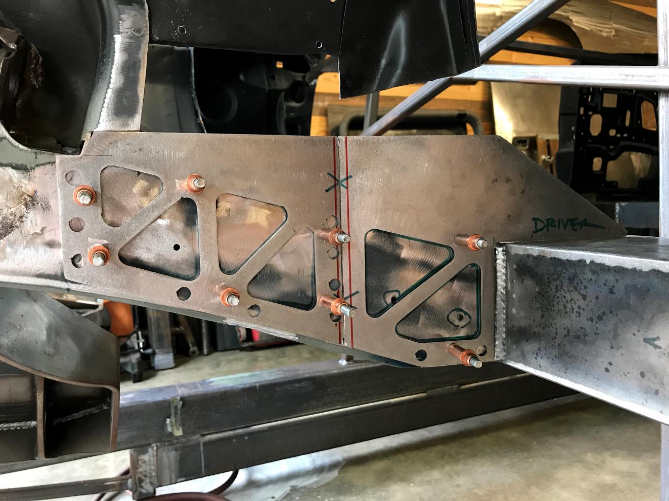

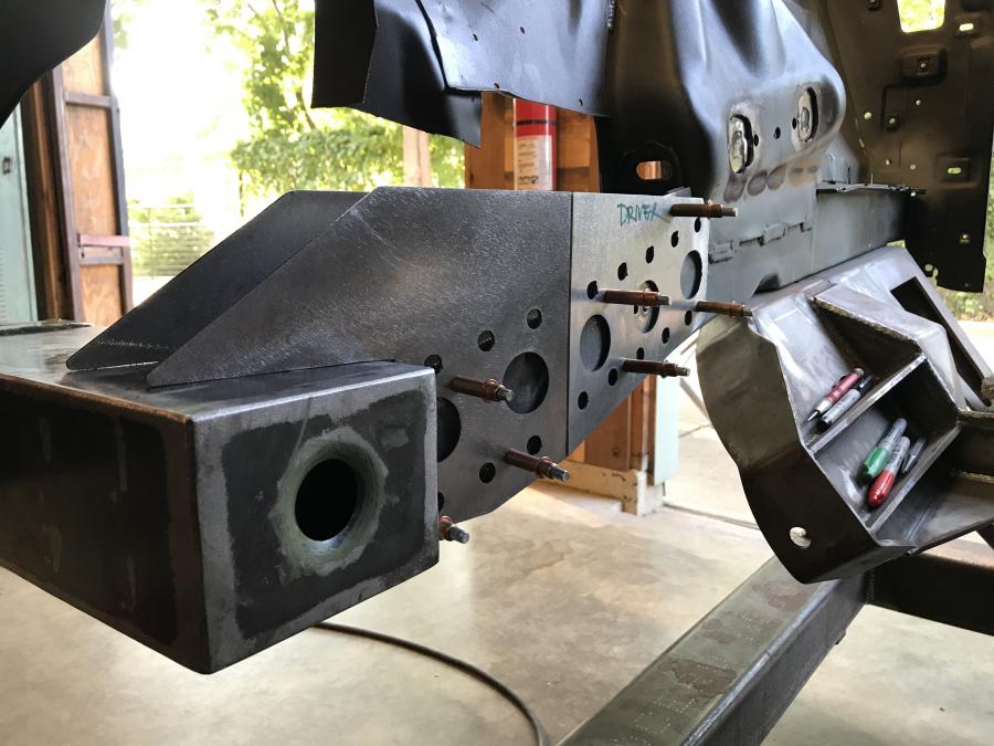

Last night's progress - passenger side interior plate is in, and inner plate is mocked up. The passenger rail flange is trimmed and welded in preparation for fitting the interior rail plate.
Plate is fit and in. Working with the rails up close like this, it's easy to see the variations in assembly from left and right. It makes it impossible to reference and measure from features, and I have to rely on finding level and measuring from set points on the frame table.
Now, it's easier to see where we're going. The rails are about 7" tall at the crease, and the interface between the torque box and rail is a square 5". Recall that the boxes are 5" wide and 4" tall, so the interface is width matches the depth and the plates internal to the boxes also align with the overlay plates.
It's a lot of steel up front, but the improved stiffness should be worth the small amount of added weight. I'm looking to get back out there tonight.

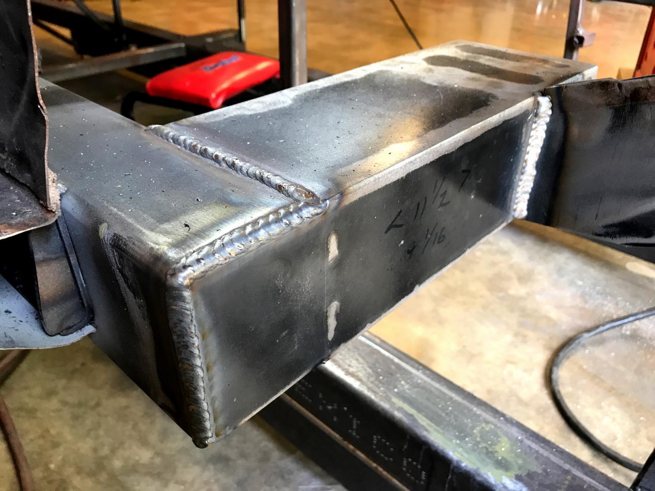

Fine fitting the top plates, which consumes a crapload of time to get the open corner welds set just right.
On the plus side, I'm finally getting a feel for welding these original 14ga rails. It's been challenging finding the right setting without bringing up the contaminants on the inside of the rail where there's still some old corrosion and (now) Eastwood primer. I broke the process into two, and have used it successfully several times now.
First pass with .045 wire.
Cover pass with 1/16
More to come. It should only get up to 105 today.
