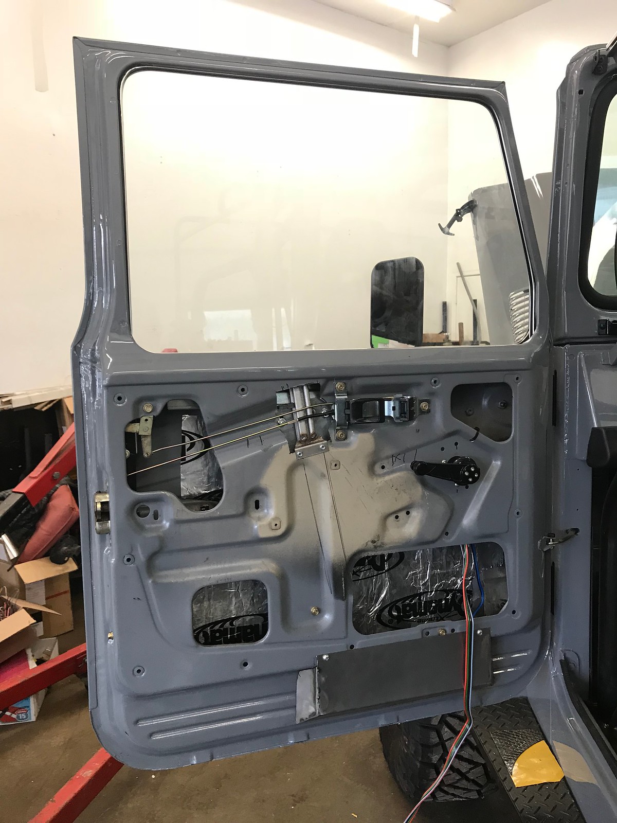

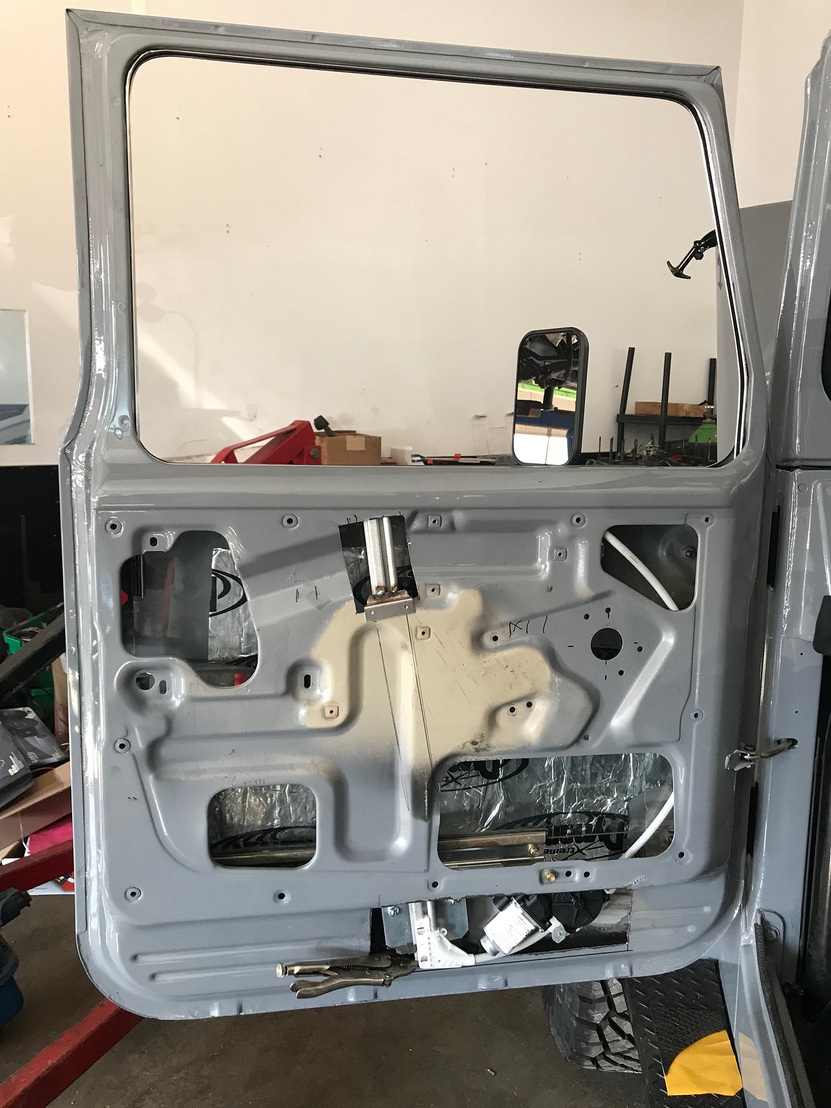

Jeff ... we were this close to going with the same, (SPAL system) but after talking to some folks that sold them they said if the windows or the cranking systems are sticky then they would be very slow and would eventually break. We took a chance and ordered up the Electric Life universal flat glass kit and somehow got it to fit. BUT, not without serious modification to the kit itself and to some of the interior door panel.
Had to cut open a section along the base of the door to house the motor and the lower portion of the track, then Fabbed up some enclosures that will get powder coated or covered ... yet to be determined
Cheers
Steve
IMG_9612 by Steve Heck, on Flickr
IMG_9625 by Steve Heck, on Flickr

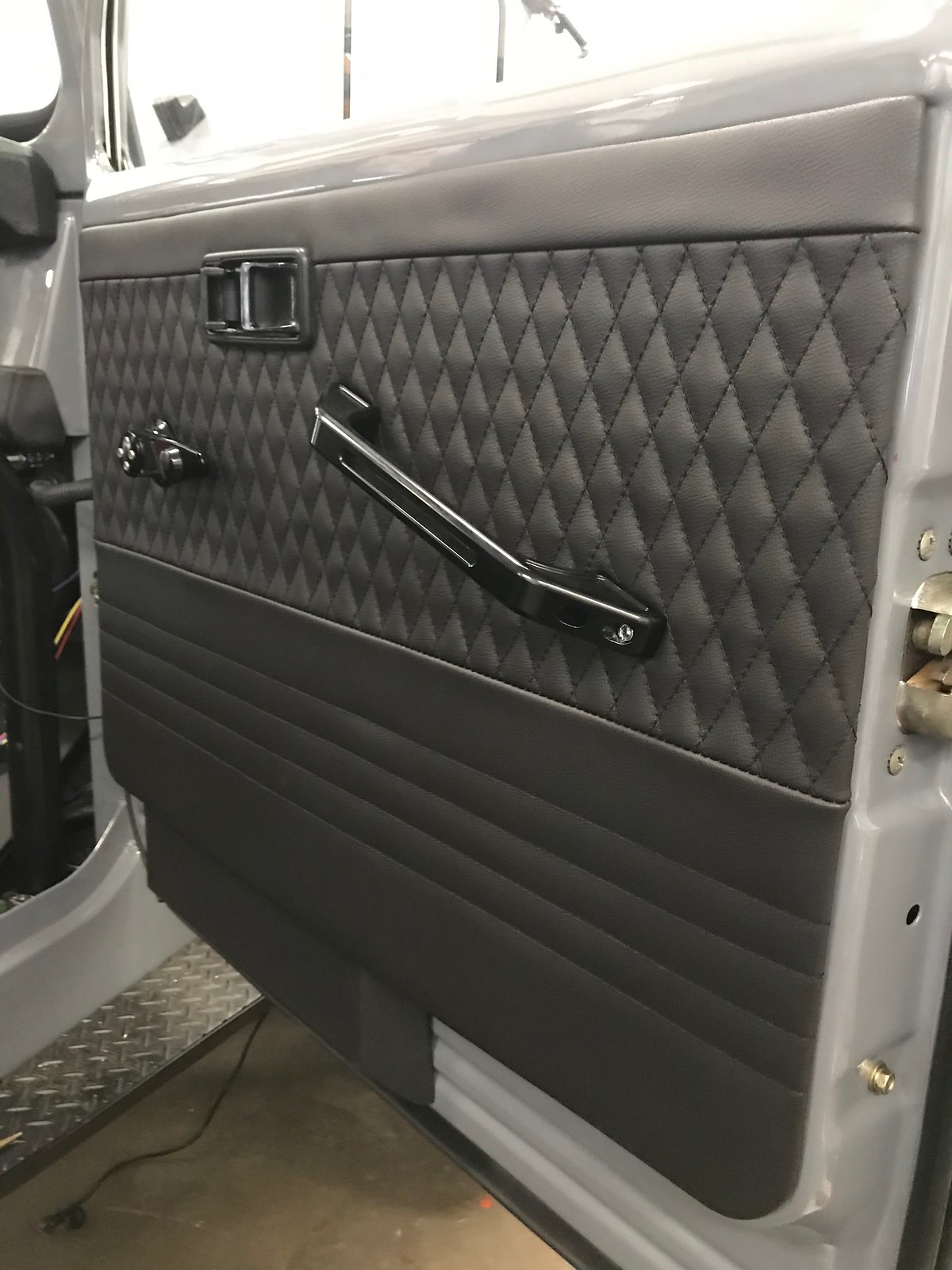

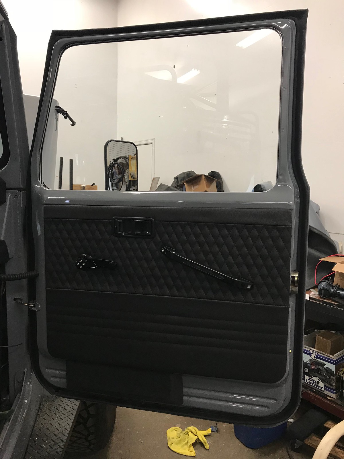

Ok ... Got the panels back from the interior shop today and finished one of the doors off. Very happy with the design, fit and finish that Harold came up with !!
Thanks Harold
IMG_9693 by Steve Heck, on Flickr
IMG_9699 by Steve Heck, on Flickr
IMG_9707 by Steve Heck, on Flickr
